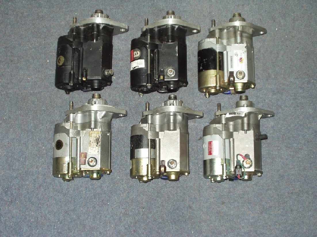

I'm trying to make a pre-engaged high torque starter.
Started with Toyota MR2 and Metro starters. Machined the ends to fit together which will be welded together.
Going to weld the pinion to the motor shaft unless anyone can suggest an alternative method.

The MR2 pinion is virtually idential tooth shape to the Mini inertia starter and is splined to fit on the shaft.
The pinions are too hard to machine. Luckily, the Metro pinion is fitted with a steel backed bush that I've machined to fit over the splined shaft.
Ideally there would be a Toyota pinion with the correct OD and number of teeth that would fit the splined shaft.

Rod, I thought the same thing a while back when the Twins were selling them, the real advantages are not from the increased torque but from being smaller, lighter & apparently they draw less current and are more reliable.
It's off a Toyota MR2, Mk1, I think.
The only reason for us using one is that the solenoid is on top making more room for for the front mounted rad and intercooler.

The large part of the starter, in line with the pinion, is actually the solenoid. The motor is the small part to the top and is geared something like 4:1.

Paul, The ones we have been modifying are no doubt the same as the one you have. The pinion on the starter works with the old 107 tooth ring gear, but not the verto 127 tooth ring gear. So you should not need to change the pinion. We have never seen a starter that matches the 127 ring gear and my mate who makes the starters has seen lots of different variants.

I'm using a verto flywheel with the 127 tooth ring gear so I need the smaller pinion from the Metro starter.
It does look like the standard pinion will fit the pre-verto ring gear.

Seriously, this has taken an age to do so far and I still do not know if it will work.
Machining back both the housings to mate together with very little to grip in the chuck means lots of very small cuts.

Just got 1 of these this morn, its exactly the same as urs bud. ive noticed ours are a little different from bens, how did you machine the starter?
In a lathe
