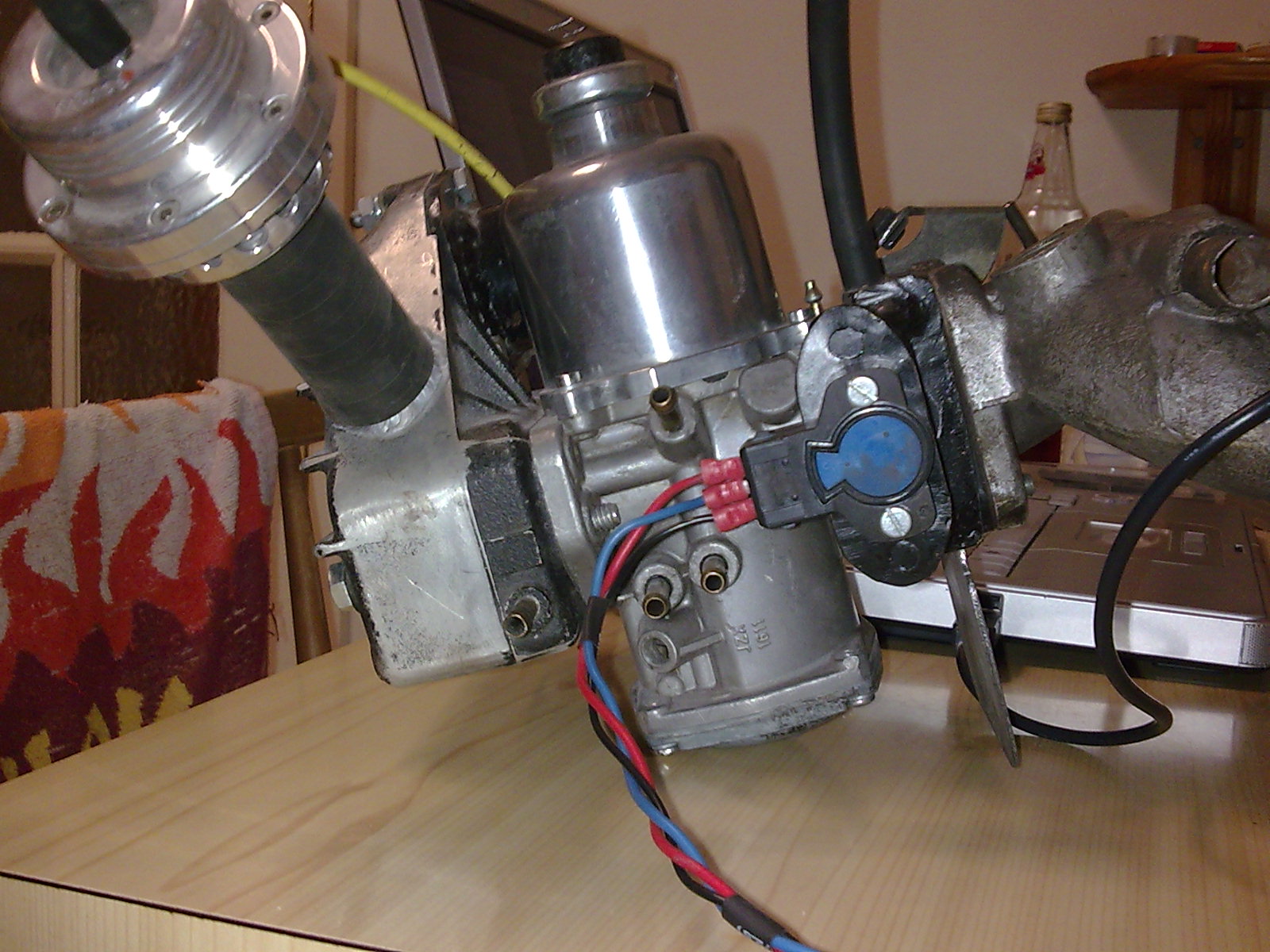

My TPS megajolt is on order and I need to start thinking about the Bracket and TPS sensor.
Has anyone got any pictures or diagrams that i can use on how to install, make up a bracket to sort it.
Also i don't really want to have to pay £60 for a TPS sensor, can you get them out of any cars at the scrap yard??
Thanks
Jon
As far as I know all TPS sensors work the same so you should be able to use any old one from the scrappy, I'm played with a couple of different ones no problem.
Here's another one I found:
http://www.lyons-it.co.uk/photo/mini/Mappe...19-1949_IMG.JPG
Edited by Rob H on 27th Jan, 2009.
