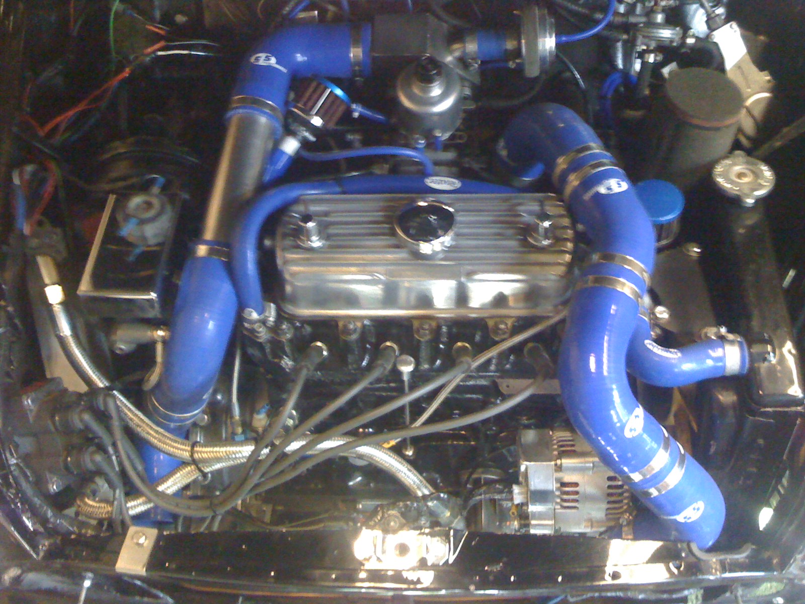

I'm doing exactly the same thing for exactly the same reason, and as apbellamy says, you should really get a new pedal box too (http://www.turbominis.co.uk/forums/index.php?p=vt&tid=252398). However, I'm going to try and get a bush sorted to adapt the later pedal box to suit the master cyl. puchrod hole Ø. Once I get my Mini back from the paintshop, that is (I'd hoped to get the brakes sorted before painting but this problem scuppered those plans)
You can just squeeze the intercooler pipes past the servo though, but it's really tight (in fact the problem I've got is fouling on the clutch res cap now!)

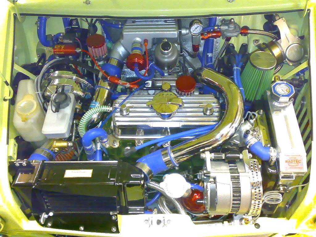

Green tag Type 4 M/Cyl and servo with late pedalbox plus Ford Series 2 RS Turbo slam panel mounted intercooler.
If I can get this lot in, so can you.
See Oct 08 Minimag for details.
Good luck.
Richard.
