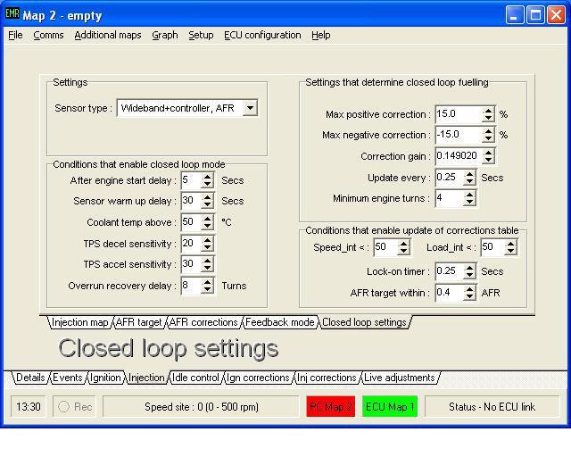

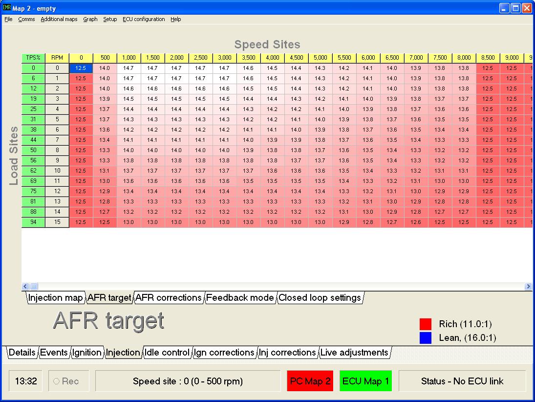

My Map is there, but since changing the intercooler a few years back it has always been very rich. I have since AFR around 10.2 when running over 2 bar boost, so I'm confident that if I run closed loop I'm not going to do damage (no more than running it in open loop anyway) I'm booked in for a mapping session on the 20th so this is just a short term tweak.
My Map is currently set to only adjust 15%
I've attached my setup screens
Anything I should change on here?
This is how it is currently?
On 6th Feb, 2009 Paul S said:
The Milton Keynes Map must rate as the most confusing in the world, so I'm not surprised.
The MK map definitely works best as a closed loop! *happy*
I would not rely on TPS for AFR closed loop on a boosted engine.
Having said that, the maximum adjustment it can make to your VE map is 15%. So if you are running 10.2:1 on open loop, then that map will reduce the fueling by 15% because the target is much higher.
15% less fueling on 10.2:1 will give......

Hi Jimster,
I am running 11.5 AFR on high load/high boost conditions. I would not go over 12,0:1 AFR on cond. like 5000+ rpm and full throttle.
I would also allow closed loop only when cruising....never on boost!
Why is your Map based on TPS% and RPM on a boosted engine???
If you want I can send you my target AFR Map next week....

The emerald uses rpm vs tps as a base map, it then scales this map in 3D with a separate pressure compensation table.
Works really well, as it self compensates for boost against the base map.

There should be no real reason to run bellow 0.85 lambda. You have the power to control both the fueling and the ignition more acurately than a carb and clockwork dizzy so there should be no need to overfuel past 0.85 lambda unless the engine has not been built to take the desired boost levels
I run closed loop at full throttle, as the rich and lean correction limits are set to 10% respectively, and the fact that the WBO2 controller is built in, the ECU knows when to ignore silly readings, which is more than can be said for any ECU that requires an external WBO2 controller *wink*
How oftenn do Lambda sensors die when they are controlled correctly and the engine is in good tune? Production cars and the same sensors run for years and tens of thousands of miles. Its hardly going to die within 3000 miles.
The DON is probably running Alpha-N with MAP multiplication due to the wild profile of the cams which would cause poor MAP signals in the lower RPMs so it uses a combination of both.
I did run closed loop for the shoot out, through the whole range, but we did keep an eye on the AFR with a second sensor just to check everything was as it should be, fueling did seem to be spot on. These are the settings I used
