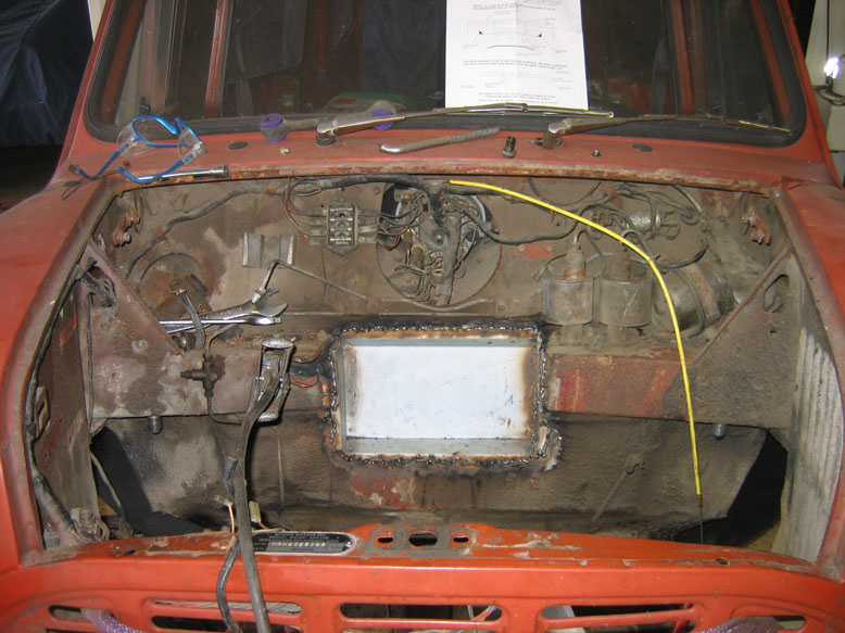

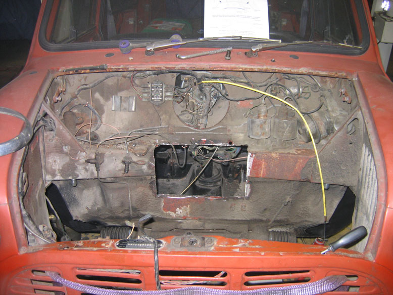

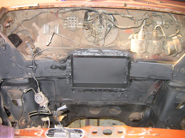

Yesterday I started cutting the bulkhead as per Jukka's pictures and the drawing I found on http://www.geocities.com/MotorCity/Downs/6626/eraturbo.htm. The car being LHD I can't use the standard (Minispares supplied) box, so I cut mine up. I used the RH section for about 27cm; then cut and welded the other side in situ to it; then used the supplied gusset plate to cover the whole that was left. I bent the throttle pedal so it's still usable*wink* The instructions with the MS box are useless btw, mentioning bolts which aren't supplied and all sorts of weird tricks, involving metal strips and subframes etc.: just throw them away and use common sense instead:)
Below are some pics of what mine turned out. Not an award winner I guess but you can hardly see it anyway after the engine's in. Tomorrow I'll trial drop the engine in. Problem is I'm on a schedule (hence the lack of detailing for now): by Friday the car has to be on all fours again and I'll be driving it 800m to France right after Easter...

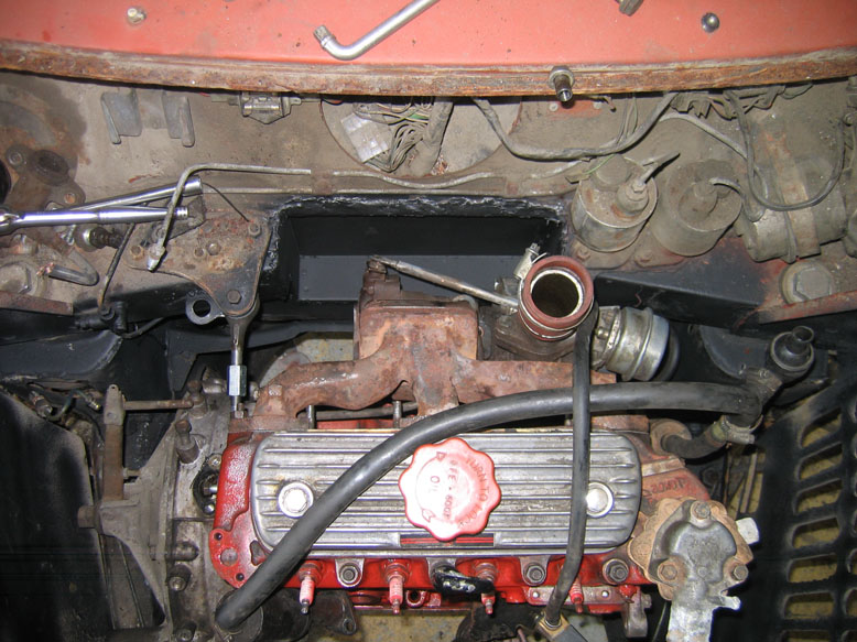

That's going to be tight on the inlet hose and actuator if using a T3. I guess you have no choice with LHD though.

You have to remove more sheet under the brake master cylinder for the actuator:

Mine's actually one whole cm wider than the standard ERA box and Jukka's too; I'm even closer to the throtle pedal. It was a PITA to cut the blukhead out, since I managed to that right where some support brackets are on the cabin side. Hopefully tonight I'll be able to report if it clears or not, but I'm reasonably confident..*happy*

oops, that's new to me... how much? Didn't ERA use a longer upper engine steady to sort this?

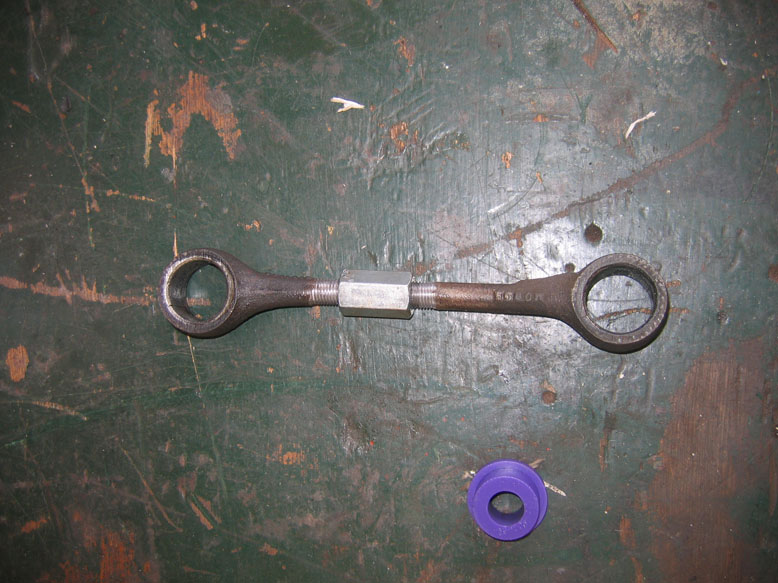

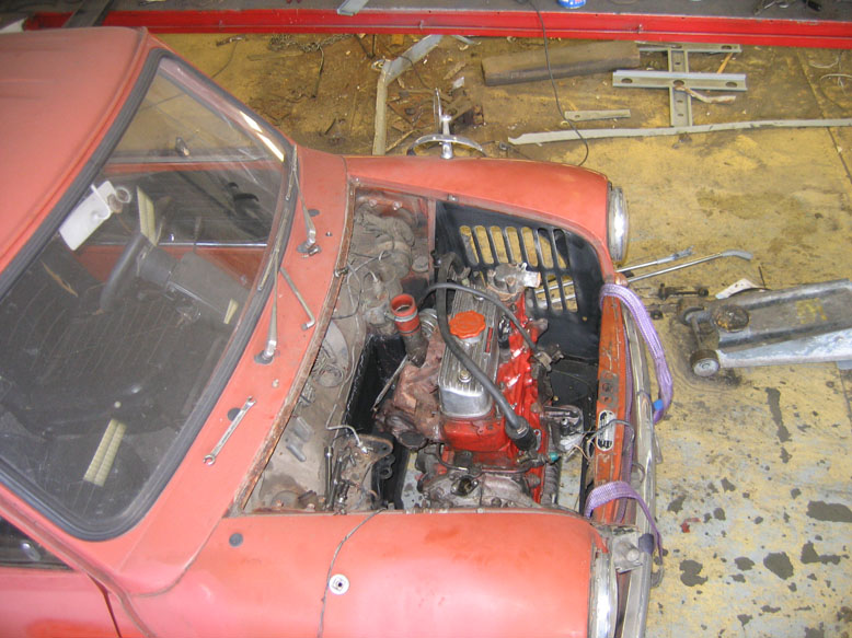

Today was the day: I bolted some mounts to the engine, then dropped the lot in the car. The waste gate actuator hit the bulkhead, but only lightly, so we decided to cut, tap and lengthen the upper engine steady (see pic; yes, a locknut has been added since*wink*. Now there's 1cm (3/8") clearence, which is plenty. The engine will be held down with three steadies in all: the top one and two at the bottom (it's got a '91 subframe and I'll use the '76 back steady as well. I put some extra welds on the bulkhead bracket for the top steady as well.
Tomorrow I'll put the engine together and drop it in permanently. All in all I'm pretty pleased with the result sofar, although we're not there yet*wink*
