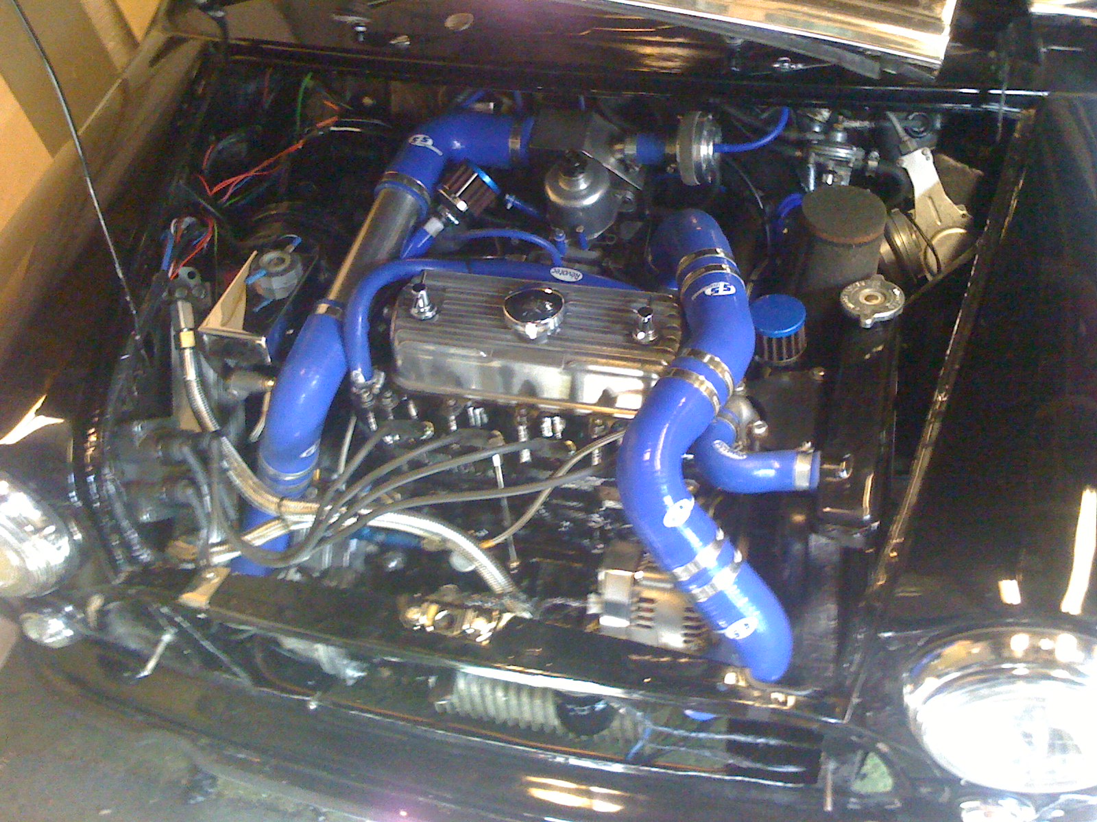

hi could someone upload a pic of their oil feed from the front of their engine to the turbo,
cheers
Welcome to TM
Not the best pic I know, but it's in there somewhere. It's the pipe that goes between plug leads 1 & 2.
What exactly do you need to know?
Edited by theoneeyedlizard on 23rd Apr, 2009.
Found a better one

Same set up as mine same routing. Got it from minispares I think or was it beechgrove engineering
Own the day
ministef1
730 Posts
Member #: 1791
Cranleigh, surrey
looks like the standard goodrich one to me. Great apart from they fall apart. the aluminium part is the wrong size and so is the banjo bolt. just don't do it up to tight!
"Cars are a lifetime of pain"
Go to your local Pipe Firm, Pirtek Ect and tell them what you want, mine cost £29 all braided fittings!
Spot on.
