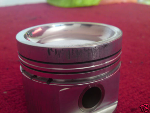

seen pistons second hand are they any good with this damage I am unsure?

These are on ebay aren't they. Seller says that they are £400 and something from avonbar. True, but you can buy these brand new with pins and rings from Accralite direct. They are part of the listers company and are located in Smethwick not far from Mini spares midlands. I know this as I brought a set from there around 2 months ago for £379. They are excellent quality. Just be aware not to go mad with the bidding. You could get new rings for them from accralite as they'll sell them seperatly as well. :)

yeah found them on ebay, how much is a set of rings likely to set me back and what do you think is a reasnoble price for the pistons

I don't know how much a set of rings would be but this is the number for accralite (0)121 525 6450. All they would need is the code on the underside of the piston and they'll usually have em in stock to send out. Regarding price on ebay I'd go to around the £200 mark.

Now all the place is aware ,these will certainly brake the good deal limit.
whatever I would let these :
these def have seen enough det to ruin the bores in few milage, what about piston strengh now, at least goosed ring land?
they have been polished: why appart for the ebay shit?
Make yourself a present , stay away from these ebay rob. You'll definitely loose money and time, you'll safer to buy a new set with the correct pin, rings etc new in the box.
buy new DIRECT! from accralite like the guys say
