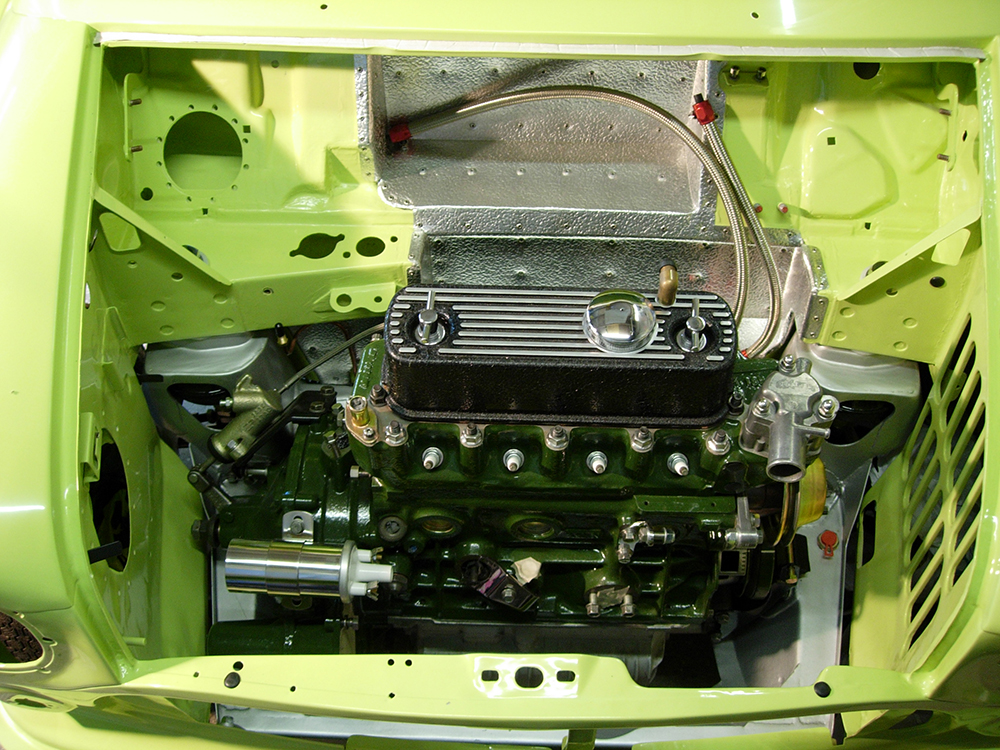

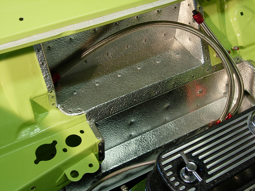

Or you could just weld on a 3 inch extension to the standard Avonbar bulkhead box as I did so that it didn't matter what dia actuator you could use.
Gives me about 1.5 inch of clearance all round.
Couple of build pics attached.
Richard.

What is the heat insulation (reflective) material you used to line the two boxes and is there another layer of something else behind it ???
Rod.
Is the box riveted or just the insulation?

Rod / Vegard.
I don't believe in riveting something like this - you're asking for trouble with structural strength and I believe in doing things properly, especially when it's for myself.
The box is seam welded then strengthened on the back with a backing plate, then welded again to add back alot of stiffness.
I made up a three inch extension to the standard Avonbar box by cutting the end off it and inserting a tailored section then welding this lot back up again.
It means I had to weld in a new take-off for the new RH engine steady (when viewed from the front) and so I used three 5/16 UNF studs, welded into 6 mm plate about 4"x2" to spread the load, then seam welded this lot to the bulkhead alongside where the wiper motor sits. It's a bit overkill really but I recall a mate managed to rip his out of the cross member and I didn't fancy that happening to me. You can see the studs in the photo's above. Has worked a treat for me as it takes a standard adjustable Minispares RH engine steady.
Once welded into position, I then lagged the complete engine bay side of the turbo box (and also the Weber box) with 8mm fireproof aluminised reflective glass sandwhich , sticky back one side, ali foil the other - I conveniently acquired this from a well known Gas Turbine manufacturer for a few beers. We use it in the Navy with our marine GTs. Still have a 30 x 30 sheet of the stuff which I use when doing plumbing as it makes a great heat shield whilst soldering copper joints.
This lot is then covered in thin (1 mm) dimpled Ali sheet which you can buy from B&Q. It's pop rivetted with st.steel rivets through the lagging material into the box. The rivets come through into the drivers dash area where each is sealed off with Sikaflex 221. I didn't want any fuel leaking through the rivet heads.
The ali sheet is alot more durable as a surface than the foil covered sticky heat reflective stuff and guards against damage if snagging with a spanner doing the bloody exhaust clamp and other crap down the back of the bay.
Hope this helps.
Richard.
