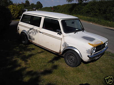

Well this is my new daily driver, i say new had it just over a month, its all taxed and mot'd.... bargain!
Body wise its solid. Apart from the fact it needs a new rear valance, but thats it! not bad for a 31 year old mota!
Plans are to fit the arches i brought off robert, a paint job, which im doing this week, slap on some cooper s brakes to get rid of the dodgy drums lol, going to pop in some nice comfy recaro seats for the long journey's.
Oh and i'll also be saving for some spectrums (if i can get them) or force racing wheels........
Then once its MOT'd and taxed in august, the turbo charging will begin.
Can't decie whether to do a 1098 turbo, or 1293? Decisions Decisions.
Not going to be some high powered monster like some of you have... more of wanting that little extra power for some fun now and again.... id be happy with around 120bhp!

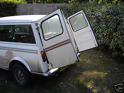

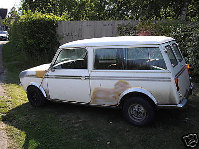

Here's some snaps for you when i got it.

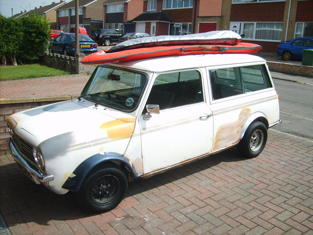

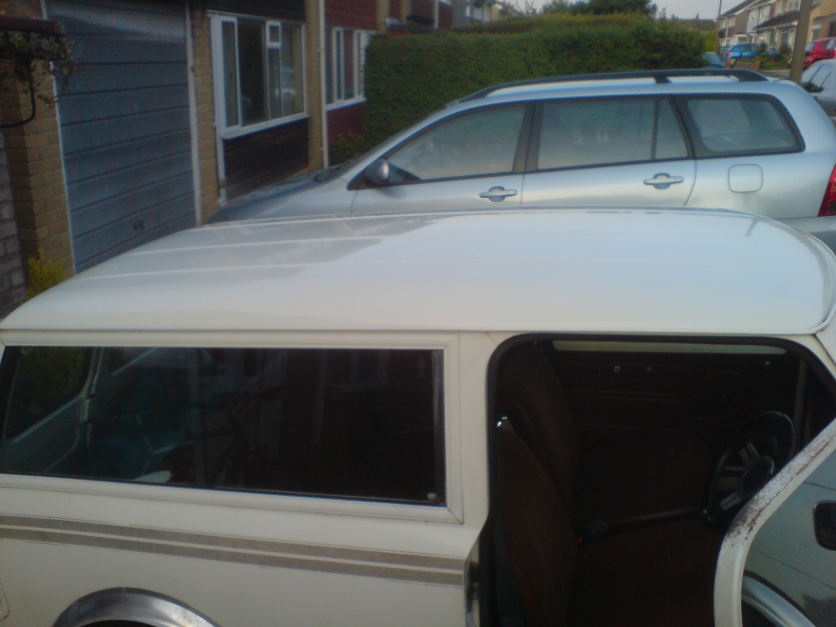

The roof after i gave it a polish up! Not too shabby.
And with one arch modified slightly and lined up, with the old surfboards on the roof.... (hence my old username being mini_SURFari lol)

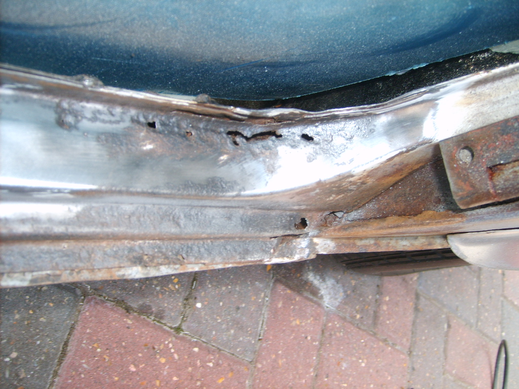

Well this morning i decided to go through it, see what bodywork needed doing before i gave it a lick of paint....
and all i found was these few pin holes on the door step... so i cut it out and put a plate in their.
Slipped with the bastard grinder as well!
To be fair, it would have been best to replace the door step (would look a little better), but as its a daily driver im not trying to get it mint..... and after i've finished restoring my mk1, which is ment to be a concours car, this will be getting fully restored, so aslong it make it to next years MOT, ill be happy.

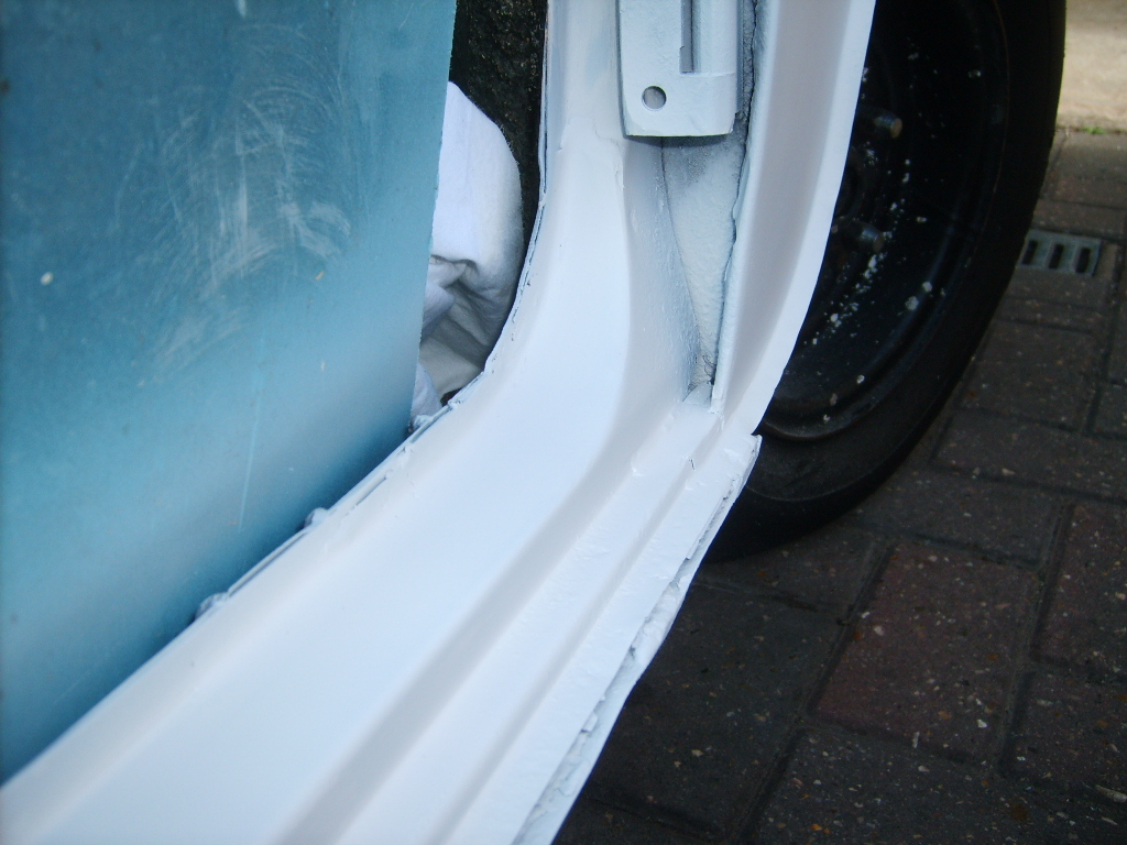

Well i went out this afternoon and primed the door step. Ready for some top coat tomorow.

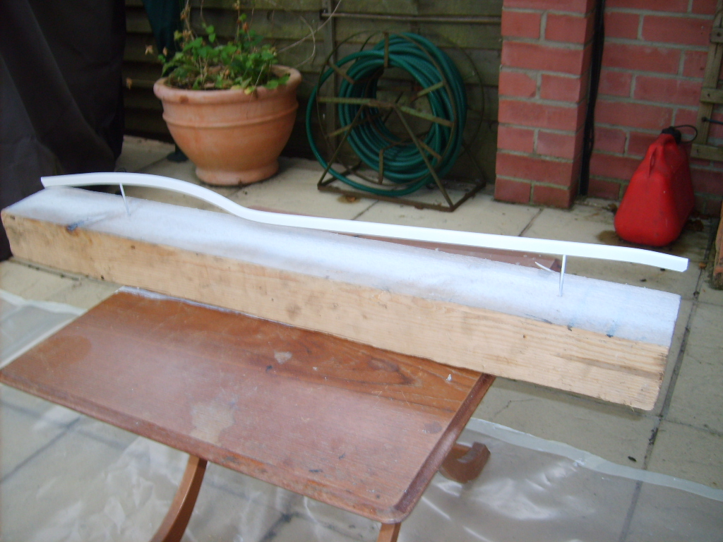

Rubbed down the seam strips, and primed them.

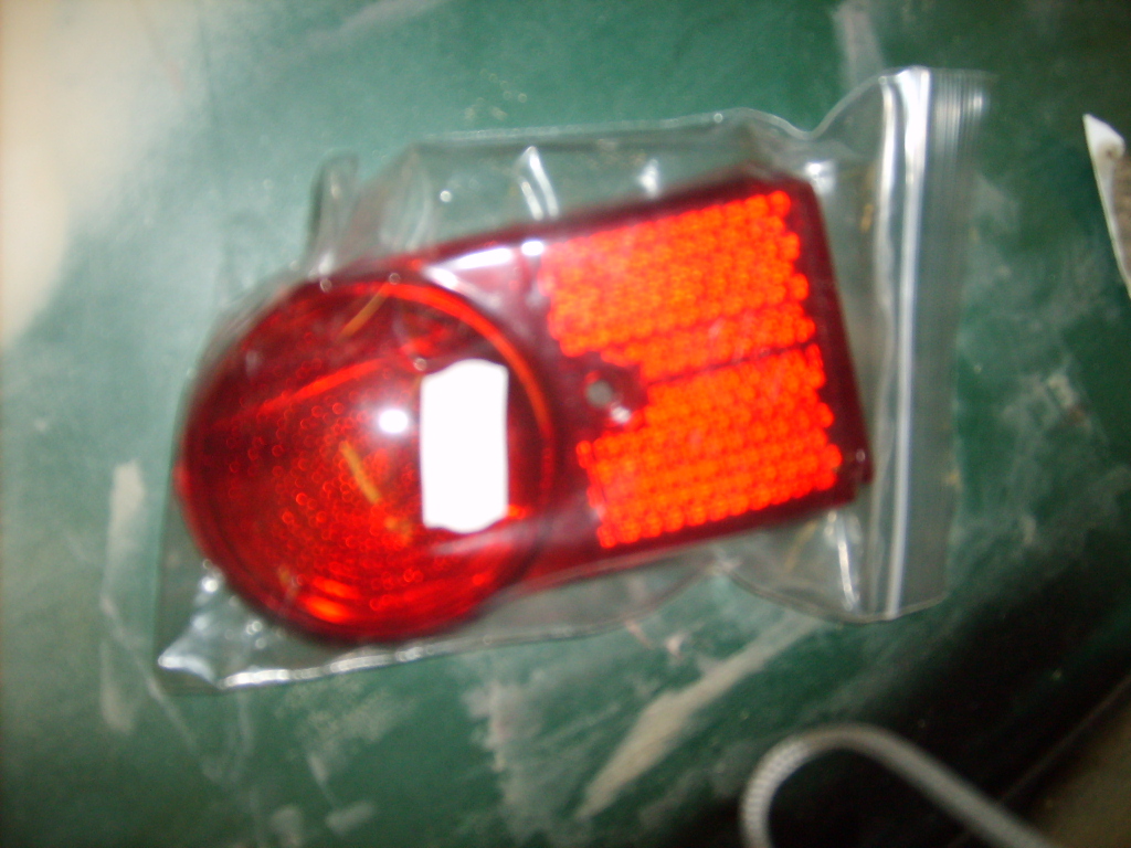

And i went and brought a new rear lense, as one of the little shits round where i live smashed one with a football.
