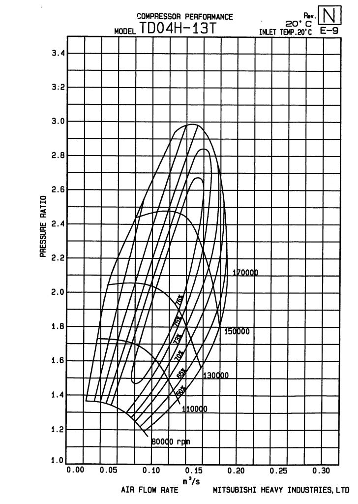

Well from my limited compressor map reading ablities it looks like it could work quite well. Dunno if you would get more than 20 psi out of it but thats enough for me. Comments welcome
EDIT : No idea why the pic is so small ? Any idea how to make it visable.
EDIT 2 : Sorted it linked the tumbnail pic instead of the proper one.

Yes, interesting isn't it.
i have couple of these knocking about too, a 13t, a 15t and a 16t off various volvo T5's, shame theyre all shagged!
Around 73% efficient at 25psi and 7000rpm...
Thats quite close to the top line though. Although thats resonably high reving.

be carefull, this the 56mm sub 13t compressor map, not the small 52mm 13t volvo2.0t g /bmw 525diesel one.
