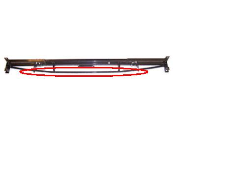

Does anyone know what the function of the part is (circled in red)? Im not sure if it adds rigidity at all, but most other beams don't seem to have it. I was thinking of chopping it off to save more weight? https://www.facebook.com/pages/Fusion-Fabri..._homepage_panel

it's purpose appears to be to make your exhausrt hang down lower than a snakes weddinbg tackle and look a right twat, but as iv'e no sympathy for you matty[sorry] you got just what you paid for,

Nic told me about the exhaust problems, and I thought that rather than modifying it, I may aswell chop it off! I got it cheap second hand too. Lol

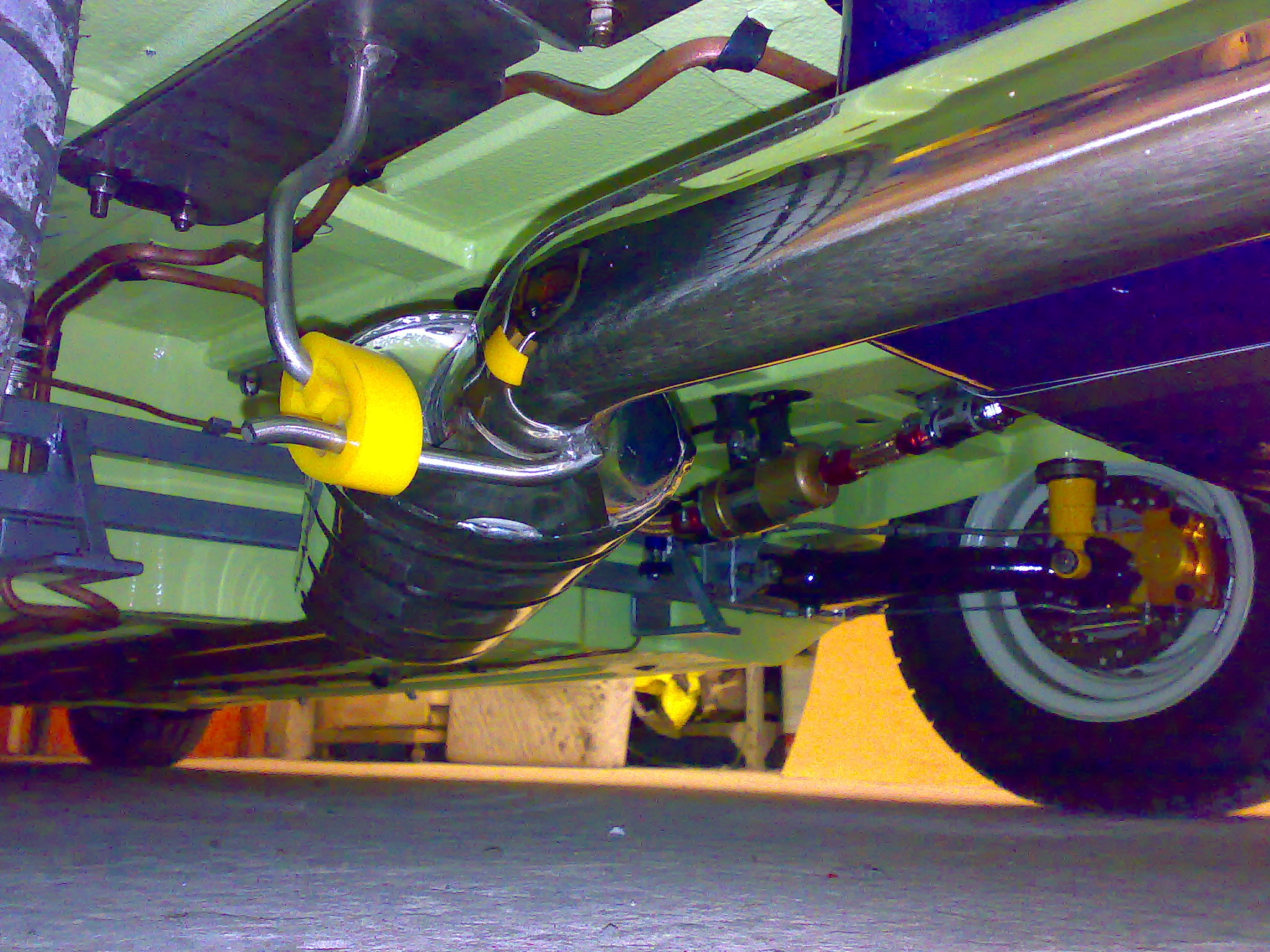

i fitted one of these YEARS ago for some one,

Make your own - I had a speedex type beam on my old shell. Fortunately I bent it like a banana when I crashed at Goodwood as this was the best thing that could have happened to it as it flexed like a pole dancer! On 5th Sep, 2011 Vegard said:

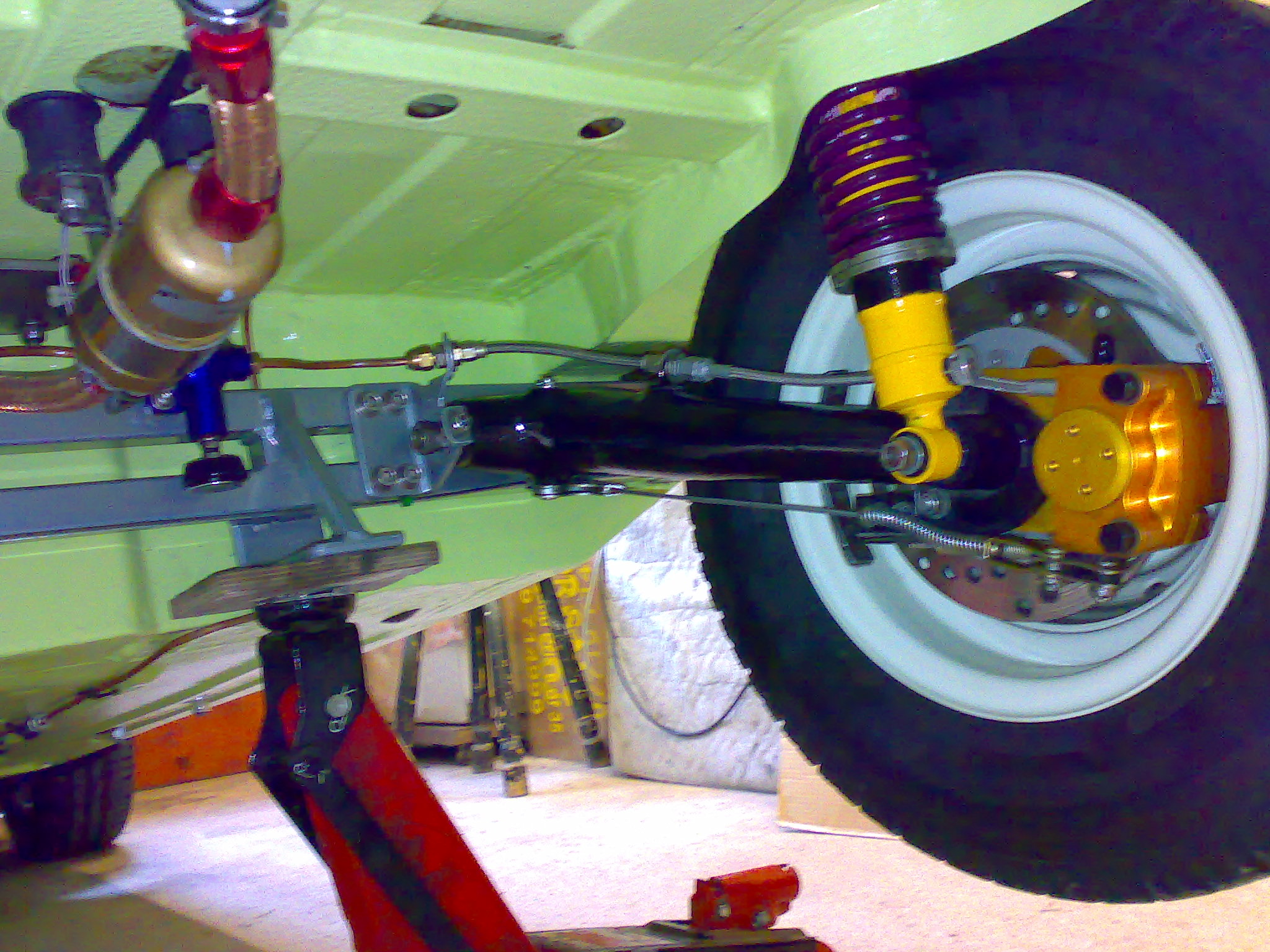

as above on making room for a zorst pipe - thats not the worst part. The part you really need to tackle are the brackets which hold the trail arms on. As supplied they are simple "L" section brackets which offer as much support to cornering forces as a wet cornflakes box - they need bracing across the open ends of the "L"to rectify, from memory this is the top of the bracket as the trail arm is in the road of the other end.

Cheers Carl -good pic of what needs doing to the steel beam If Carling made Mini engines
