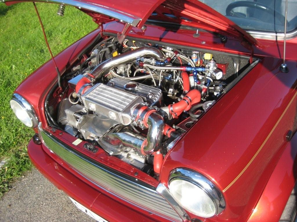

In the summer of 2008 I got it in my head to do a completely different version of a superchargered Mini.
This resulted in using the following parts to acheve perfection.
Well pistons are from Avonbar and diss are self made by Ian Hargreaves 15cc Accralite, 73,50mm bore. The Piston compression ratio is 9.13:1
The head was fully modified with new race steel valves, inlet 35,7mm, exhaust 31mm with bronze valve guides. The valve seats have being changed so I can use unleaded fuel.
The camshaft is a Piper billet 285 scatter.
The rockers are full roller hi-lift 1.5 ratio.
Crank is from MED engineering with a 82,3mm stroke latest specs, Re-ground, Ni – Tempered, Crossdrilled, Wedged, Bladed & Backdrill. I used a 82,3mm stroke crank because I wanted 20cc more capacity compared to normally used 1380cc engine and that’s why it how has a capacity of 1399cc
Cooper S lightened con rods from MED engineering and a Finn turbo cooler.
I have also added a 60hp Nitrous system.
An Eaton M45 supercharger and at the moment I use only 0,8bar/11,6psi boost. (I have now too small fuel line so can't use 1bar boost)
I also added a cylinder head gasket from Cometic high pressure gasket, which is able to handle a high compression ratio and boost without any problems.
Ultra light flywheel and backplate from Mini Spares
I use a Haltec ecu and I have a Jenvey throttle body whit 2 injectors.
The radiator is made in Finland and it is a 3-core system and it is almost in its original position.
I have mounted a second radiator under the right wing for extra cooling and I found it from a Derbi motor cycle and it fits well into the wing

Have you measured the cylinders individually for AFR distribution or just out the tail pipe? And how did you adjust injection timing?
Jean
Hi Jean.
No individually I have wideband lambda in tail pipe.
Well how to start...
You can adjust almost everything in every rmp and load area.
( for example in where boost and rmp and throttele position you want the N2O is in game)
I doing lot of driving aroun cirkle road and thats how get it close to final situation.
Rest adjusting job I do my mates dyno.
Here is website where to find more information for Haltech. http://www.haltech.com

i dont get the intercooler set up tho mate?

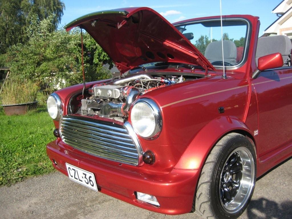

Hi Carl.
Yes I have got many question for that intercooler position.
If you look closely for those images you can see that aluminium ramp which lead air through the cooler. Bonnet hole is just right position to help air flow through cooler, you can see also that from images, there you can see that aluminium ramp and some plug wire.
Whit that cooler I get 40 degrees lower intake temperatures as whitout that cooler.
Jani

Lovely job, interesting injection setup, be nice to know how evenly spreas you fuelling is across the shared ports.
Before upping the boost check out this thread http://www.turbominis.co.uk/forums/index.php?p=vt&tid=312408 I think you'll be at the useful limit of the M45 cwhere you are
Hi Wil.
I have not eaven a clue how equally it goes in to the inlet manifold..... :$ *surprised*
But seems to working quite OK..*happy*
Power limit.... yes now it this kind situation when I have about 5600rmp fuel pressure start come down and it goes to lean.
That happen after to changing pulley. Now I have 19%pulley there and standars size mpi crank pulley.
When I have 15% there was no problem at all. *surprised*
Now I have about 15hp more in 5500 rmp area than when I have that 15% pulley...
Jani
