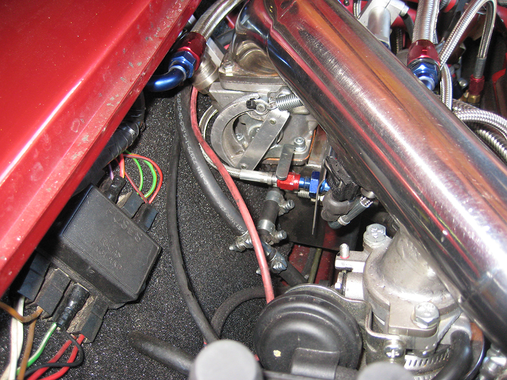

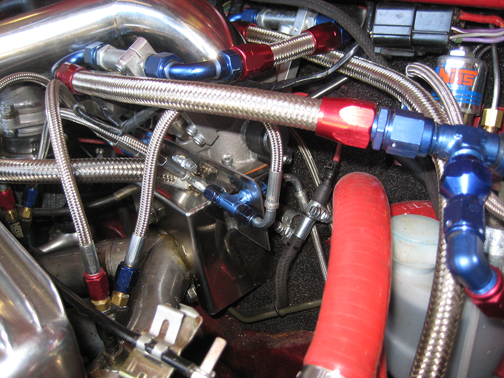

nuukuus
161 Posts
Member #: 6857
Lieto / Finland
Hi Johnny and Prawn.
I think these help both of you..
http://www.youtube.com/user/nuukuus
I take that video just when I got it running... *Yes*
And some extra images also. Here you have.
There you can see where from I take that pipe how to adjust that valve. After throotle body.
Jani
