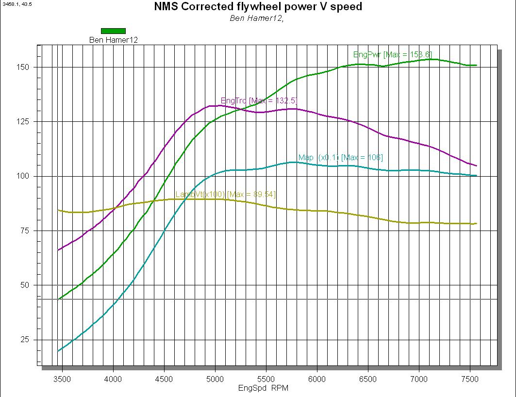

After a slightly disappointing shoot out it was time to put the TT2 back on the rollers today. So it was off to NMS with as bleed valve and a MBC. To cut a long story short we managed to get it back to 15psi and 150+ bananas. Unfortunately we were unable to get any more boost. We suspect that the actuator was not strong enough to keep the wastegate shut or the bracket it is attached to is flexing. Anyway it was good to see 150 again and a bit of an investigation in the next few months should diagnose the problem and we will try again for 20psi. Here is a printout of the last run @ 15psi.

Great result, more power per boost than my 1293! Not that mine was very happy at the shootout.
what revs did the engine go to? 9K?
big respect to you buddy. It wasn't too many years ago we were getting that power on the same boost but from a 1293 engine. Top job lads
Axel and I attended this event. Apart from the very good power output, I was impressed with the reliability. They did 12 power runs, most in the 150-155hp range and that engine did not miss a beat.
Pity we could not get the boost higher than 15 psi. I'm sure that there is at least 180 hp there.
Whoever said 998s could not be turbocharged should eat their hat.

It was revving to about 7700. On the shoot out day the rev limiter was set to 7200 at which point it retarded the ignition to 5deg advanced. Hence why the power dropped off. This time it was set to 8k, but with no intention of getting there.

On full boost it runs 24deg advanced. As far as I know the actual fugure and the set figure are matched. cr is 8.5:1.
If you want the electronic copy let me know. I was very impressed that about 3.5 to 4psi increase in boost achieved a 25bhp increase.

To be honest we thought that 24 deg was quite conservative.
Here is the last run we did.
http://www.twin-turbo.co.uk/TT2/Ben%20Hamer12.sfd
