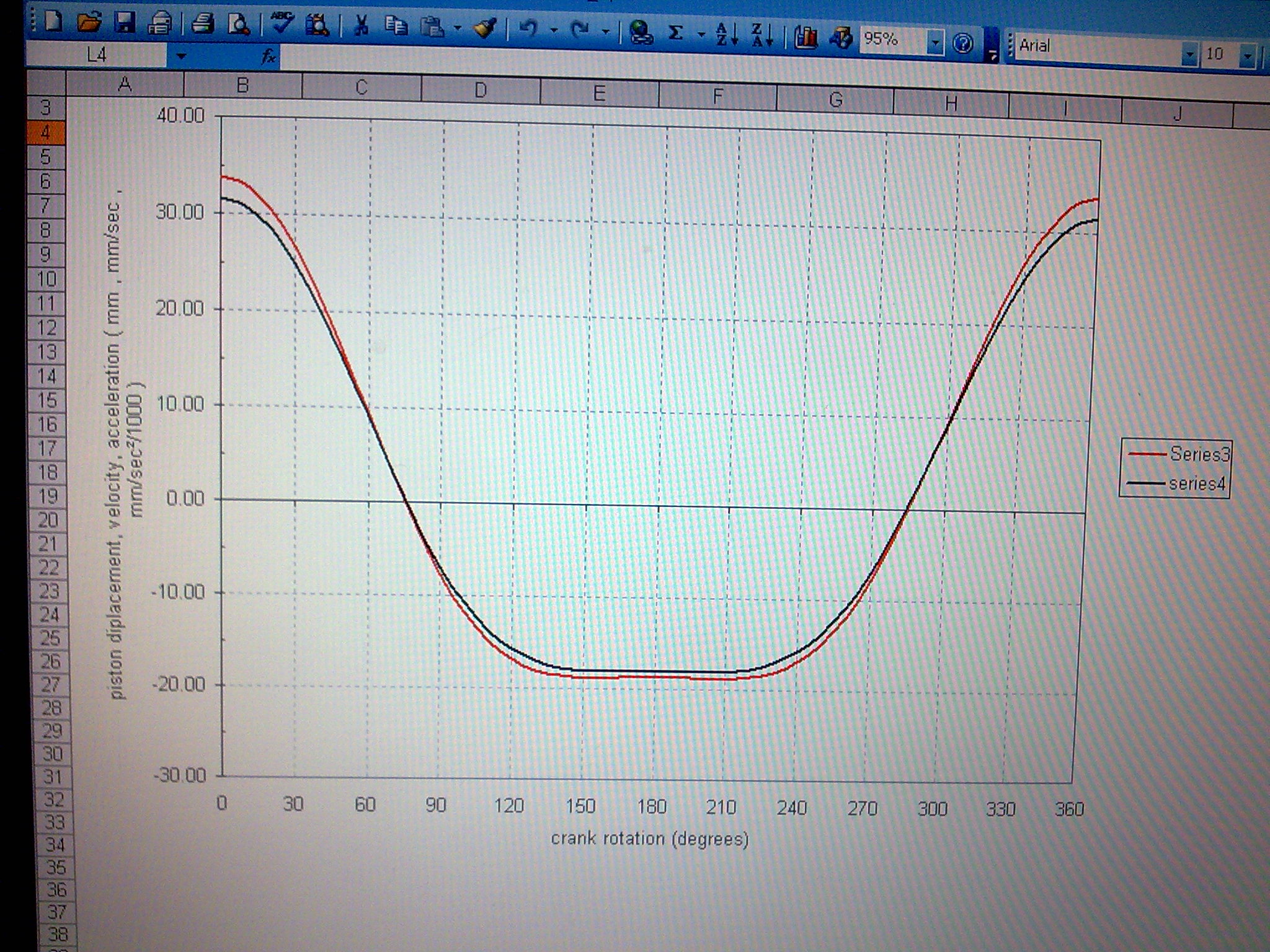

I see your thinking - just don't rev her captain - fingers crossed you get 140 before 7500! I've attached a graph to show piston accel v crank angle for a std stroke 1275 and an 86mm stroke crank - notice the extra accel of the pistons. The really interesting part is the section between 150degs and 210degs, where due to the length relationship between rod and crank the piston actually slows down then speeds up again - non of which is good for engine smoothness or life.

thanks for that John very very interesting any chance you can E-mail a bigger version of that as I cant seem to get that any bigger :)

hehe - I seem to be having trouble posting "large" files?
I'm sure I've got your email - I'll send it over with some other interesting stuff!
