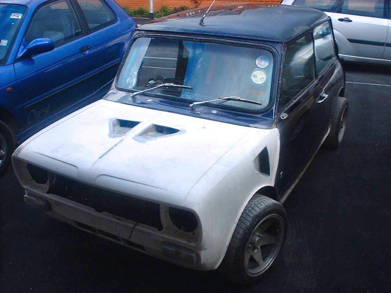

Since I flip-fronted my Clubman front I can't really offer much other than an old pic of what I cut out - essentially enough space for headlights, leaving the vertical bit between headlight and grille, then cut out the entire grille area;
Apologies for a rather rubbish angle on the pic!
Leaving the "inboard verticals" made it easy to mount the grill with a few 90ยบ plates too, then simply screw the headlight surrounds to the grille and a couple more bkts at the sides to finish.
