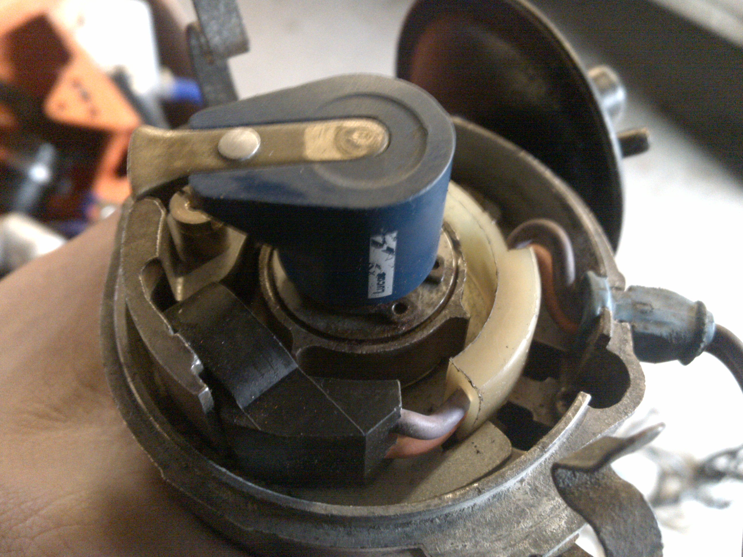

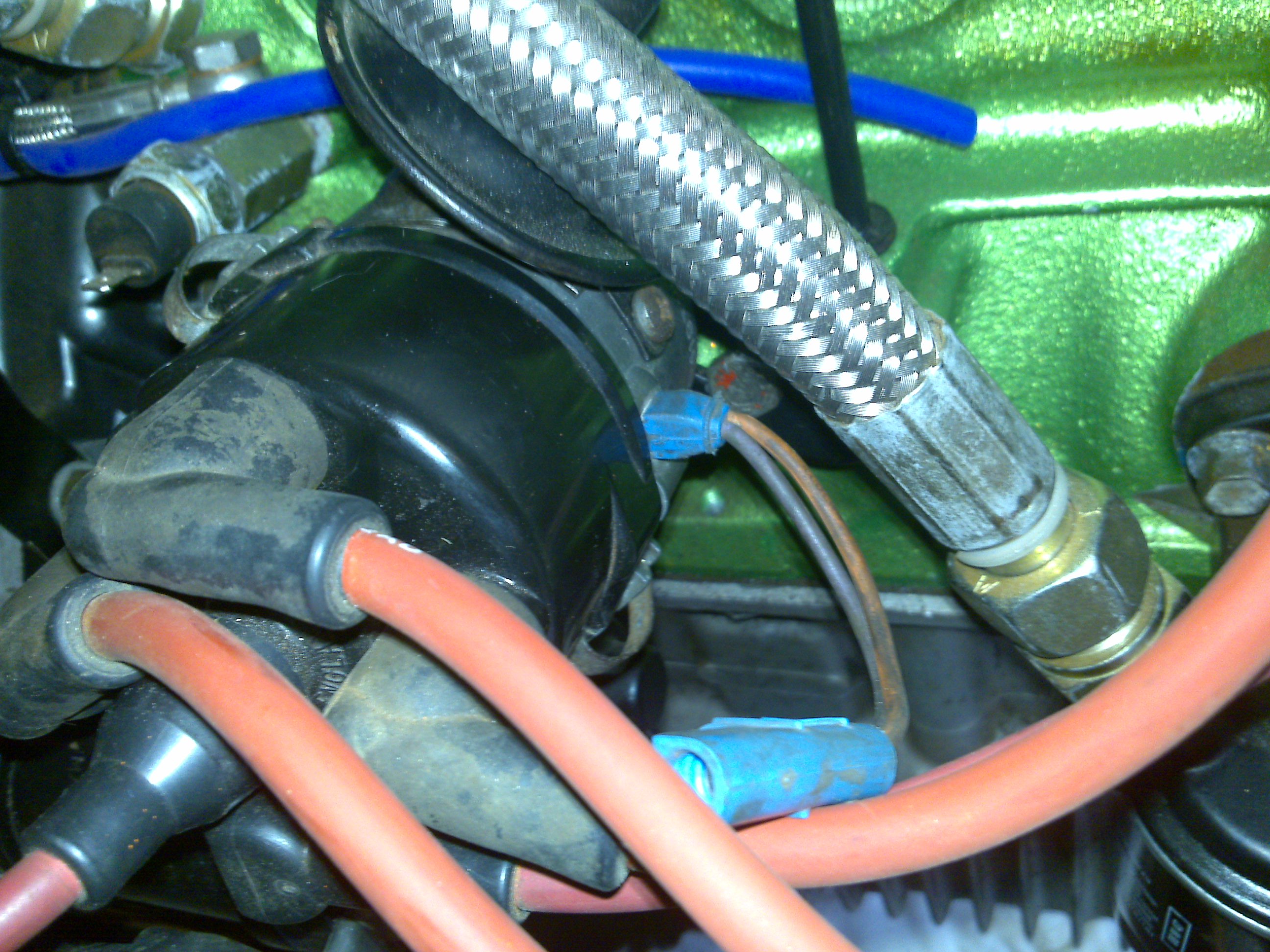

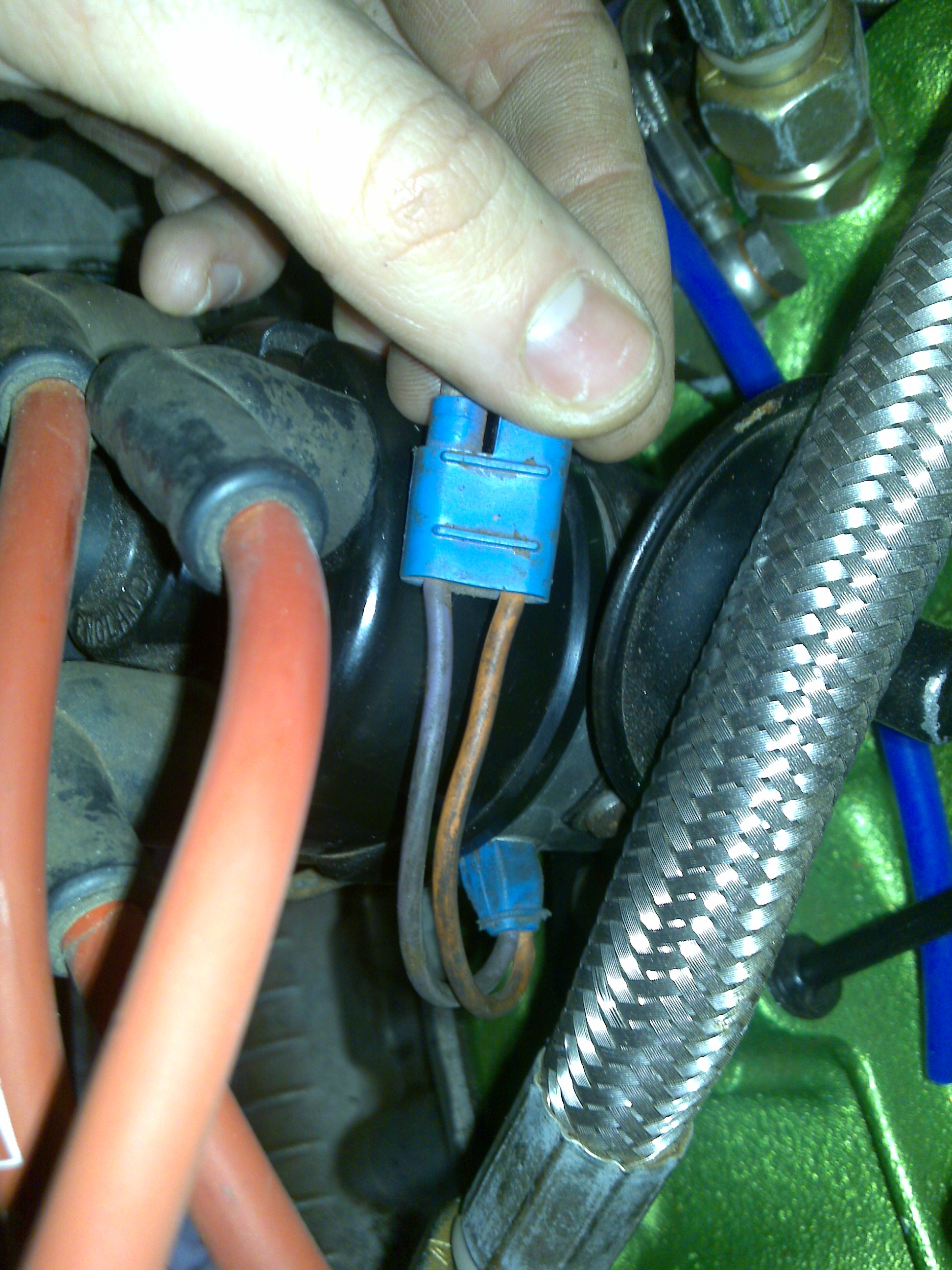

Im stumped can anyone help? i have built my first new engine and im ready to wire the coil etc etc but i am having troublea. I have read up on here, haynes etc but all the colours for the dizzy described are different to what i have!
I have purple and orange any ideas what poss and whats neg? also can you guys tell me anymore about this dizzy does this need a resister box or does this have one built in?.
Sorry for the ignorance.
ps. there are no markings on the dizzy or plug end.
cheers.
The dizzy part number is vissible in the first pick, near the dizzy clamp. post that up.
looks suspicioucly like an early metro ducelior (or however you spell it) dizzy.
what spec is your engine? smal/large bore? Turbo or n/a? I'm guessing A+ due to the dizzy clamp
EDIT: Just noticed the turbo oil feed in the first pick :$
Probably the wrong dizzy

must be a really early metro turbo engine you have. before the ellectronic stuff. pop the cap off and have a look where the wires run to. if it just has a condensor and points then you can follow the wires back and wire as a normal points dizzy.
EDIT: That said, a points dizzy only has one wire going into it. Might have an aftermarket ignition module in it

dont think so, pretty sure its electronic as there is no condensor! im thinking maybe something has been changed on the dizzy in the past?
pop the cap of and put a pic up
That is a Mk1 turbo dizzy that uses a seperate ignition module. As opposed to the later type that has the module mounted on the side of the dizzy itself.

pic with the cap off.

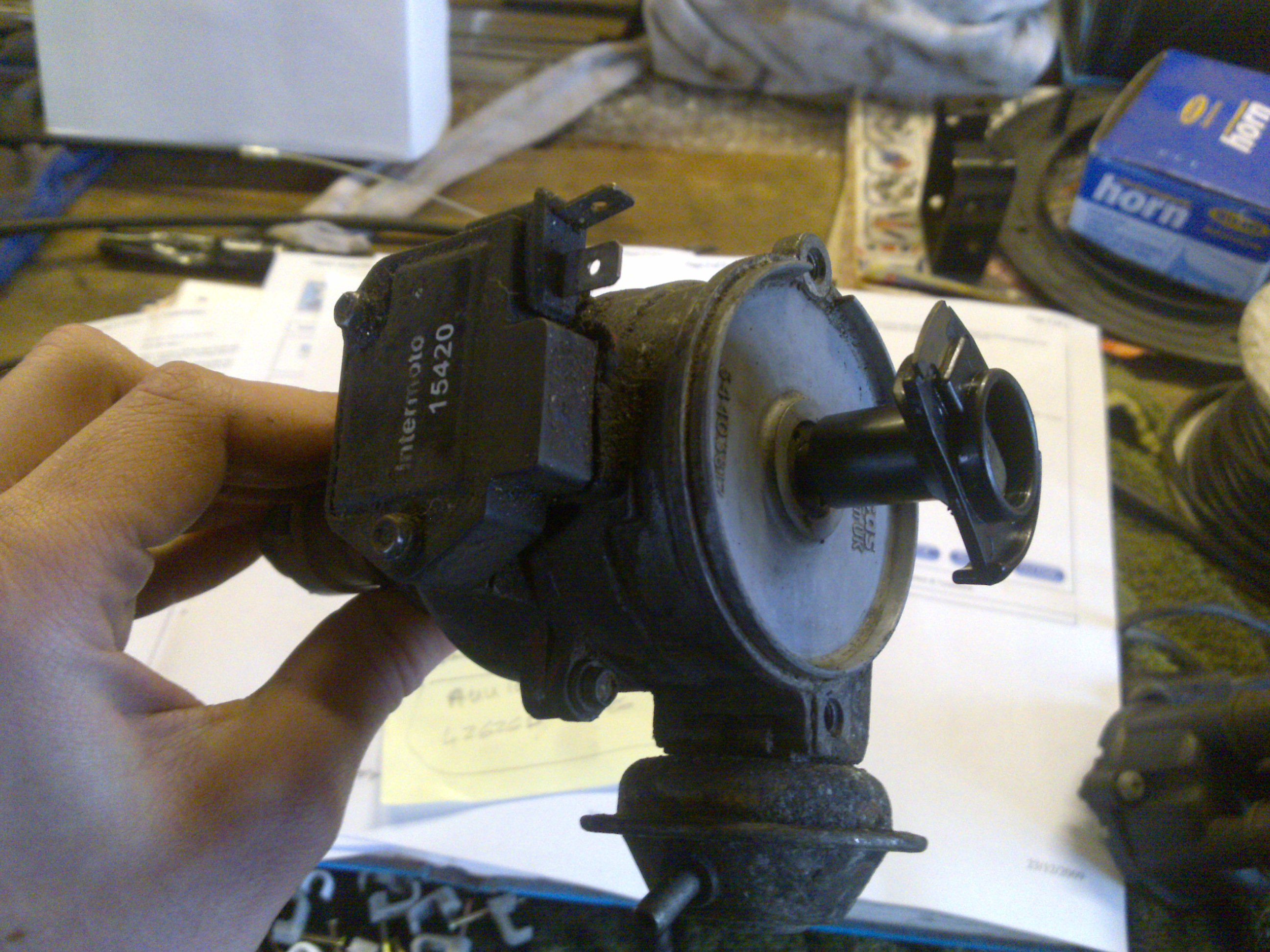

i also have this other old dizzy is this anygood to use numbers are.
auu1082 2001
42626d 2686

left pic being the first dizzy
As TOm says, the first dizzy needs the external module.
Is the second one from a turbo??

The second one i know nothing about think its off a standard1275 mini.
Your problem is getting hold of the module.
Finding a later dizzy or fitting a megajolt would be your best bet. The advance curve on the standard dizzy will be wrong for the turbo engine

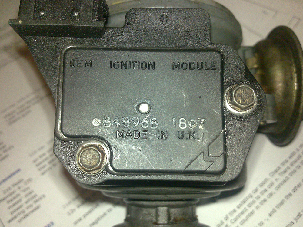

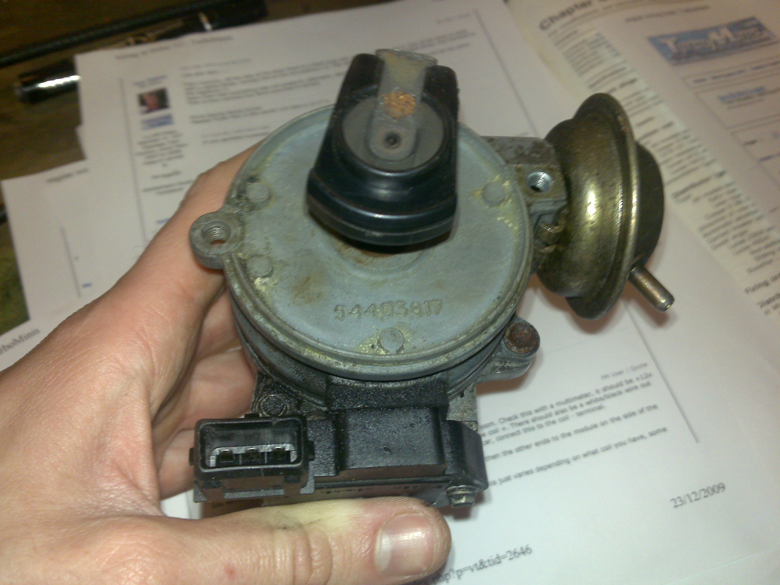

Right more problems! i now have bought another dizzy off ebay which is ment to be a turbo one aswell but i am unsure. The plug on the box on the side of the dizzy has three pin connections and from what i have read on here there should only be two? anyone know anymore on this?.

on my old dizzy it had the 3 pin plug and i changed my module for a 2 pin one with then i put 2 spade connectors on then went to my coil
Three pin plug/socket were the later modules - but only two of the pins are used as the way they are wired up for the Metro (so mini) coil is the same.
On one of the "other" forums is a diagram showing which of the three to use and which is positive (coil and module) and which is coil (switched side).

We have the 3 pin wire on the metro van, I can look to see which wires are which if you like.

With the dizzy fitted and the connector at roughly 2 o'clock. The top connector of the 3 (white wire) goes to the positive on the coil and the bottom (white/black wire) goes to the negative
