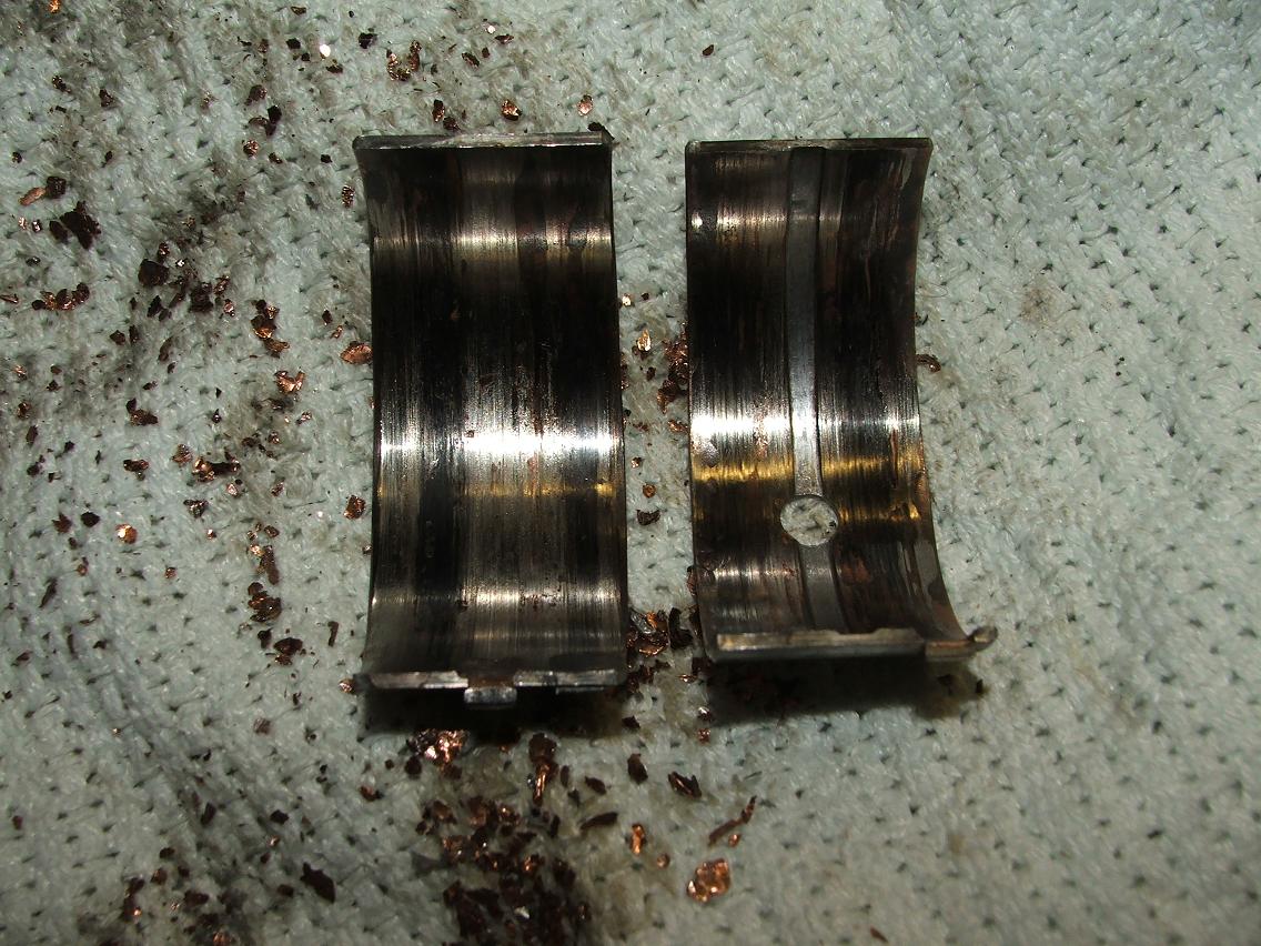

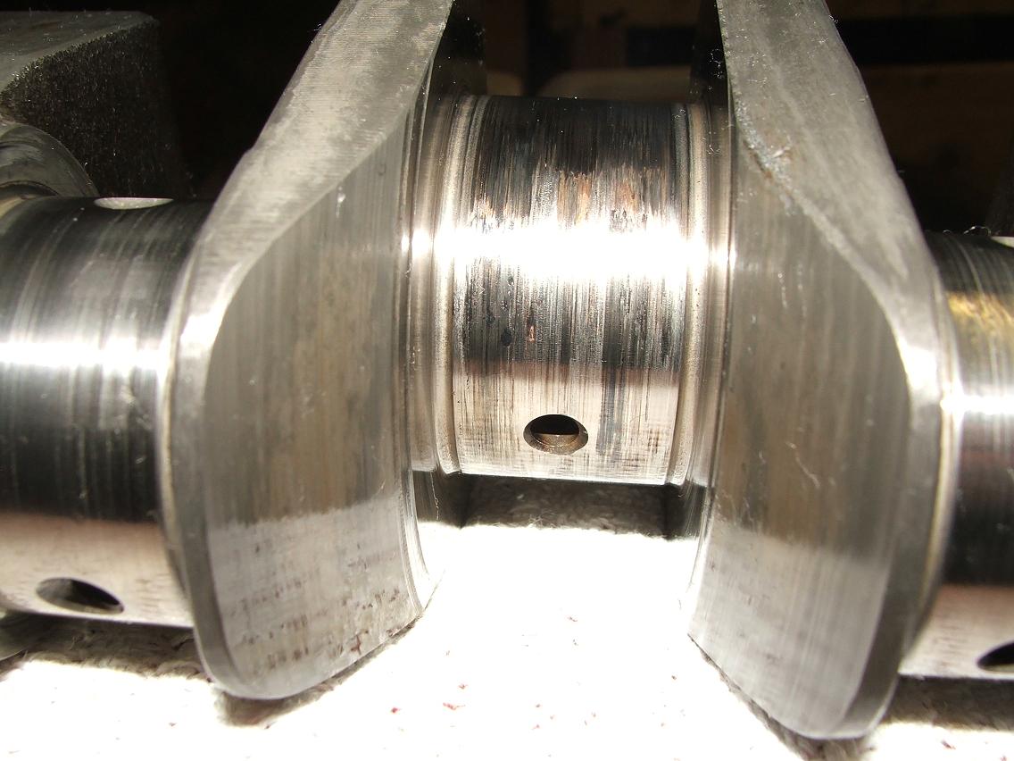

Heres the pics at last.
What do you think.?
Blown Crank.
Rear Main Crank Journal.
Rear main Bearing Shell
Centre Main Crank Journal
Centre Main Bearing Shell
Front Main Bearing Shell
And as Vegard mentioned above. Heres the plugs ( Sprocket ).

That is contamination im afraid. But in all honesty, they dont look that bad.
Did you plastigauge the clearancies before you assembled it?
Edited by Sprocket on 9th Jan, 2010.

No, not that bad Sprocket. But worn in super quick time.
When you say contamination what do you actually mean? Foreign bodies or oil break down.
Because I've not found any real muck in the box or block ( oil galleries ) or any sign of anything broken.
No Plastigauge used at the time of rebuild. Just old school measurement techniques.
I have spent an hour examining the block and oil ways etc and have measured the rear main oil feed drilling in the block its 14mm from the block end face as per normal pre A+ blocks, however when I come to check the drilling by pushing a flexible tie wrap up from the rear main bearing its difficult to do. Almost as if there is a miss match with the feed hole's?? I’m not sure if this is because of the relief valve drilling (where the ball and spring is located) but I have another block which I will measure for a back to back comparison of this feature. The other main oil gallery to main bearing holes are perfectly clear both on the centre main and front journals???.
The search goes on. I don't just want to rebuild it and screw up yet another crank.
Si
You can see particulate material embeded in the bearing surface and light scoring marks indicating that debris has entered the bearing at high speed. This could be from machining processes on either the block or the crank.
I spend at least an hour just cleaning the oil galleries with tube brushes, paraffin, parafin gun and compressed air until the parafin runs clean.
What other method is there to measure the clearance in bearing journals other than the age old plastiguage?
Also, please clarify one of your initial statements. "Starting of fine 65psi then falling to about 20-15 after about 5 mins" was this from cold? This could indicate that the engine clearancies were large to begin with, oil pressure dropping as the oil viscosity drops as it heats up.
Also, if that is a Pukka Turbo crank it will be hardened, and would not wear so much to require another 0.030" grind to clean it up. Having said that, the 0.010" grind might have removed the hardened surface.
