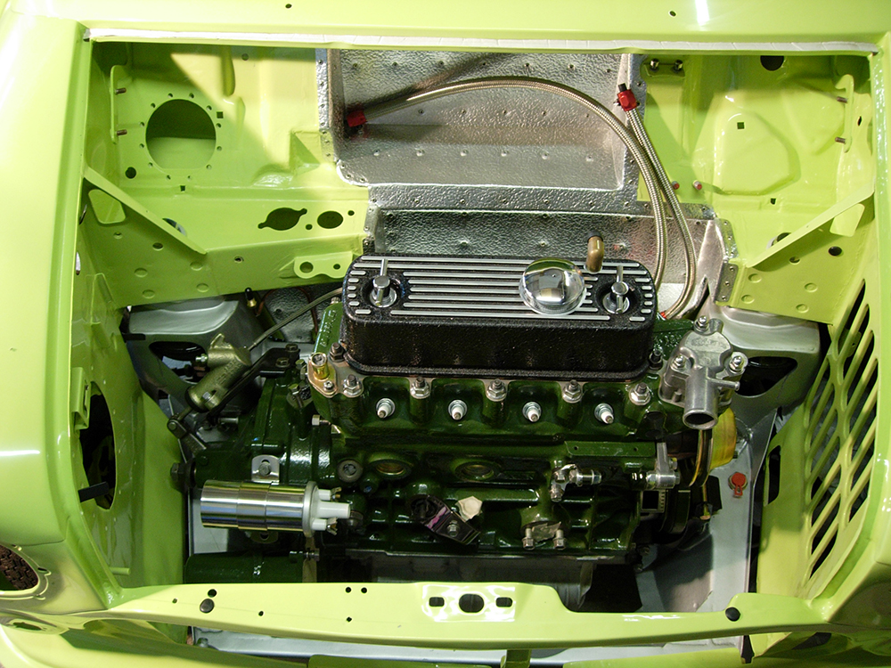

do i need to put the box in a particula position or just central ? any advise will be gratefull*happy*
Its not an exact science, just make sure you have a nice angle on the cross member on the passenger side.
Just like this...
From this thread.

stu'turbo'thomas
41 Posts
Member #: 7902
bridgend, south wales
wow thats a clean engine bay! nice. thanks man.

sadly now ive gunked up the welds with seam sealer it looks like a birds shat on it

Pretty similar.
One of Jason's boxes.
I kept mine as far to the passenger side as possible to retain most of the re-inforcing ribs around the pedal box (only seen from inside the car, not in photo).

Stupid question: how do you do to put back the heater ? Or you don't care ?
Put some new brackets on the back of the box and move the heater a bit further inside the car....

awh i see. i have a minispeed box it dosnt look as deep as the one you have there did you make the heater brackets urself ?
In my case the box is from Jason on here and it is slightly deeper and with a sloping base - a better design if you're using a T3 - and yes, I made the brackets myself as one of the originals got destroyed cutting the hole......
I made them ever so slightly shorter to compensate for them being further back.

Or do what I did and add a 3 inch extension to the 'standard' bulkhead box to provide loadsa clearance for the actuator.
Also, if you add the brackets on the back of the bulkhead box and use a Mk1 heater with the vertical slider, it will not protrude past the bottom dash rail.
