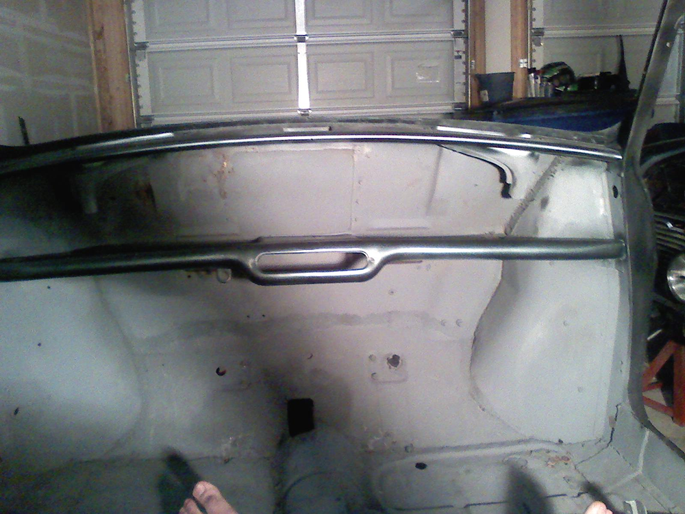

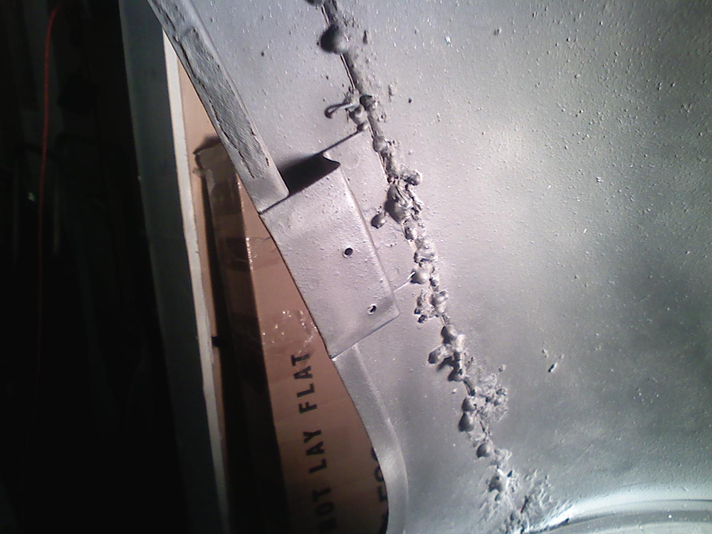

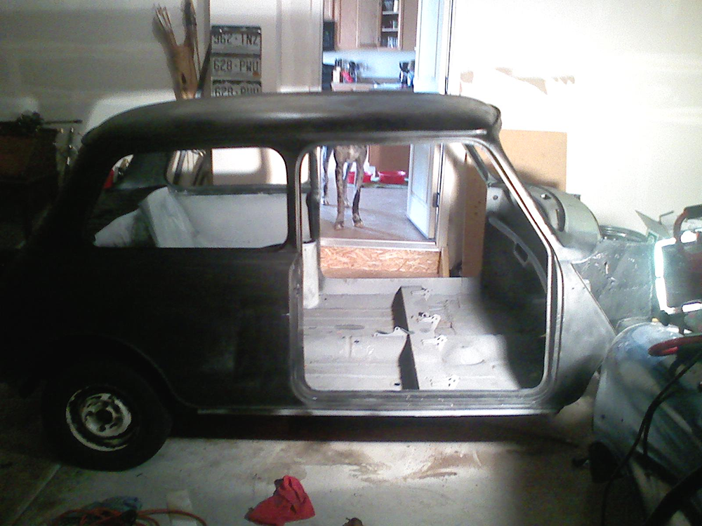

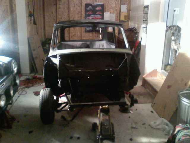

Here's some promised pics. Ignore the toes please, lol. And I have a pic in there on the rear window, meaning the 1/4 glass with a bracket. I've not seen this before, is this for the 1/4 opening glass? And the mini that seems complete-ish, that's the donor.
