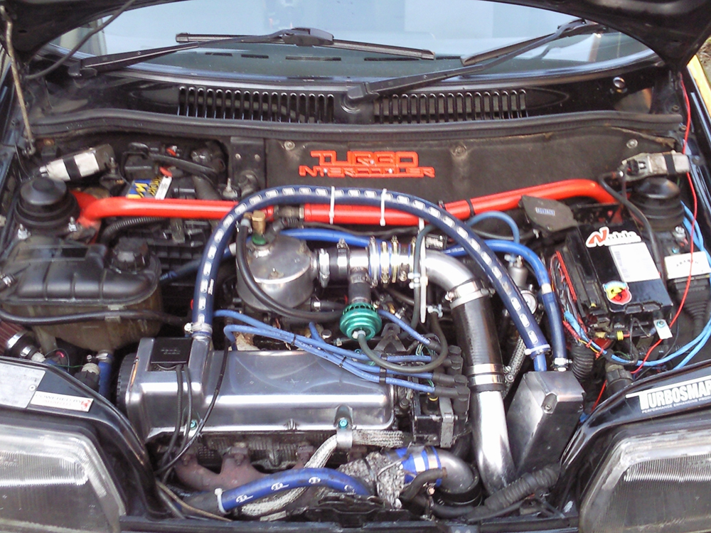

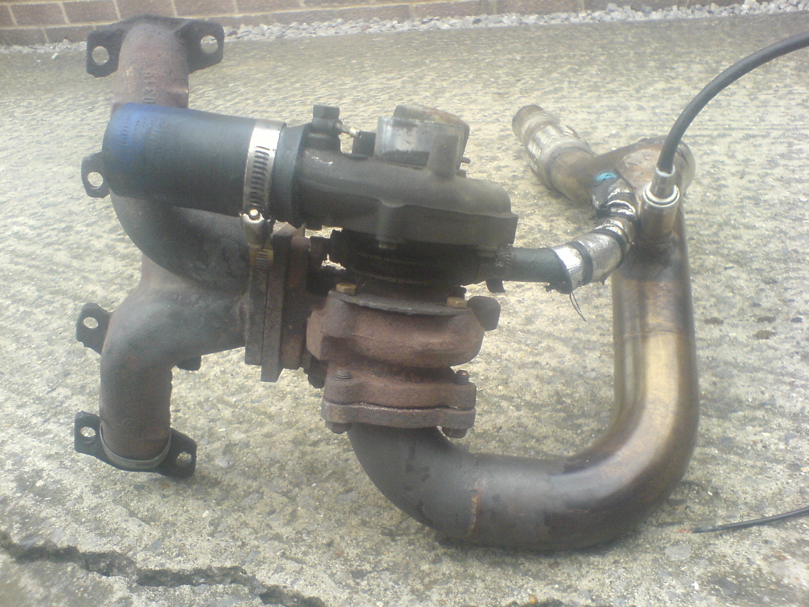

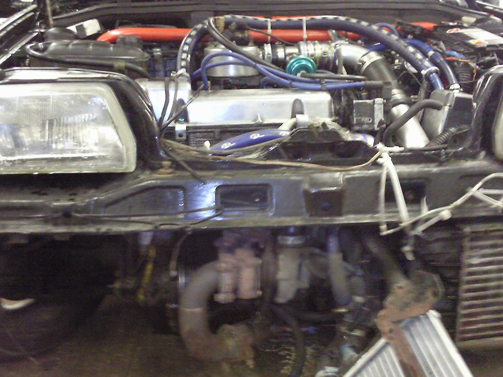

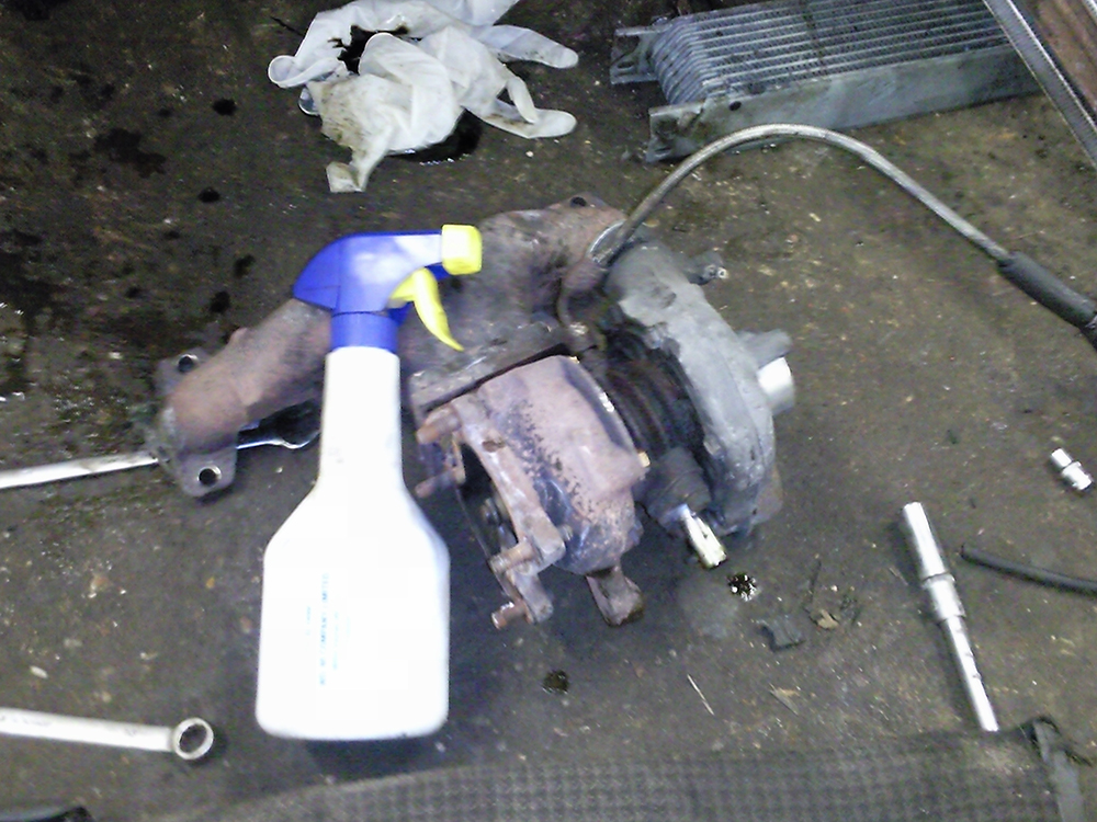

yes i have some photos of my my set up and turbo ill pop some up below.

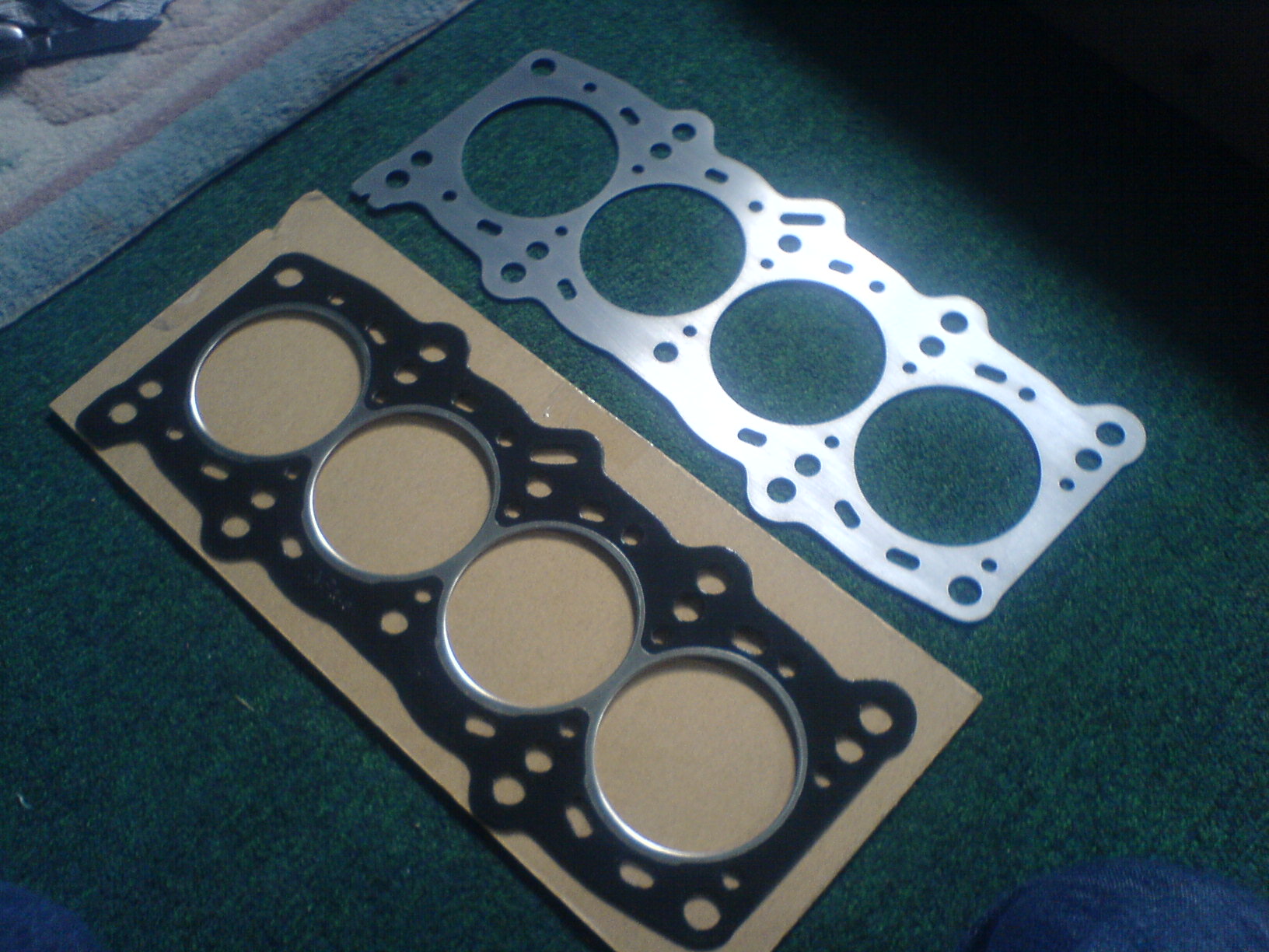

The T15 is actualy a GT15 designed for low boost disel applications, Vanaaken used this turbo on the 1108cc and 1242cc 8v f.i.r.e engines like mine running 0.35-0.4 bar to give 85-95bhp depending on what engine it was fitted too. But Vanaaken also made a high boost kit for the cinqs which used a different Garrett T15 from a vauxhall astra diesel which was run at 0.5-0.6bar 110-115bhp. I have a friend who runs n 1108cc turbo cinq with the high boost T15 and has recorded 134bhp with no apparent problems at 1.3bar, where as my engine epec should be good for another 10bhp on this spec running the 1 bar boost.
Ive run into a few problems while trying to get my setup right, firstly i used to run a 9:1 c/r with 0.65bar making 116bhp on my turbo but had to lower the C/R to run more boost, I actually run a shamful setup at the moment for exsperimental reasons, that setup was to fit another head gasket to lower the C/R to around 7.8:1.
Just by fitting the H/G i lost 21bhp @ 0.65 bar hence why i have to run higher boost levels to get the BHP.
here are some pics of the setup and turbo -
That looks like a GT1544. There are two different versions of the GT1544. You will need the larger one.
Have a read of this:
http://www.turbominis.co.uk/forums/index.php?p=vt&tid=329594

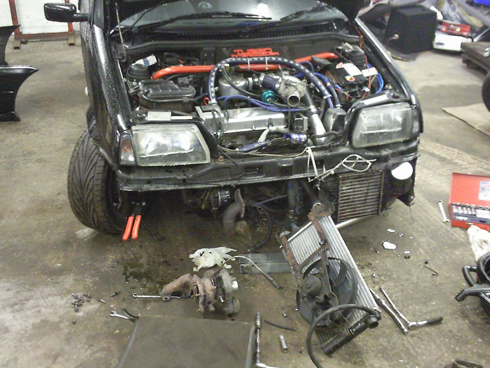

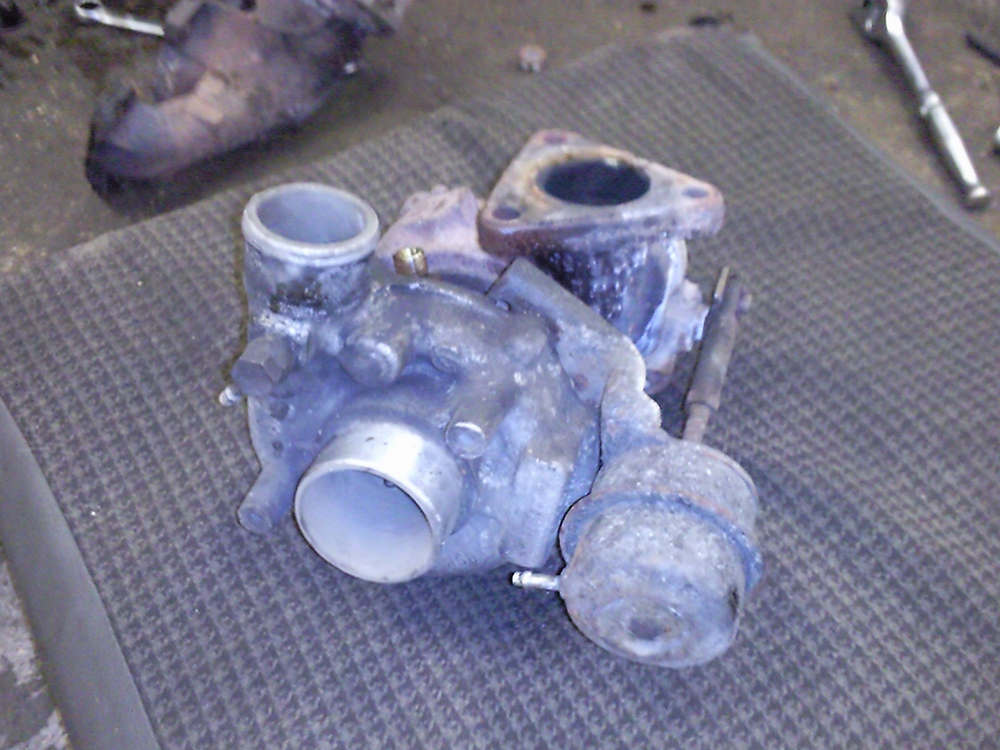

here are a few more
mine is the GT15 454083-1
audi/ford turbo and im asuming the one you speak of will be the item used on the high boost applications vanaaken used,,,,,is there a difference in the turbine wheel and housing? mine is 0.35 A/R but i dont want it to become a restiction at 145bhp as a hybrid.
thanks
jason
What's odd is that Garrett have changed the map on their website for the 454083.
It's no longer any different for the 454082.
You will not get enough air flow through the smaller one for 145hp.

Yes it does look like you are going to be falling off the map of the smaller unit,
that coupled with what is a fairly small intercooler (by our standards lol) is not going to help.
just an idea, but can you stick a slimline fan on the (water) rad, move it back a couple of inches and get a big IC in front?
