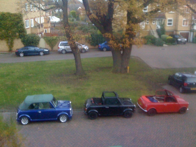

i've also sold the other two cabrio minis in that pic to fund this one Lol
