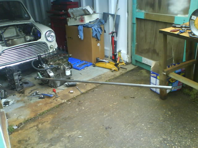

On 5th Apr, 2010 matty said:
A case of ' If your tool is not big enough, make it bigger' *hehe!*
On the other hand, as Archimedes once said "Give me a long enough lever and a place to stand, and I will move the earth." *wink*
Haha good old halfords ratchets!
I stumbled across this pic the other day and it made me laugh.
