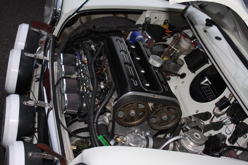

Space was the main reason I used them

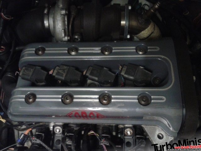

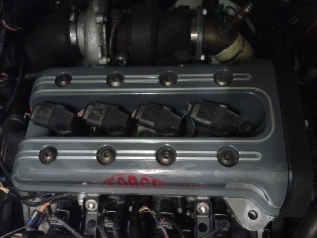

Did you have to change the dwell or anything to get these to work ok? How well do the fit in the k head? I'm looking for a tight seal between the cop and the head to keep debris away from the base of the plug hole.
What are those COP's sprox?
They look like Ford duratec perhaps?
I'd presume they are a bike type. there are lots of Denso ones available form bikes.
www.twin-turbo.co.uk
Those coils are Denso 129700 - 4150 from a suzuki GSXR. They are inductive, so the ECU will need four IGBT outputs to drive them if you want to use them.
I havent done any testing on them so to speak, other than they worked OK with a dwell of 2.5ms. That said, I never got to the bottom of a missfire around peak torque when running a 50 shot of nitrous. Some experienced people in the NO2 field suggested that the spark was not fat enough to ignite the extra rich mix, but I never got the chance to try and increase the dwell. I didn't have a scope at the time and I didn't want to cook the coils, I never had a spare set.
I have however just ordered a set of VAG TFSI 1.4 coils which have the ignitors built in so they should be perfectly suited, but will need some wiring mods to my loom
There are significant differences with the Denso coils from bikes. Some are CDI As I found out the hard way. They will work for about 30 seconds then pop the fuse and the coils are extra hot to the touch, even with dwells as low as 1ms
I'm thinking of the change to COP to save some weight, I like the look of the VAG TFSI 1.4. do you know what each of the 4 pins are for on them?
