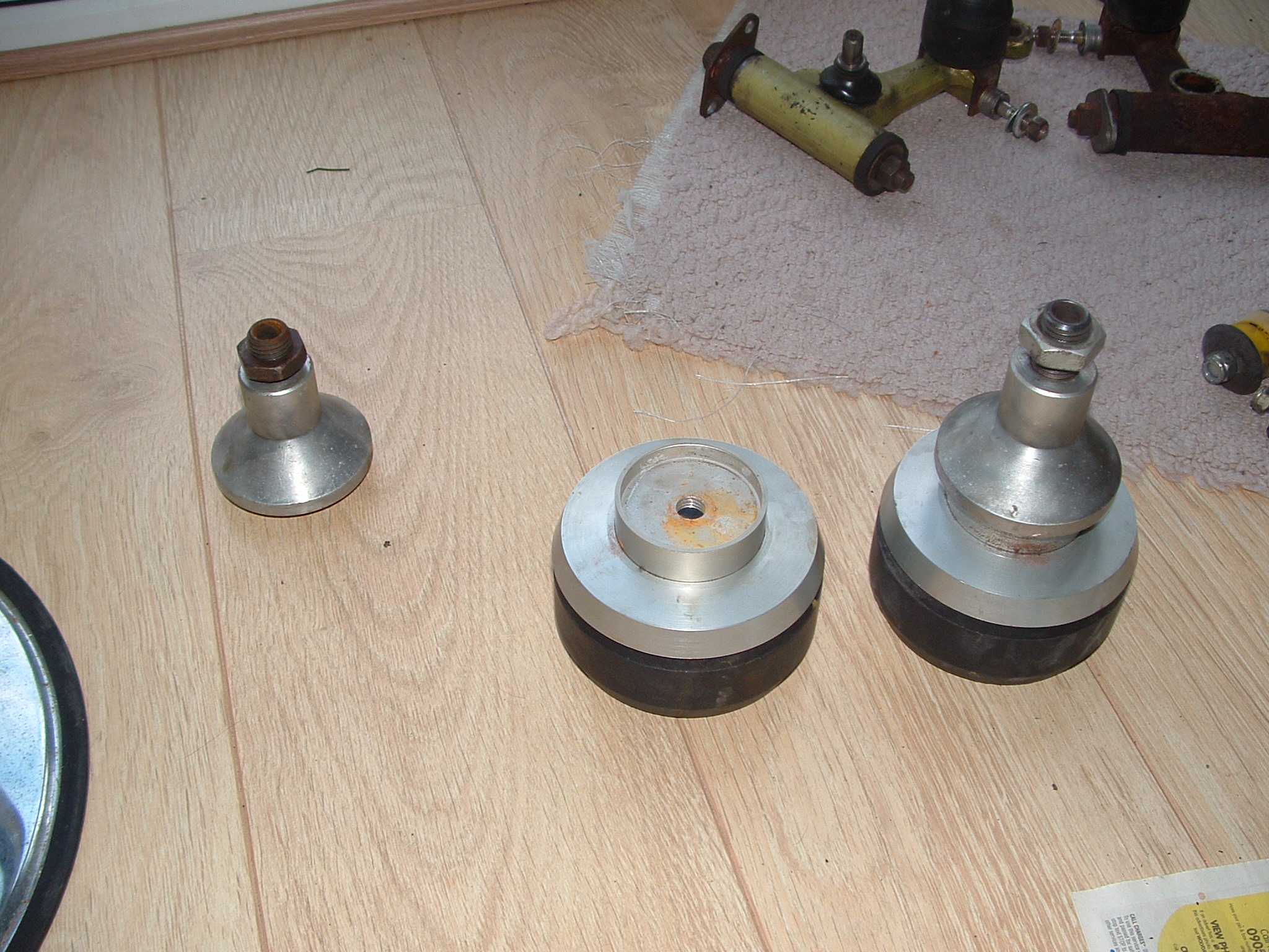

I have removed these cones from a subby i bought anyone seen these before? The subby they came off was a hydro front converted to dry with massive neg. camber having converted hydro top arms and 2.0 neg bottom arms, massive bump stops and avo shocks so i would think it may have been a track car?

i had some of those in my car id found at the scrappy steve ... id asumed they where smootha rides from minispares .

aye thought they were smootharides too. but doesnt explain the huge bump stop!

arent they rear bumpstops for the radius arms?
edit: these
http://www.minispares.com/Product.aspx?ty=...id=34221&title=
Edited by Adam_R on 10th May, 2010.
I think that they are silicone srpings but I can't remember the name of the company that made them.
I've just shoved a set I had in the Sprint as the doughnuts on it were fooked. Not sure if they'll be any good.
Edit: not smootha ride anyway, these are made by Moulton and look conventional. http://www.minisport.com/mini-spare-parts/..._MSLMS0400.html

Those bump stops were originally used on the hydrospastic minis on the rear. It is a Special Tuning department modification to use these on dry subframes front and rear on rally Minis. The rear needs the long flex brake hose that connects direct to the rear wheel cylinder, so that you can tuck it down under the radius arm out of the way. Got them on mine.
Edited by Sprocket on 10th May, 2010.
spectra dynamics?
Spectra Dynamics - http://www.deflex.co.uk/catalog/index.php

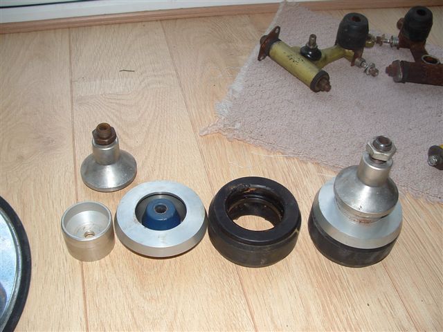

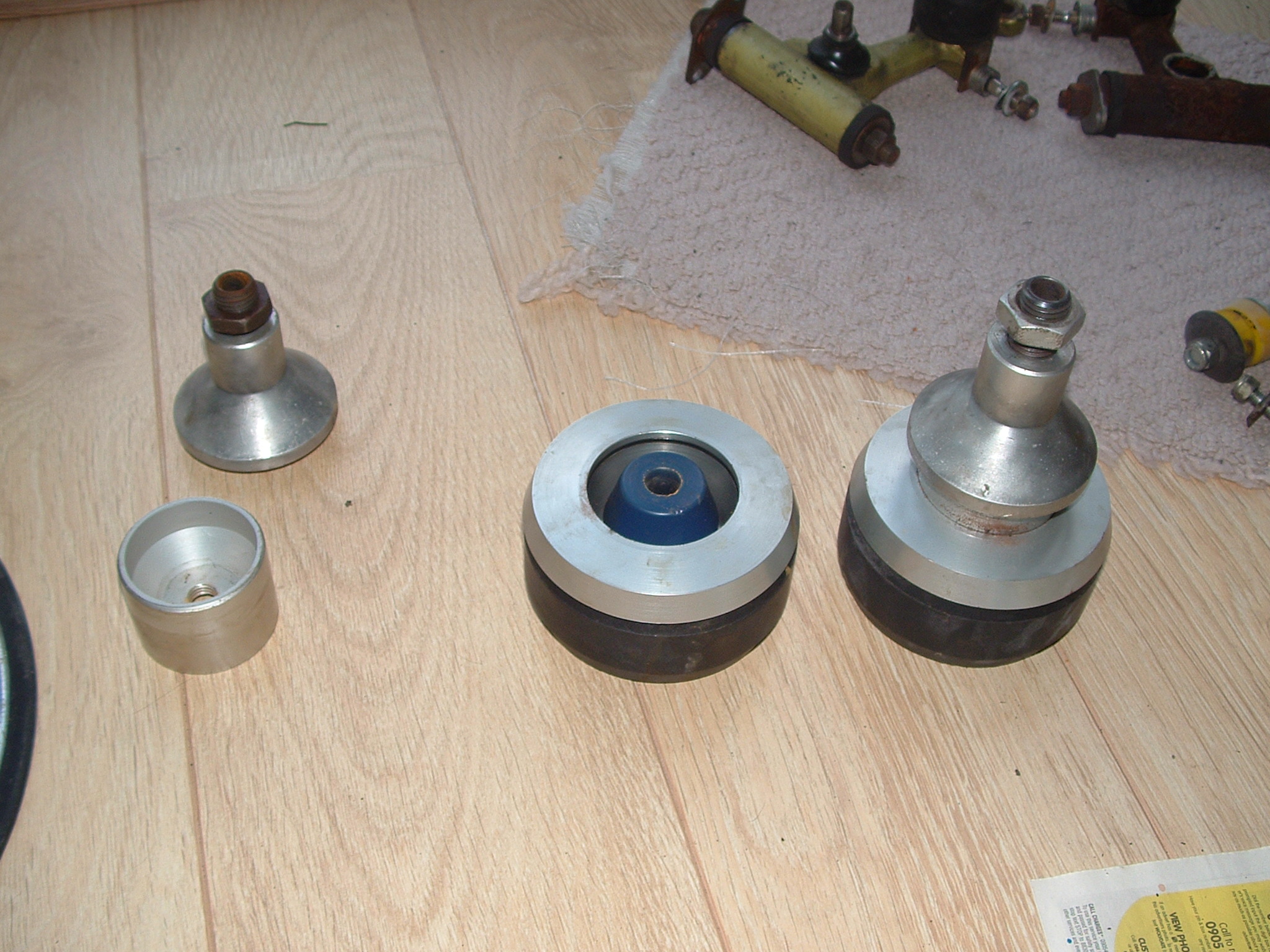

Deffo not smootharides. The bumpstops on the toparms in the background i have found on the minispares site so the mystery ends there for them but the cones are really unusual.
There are two rubber 'springs'and two alloy parts. The one alloy 'pot' slides inside the other with a rubber cone inside and then the complete lot sits in the rubber'ring'. They do look well made and seem as though they would work well.

They're deffo some of the spectra dynamics poly springs. Circa 2004 iirc. At least that's when I bought the set I had.
In theory they should perform well, as Baldwin won several years while running them in his miglia.
