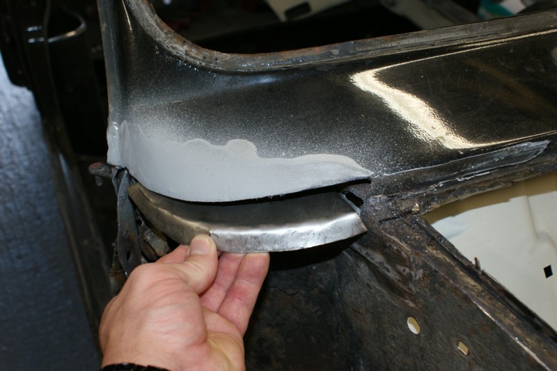

So here are some pics of car when bought and then some of the progress. Basically anything that wasn't rotten had been repaired really badly! so this has turned out to be a pretty big challenge.

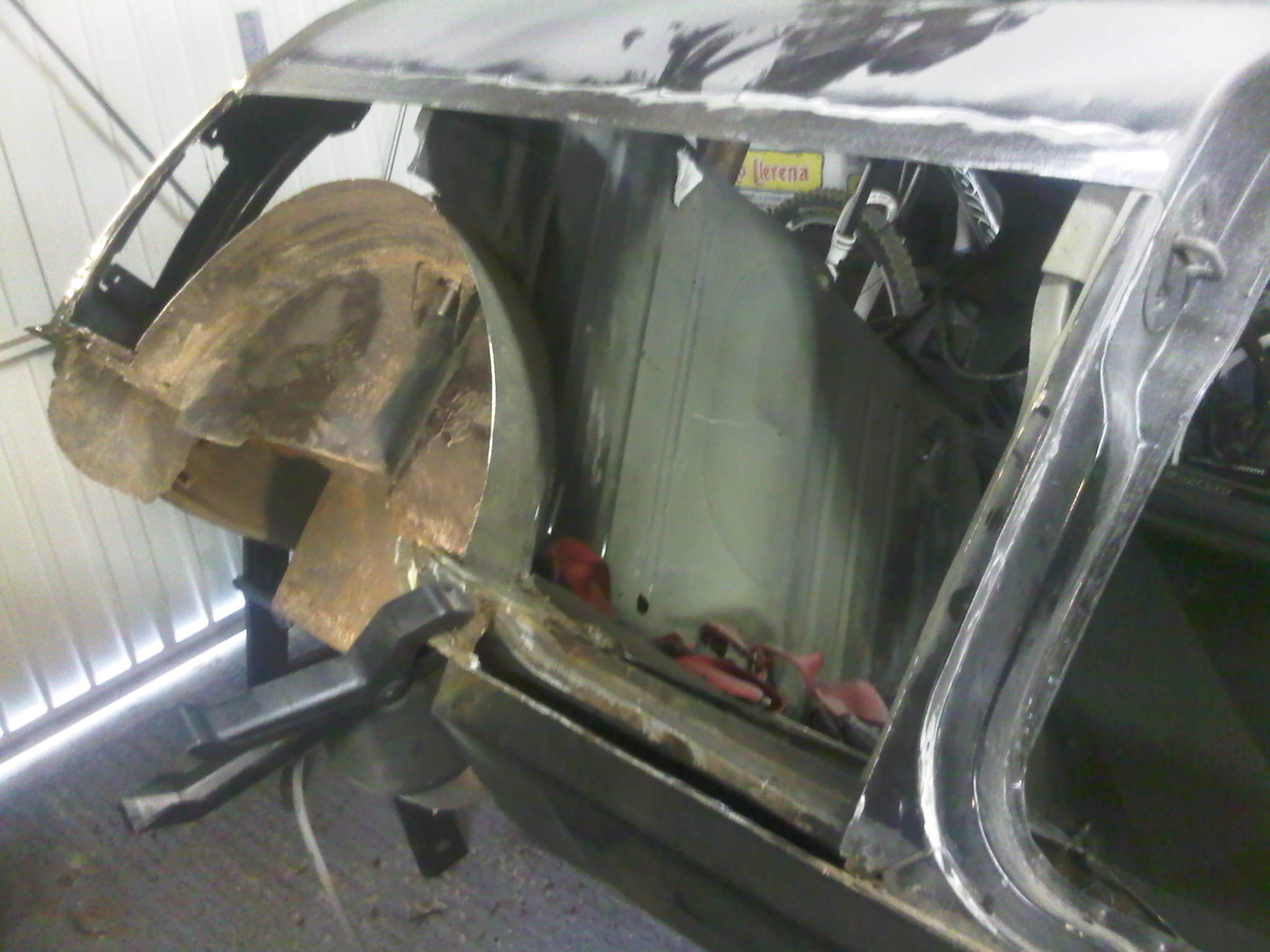

Cheers, I have a load more on my phone with half the side cut off. started as a scuttle panel and now only rear floor pan is original on o/s lol
New floor pan is in front o/s and will weld on new sills etc shortly. been strengthening some areas also as I go.

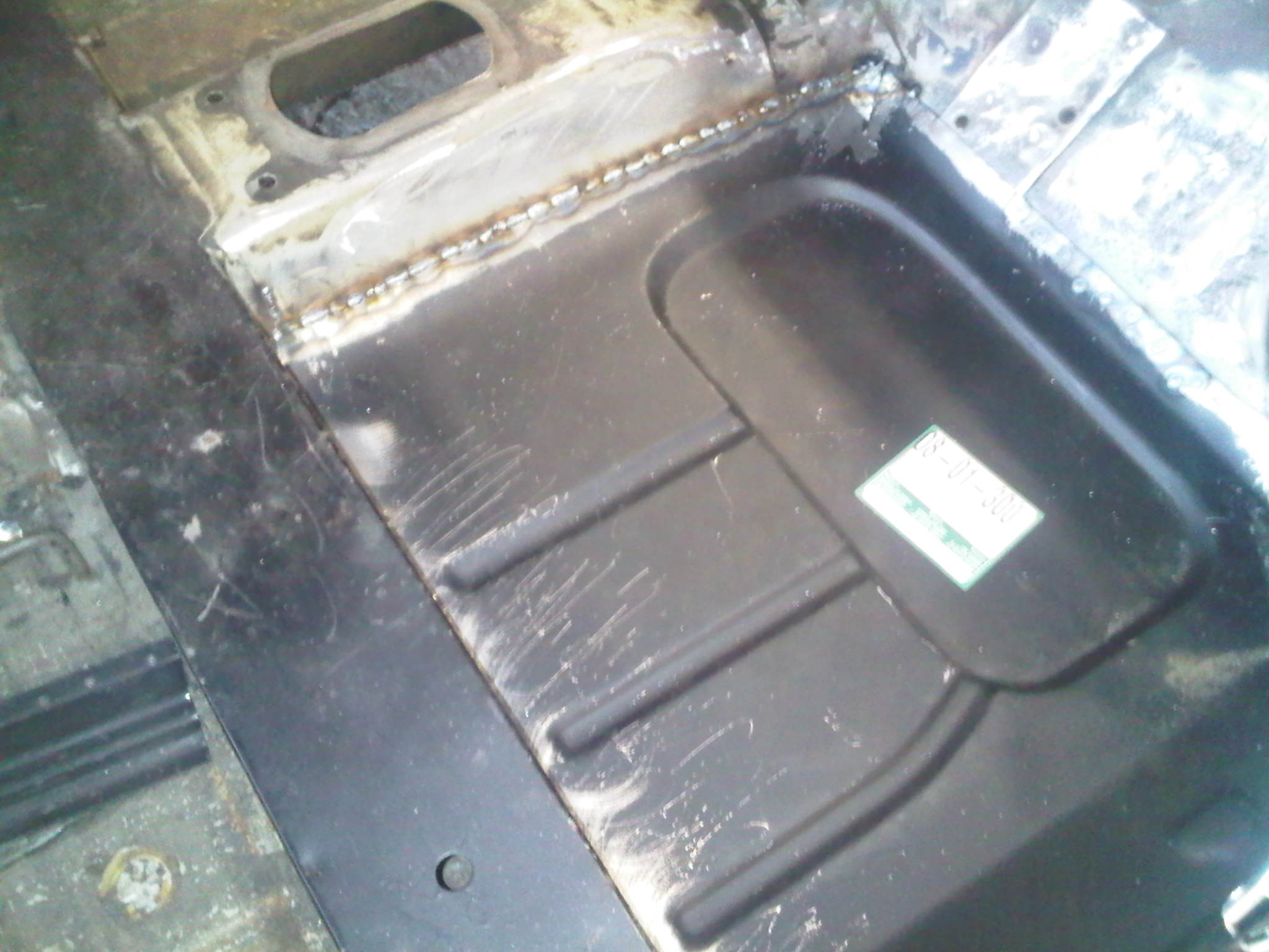

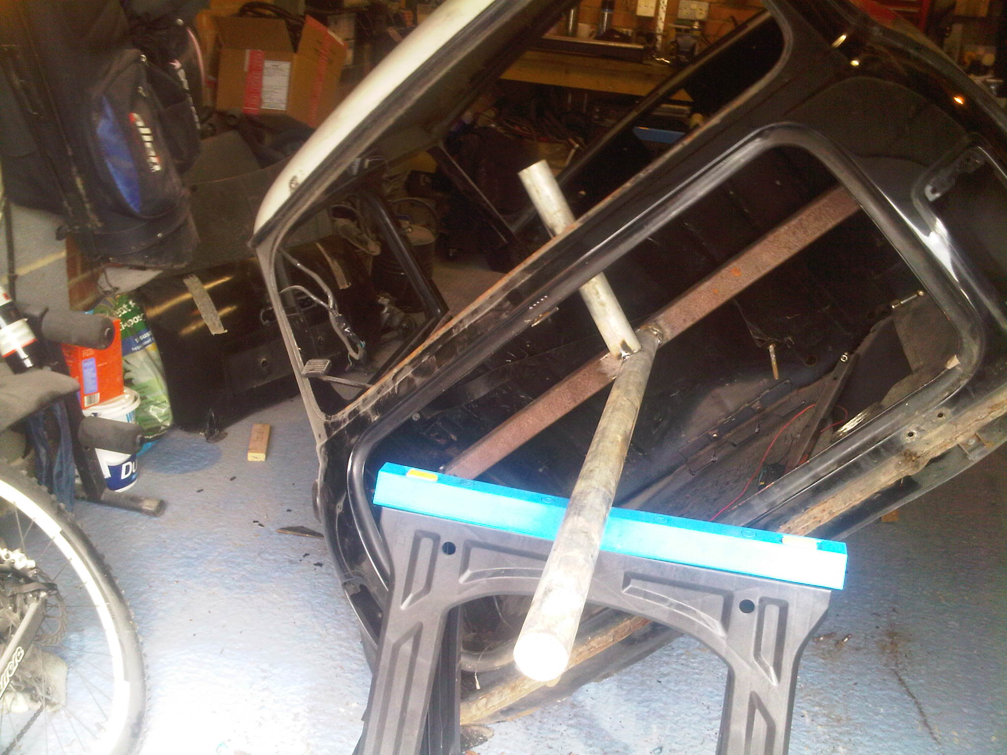

here is a pic with floor pan now welded in and side of car chopped out!
I have decided to make flat floor pan now just trying to decided best way to swage floor pan for strength?? I am thinking perhaps a die from box and angle which i have seen somewhere else and then hammer form them with another die.
Should keep me busy for a bit. I have the side repair panels bought so will use those due to subframe mounts etc

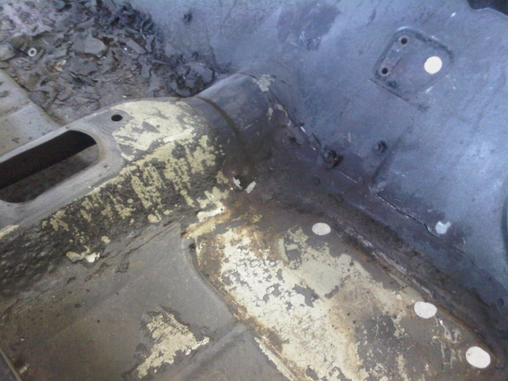

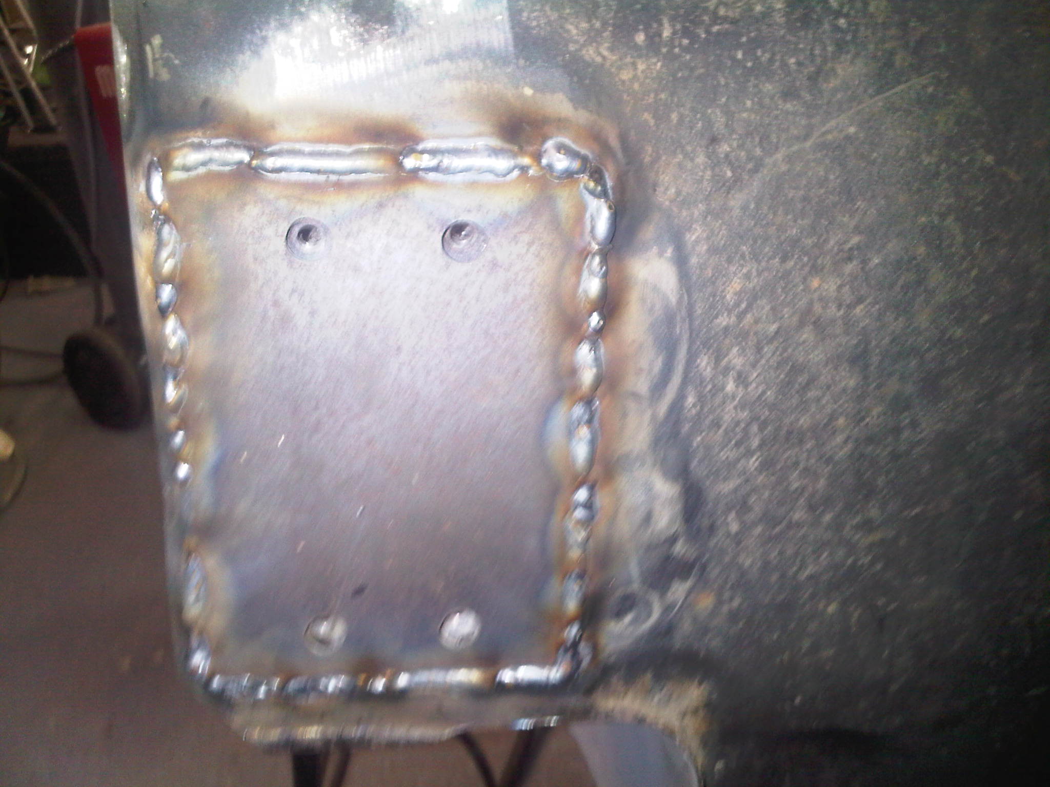

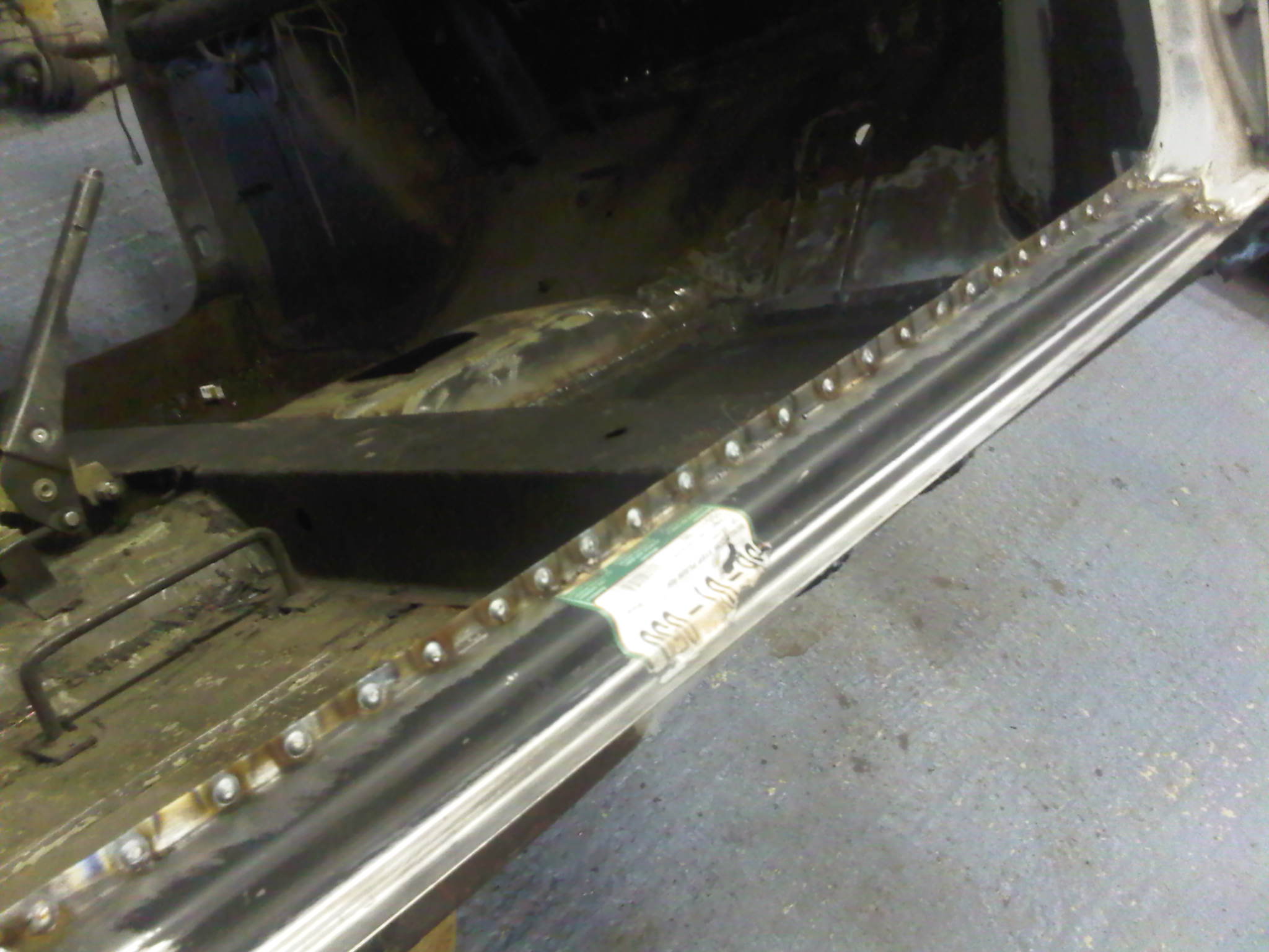

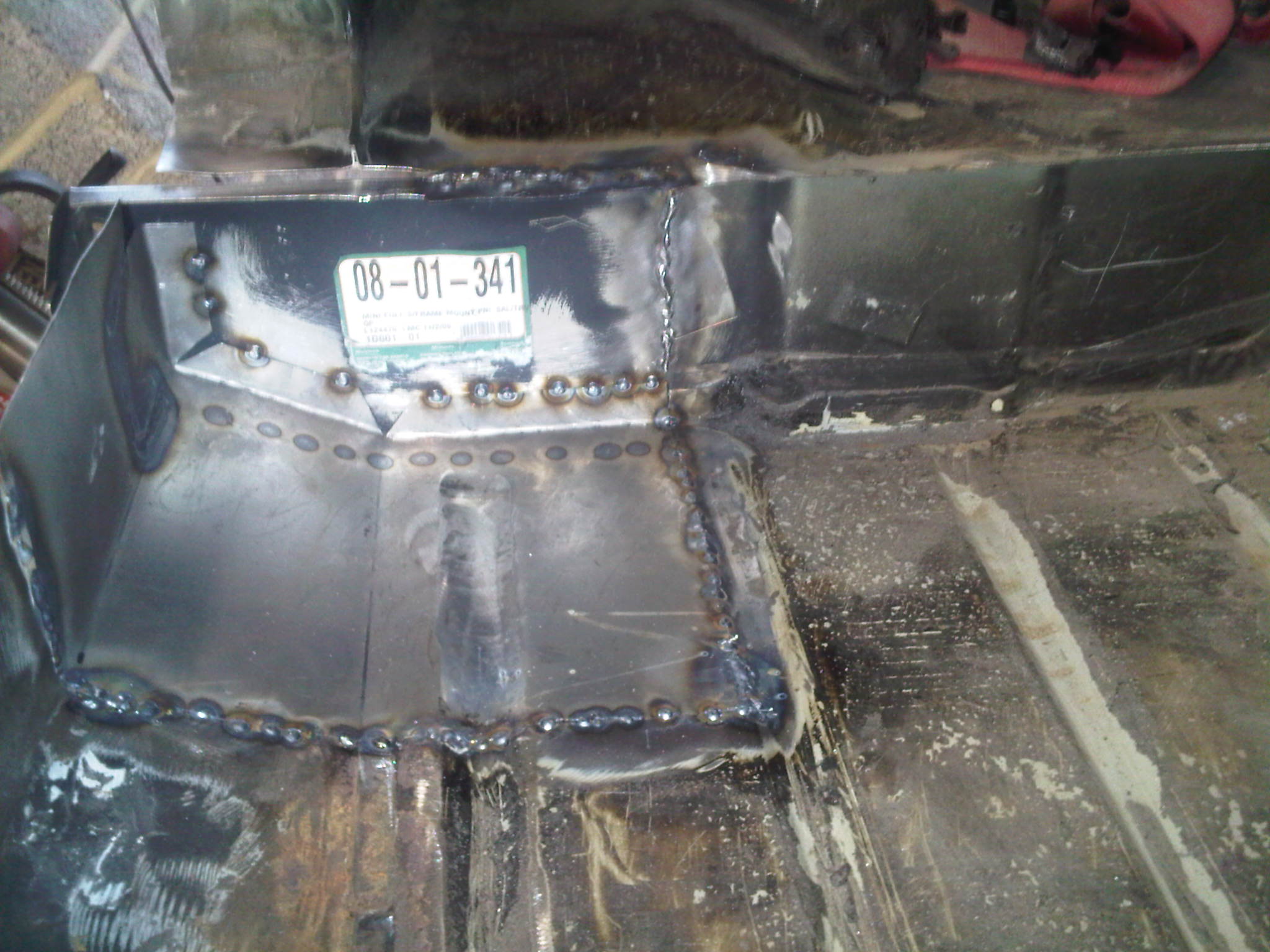

OK managed a few hours on car as finished job early at weekend :)
Made a new section to go in floor and inner sill which was rotten due to puddle sat there for years and also replaced subframe mount toeboard (section) and got the door step welded in. Just need to seem weld the plate in floor, make a rear arch infill panel, mount sill and then rear wing. I then need to mark for tubbing remove rear wing and weld in arch section.
once all complete I have the same the other side.
Basically it will be a new car lol!
Boot floor is all but shot and was going to make flat floor but everybody seems to think problem come mot time then IVA test to follow! I am not so sure but don't want to risk if that is the case.
SO the jury is out with the floor. If it was in good nick I would just cut sections out but not much is left so was gonna cut it all out. I have the side repair sections so was going to put those in and then make flat panel in between with swages for rigidity. although looking at swage I made in floor panel I need more practice hammer forming *wink*

yeah I have both corners the same as back of car was just swimming in water!
It was nice actually putting something back on though rather than slicing it off.
Depending how much attention her indoors needs this weekend coming I may get the one side wrapped up. I am tempted to just take a week off work and blitz the thing soon.

Well the whole boot floor is gone now*surprised*
I was going for completely flat floor but I am going to use outside repair pieces then flat plate between. It will give more mounting options without wheel well but will also ensure clearance for subframe remains.

out of curiosity, how did you make sure your sub mounts lined up on that rear corner when you replaced it??
cheers
CH007
54 Posts
Member #: 8863
I just took center measurements of mounting holes then ensured new piece went in the same. Wish I hadn't put part in now as have now decided to replace whole boot floor through to rear seat so could have put whole panel on! still it's done now although you saying that makes me want to pop out with the tape*wink*

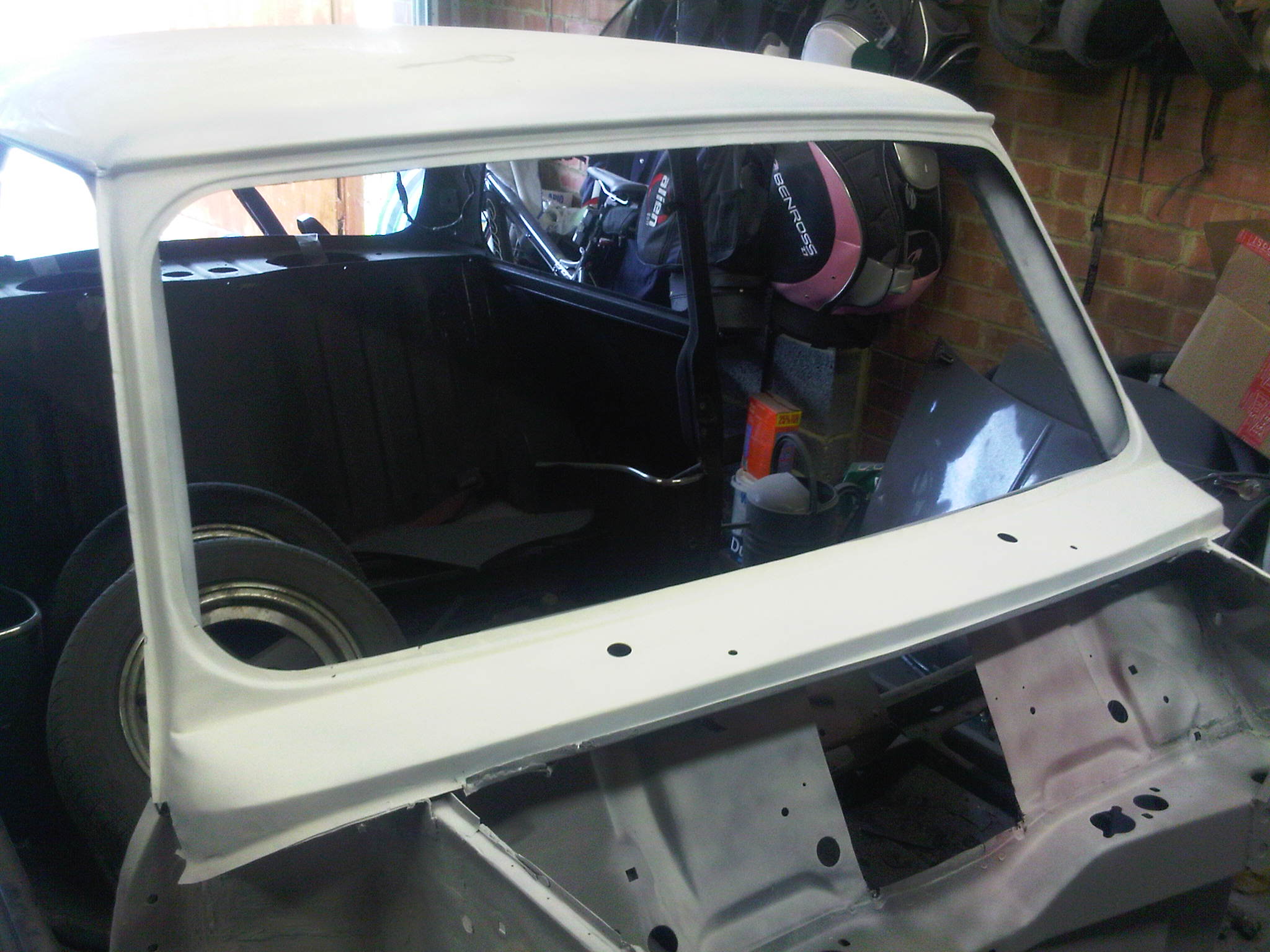

So made some progress on the rust bucket in that it's not one any more*happy*
Finally one solid shell to work with and weld in cage now fitted along with inside primed ready to go
Underneath is now coated in gravitex. Just the wheel arched and sills to do which i will do with a smoother finish stonechip protection as my gun tends to give very orangepeel finish which is nice for underneath but not for paint areas.
So next up is to take delivery of all fibre glass such as doors, bootlid and 2 piece front end and then prep outside for paint.
Hoping to get this thing painted before the weather turns colder then can concentrate on mechanical when weather turns which I cannot wait to get stuck into.

Love it, your a quick worker! Wish the people doing my mini worked as quick as you do.
Really like the cage too, although the door bars look a little high and aukward to get in?
1293 88.8hp 82.2ftlb
17.3 1/4 @ 78 mph
Naturally Aspirated (for now)
CH007
54 Posts
Member #: 8863
Doh schoolboy error should have been below bulge on b pillar not above!!!
It is awkward getting in and out lol. It just didn't seem high enough for protection with fibreglass doors below. I may cut it off the drop it and weld in cross brace pieces instead. More bloody grinding thought I had finished lol

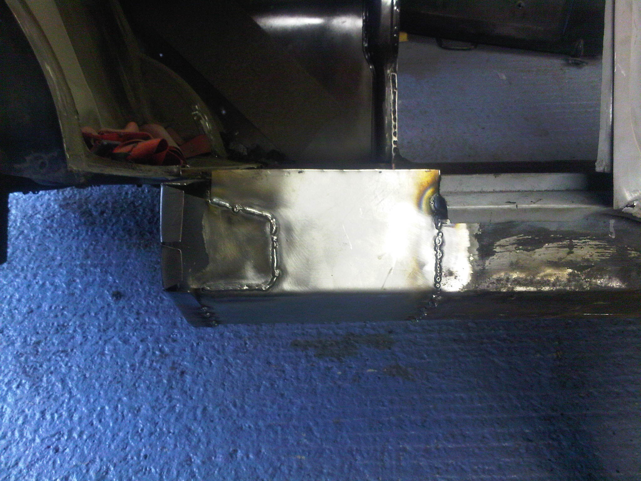

Looks great, but over sills *Shooting*
CH007
54 Posts
Member #: 8863
Thanks for comments :)
They are oversills but nothing underneath them. I had to cut out 2 old sills before fitting these *hehe!*
Make sure you vent them then, otherwise you've got a nice big moisture trap
been there done that *happy*, good work so far, vent them and get waxoil in there pronto or you will be doing it again in a years time ( been there too*happy**happy*)
