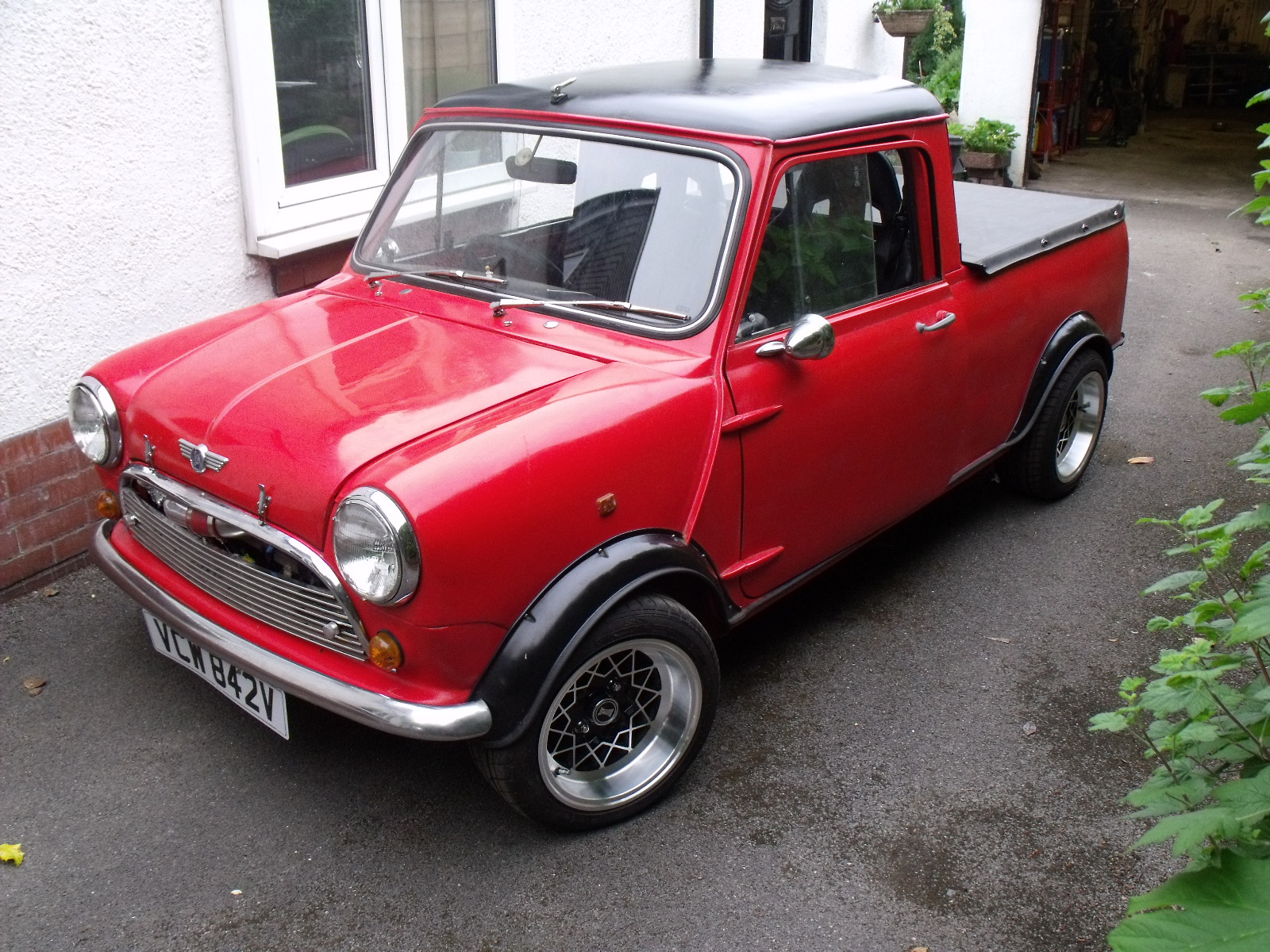

These are some photos of my almost finished pick up. I brought it as a project. I have swopped the 998cc for a 1275cc, with low compression pistons, flowed head, running megajolt, belt drive, roller rockers etc etc. It also has vented metro brakes and coil spring conversion / hi los. I brought this after loving my first mini 18 years ago. Should be moted sometime over the summer. hope you like it.

firstley welcome to turbominis
it looks great, have you any power figures ?
Looks good, welcome along.
The propper way to supercharge. keep us updated, and welcome.
www.twin-turbo.co.uk
welcome to TM and very nice *wink*
Welcome aboard. Nice looking motor.

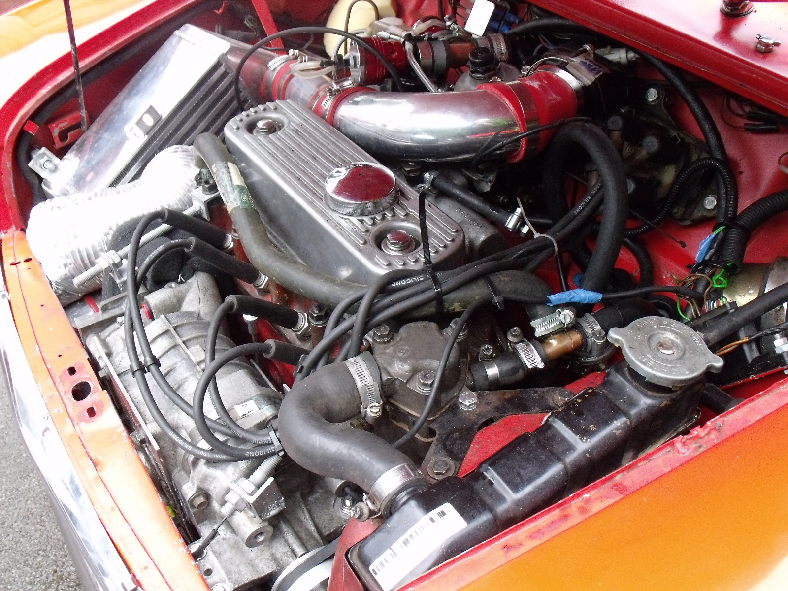

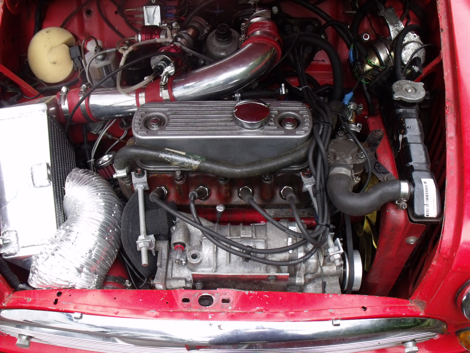

no power figures yet, i have not had it running for more than 5 mins yet. It was built from a turbo motor that was making (i was told) about 130bhp. I will be happy with something around 120bhp. Will have to play with the pulley sizes once on the road. The pistons had massive dishes, i struggled to find some rings for them, The head had a standard ish volume, but with the pistons the cr is around 8:1. Hoping for good things, but i think the m42 charger is going to be too small.

nice setup.
Now you have time for the second engine on rear wheels :) .
got any more pics of the install??
looking very nice....

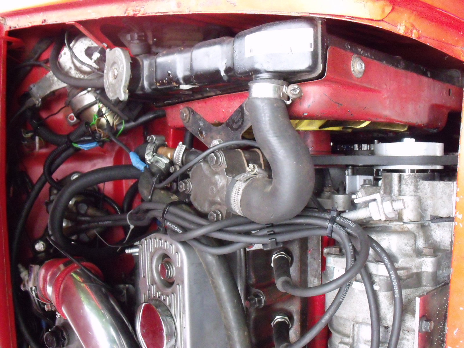

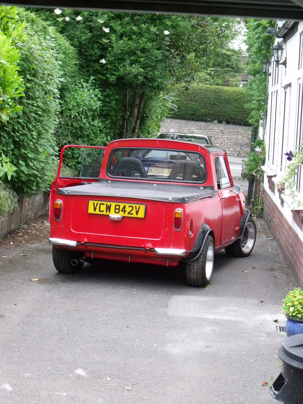

some extra pics for you

nice looking pick up - install looks very neat.
