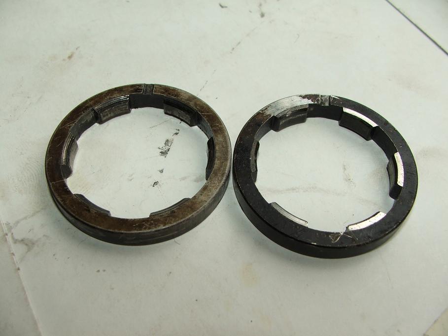

Right I have been checking second and third gear side clearance, and it is in excess of 0.006" where it should be 0.0035" to 0.0055" and I would rather have it towards the 0.0035".
looking at second gear retainer that was in the transmission I have currently been using, it has a large chamfer on the locking splines, compared to the one I just removed from a 1990 998 transmission which has a much much smaller chamfer. This larger chamfer is allowing a slightly larger side clearance the way it sits on the splines of the main shaft. see the pics.
Third gear retainer on current transmission is a nats dick thinner than the one from the 998 transmission. So it looks like its going to be a selective fit build on this one, from my stock of 6 transmissions of all different ages *hehe!*
Other things I have found. Two main shafts, one from the current transmission originaly from a late MPi transmission, and the other from said 998 The thrust face on the mai shaft for second/ third is marginaly thicker on the MPi one than on the 998 one.
I will now have to wait for Fast Carl to modify the main shaft for the KAD bearing, to see if I can get the side clearancies down to near bottom limits. With a bit of luck I can.
