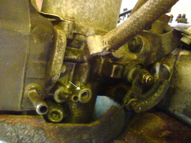

31st Jul, 2010 at 04:58:00pm
That needs to be blanked off. Personally I would drill and tap it then fit a suitable grub screw with some thread lock.

Thanks apbellamy, someone told me that pipe had a electronic valve connected to it on the metro turbo |

More to the point...why is it an opening ? It shouldnt be open. 9.85 @ 145mph

Thanks Steve, maybe it is blocked off and i was expecting a brass pipe, I will have another look at it. Cheers |

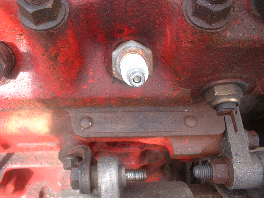

1st Aug, 2010 at 04:27:07am
A turbo head has a "T" stampedon it near the thermostat housing. As does the block near the water pump. Own the day
432 Posts Member #: 7856 Senior Member Essex |
1st Aug, 2010 at 05:36:51am
Not all of the metro turbo heads had the "T" stamped into it, so if you haven't got one then don't rule it out yet, if you have one then theres no doubt. |

On 1st Aug, 2010 Mr Joshua said:
A turbo head has a "T" stampedon it near the thermostat housing. As does the block near the water pump. not all of them, i have 3 turbo heads, only one has a stamped T didnt see amps reply lol
Edited by Brett on 1st Aug, 2010. Yes i moved to the darkside |
![]() 4642 Posts Member #: 20 My sister is so fit I won't show anyone her picture Lake District |
1st Aug, 2010 at 09:39:48am
As above, they only occasionally have the "T" stamped on them for some reason. |

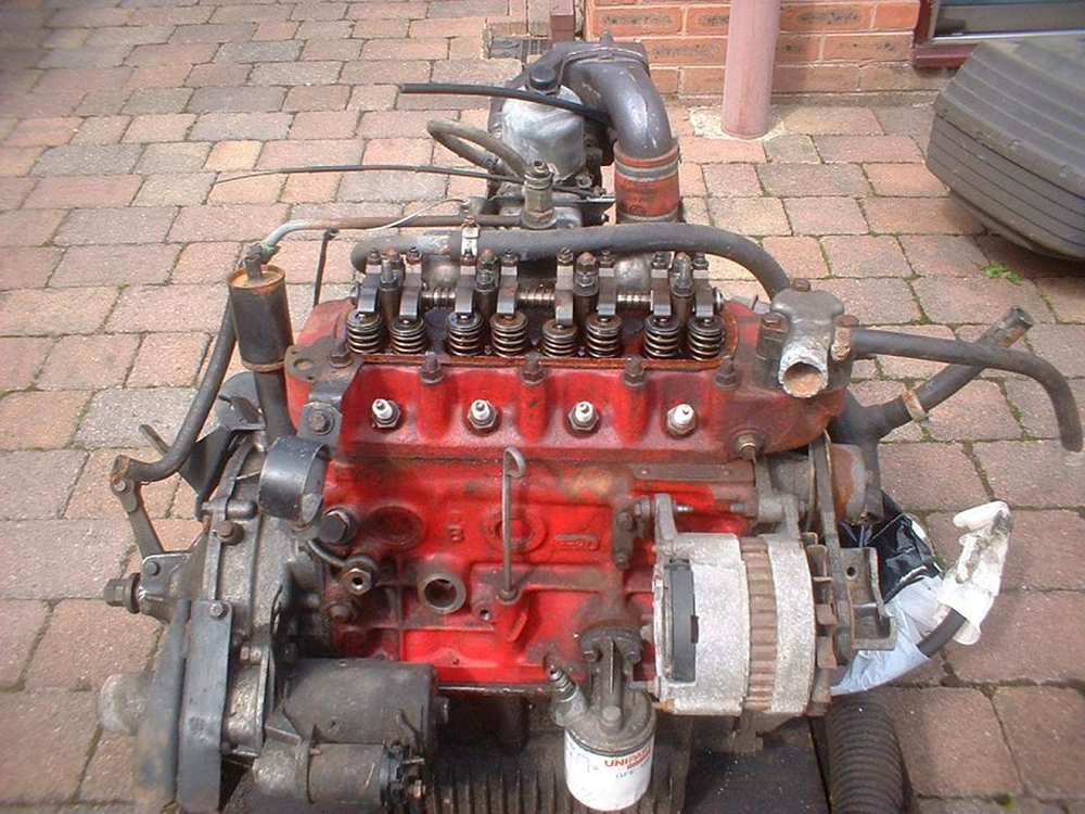

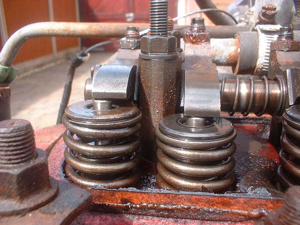

1st Aug, 2010 at 11:23:06am
Thanks everyone, just had another look at the cylinder head, no T stamped at heater take off, valve stems are both the same diameter and it has double valve springs, think someone changed it over in its previous metro life |

Can you see the valve part numbers? they should just be visible on the valve stem below the top cap. Edited by Mr Joshua on 3rd Aug, 2010. Own the day

On 3rd Aug, 2010 Mr Joshua said:
Can you see the valve part numbers? they should just be visible on the valve stem below the top cap. I can only see TAM and not the rest of the number, i will move the engine into the light and have another look at the weekend, will try and add some pics as well. Thanks for your help, much appreciated |

If he has the larger MG valves fitted then he may only need to have work done to the exhaust valves but it may all be done. Own the day

Had another look this afternoon at the head, I think the exhaust valve number is TAM1061, can't make out what the inlet is.
Edited by sr01 on 5th Aug, 2010. |

Had another look this afternoon at the head, I think the exhaust valve number is TAM1061, can't make out what the inlet is. Also uploaded some pics Definately standard exhaust valves then. |

Then I would guess the others are TAM1059 which could mean you have a MG1275 spec head in which case you will only need to change the Exhaust valves for some SS steel affairs and your good to go.
