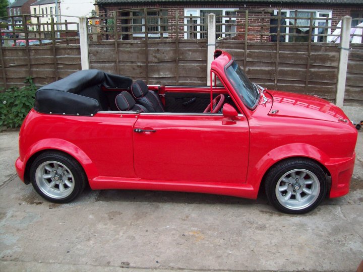

and a picture underneath of while it was running aswell
