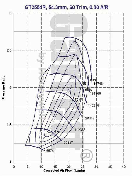

This turbo looks like it might be ok me?
Any comments as im not too hot on maps
Chris
I think it would be brilliant on a big bore 16v motor, but 5port its too big in my eyes.
Nice though rollerbearing turbo and about £750 brand new i dont think is bad.
Rick
quinton
338 Posts
Member #: 1911
998 16v I think might be to big for you.
If this is for the 970 K head engine, then it is a little on the large side.
Peak power would be OK, but not as good as a GT17 or GT20 because of the poor efficiency.
Also it has a 0.64 A/R turbine that would take a lot of flow to spool it up to full boost. The roller bearing core may offset that a bit.

Look at a GT2259
Will flow enough for your 200bhp target. You wont have to go stupidly high on the revs to achieve it either. 9000rpm should be sufficient.
Between 14-17 Psi should get you somewhere near your target.
If you feel the need for more power wind the boost up to 22-24psi.
250bhp should be attainable from the calculations using some "estimated" numbers. But what happens in a real world situation of course may be significantly different.

Yer for the 970 K motor.
Just like the fact it was roller bearing and water-cooled.
I think im still leaning towards the GT20.
I will be running antilag, so should be ok to spool up? Does that change your thoughts on this one paul?

A 2056 in your application will spool from around. 3250rpm with full boost attained from 4000rpm. Looking at about 18-19psi.
250 is attainable with that turbo. But you will need to stop is spooling till around 4000rpm.

Comparing the plots on the maps for the 2056 and the 2259.
I think you could let the 2259 spool from a little earlier. But the 2056 is better for higher pressure ratios.
