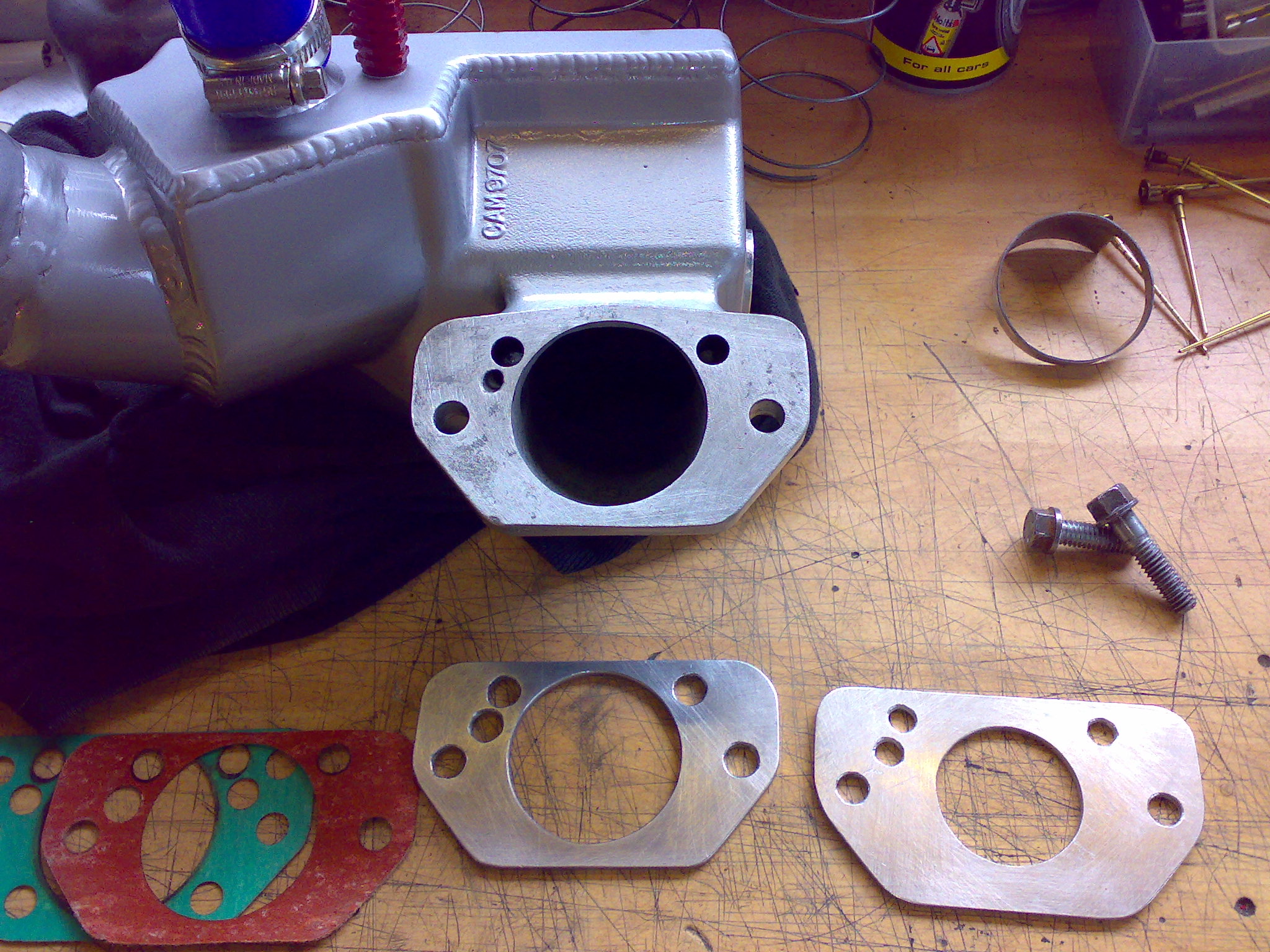

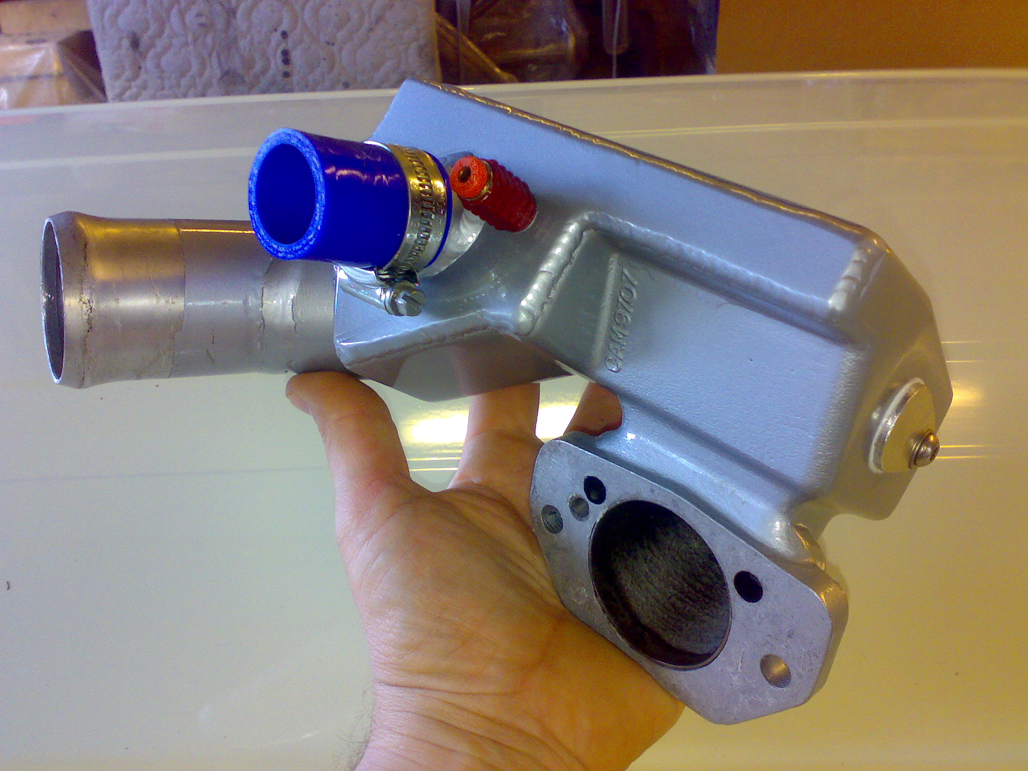

And sadly no, I sold the one I modified to Gav (Madcatminis) in June. Was a bloody good plenum tbh. As long as the 37 mm orifice plate was used to give a slightly raised upstream pressure ahead of the carb. This 'upstream pressure' is needed to feed the float bowl via the drilling alongside the usual two plenum to carb holes. Without the orifice plate, the engine will stay lean when the boost comes on as the fuel pressure will not rise in the bowl above boost.
Here's a pic fitted and off the engine showing the mods I did. Two plates fitted (one being a straight through and the other the 37mm orifice) meant the rear of the plenum didnt catch the dashpot and it was darn easy to get to the needle when doing dyno work.
Cheers.
Richard.

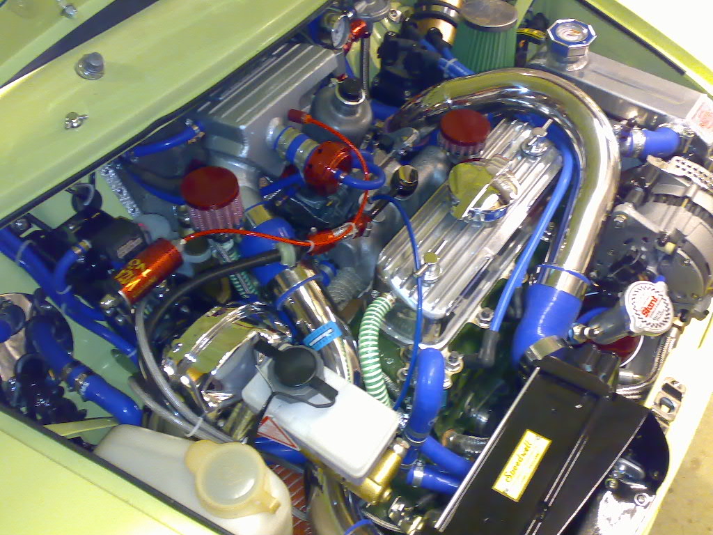

That engine bay is gorgeous, I'm on my way to find a build thread !

The plenum pictured above is a NON-Turbo plenum. The Monetgo turbo used the same plenum as the metro WITH the restrictor ring, but a different outlet casting for the IC.
You could do what has been done above, but better and easier to buy the correct plenum.

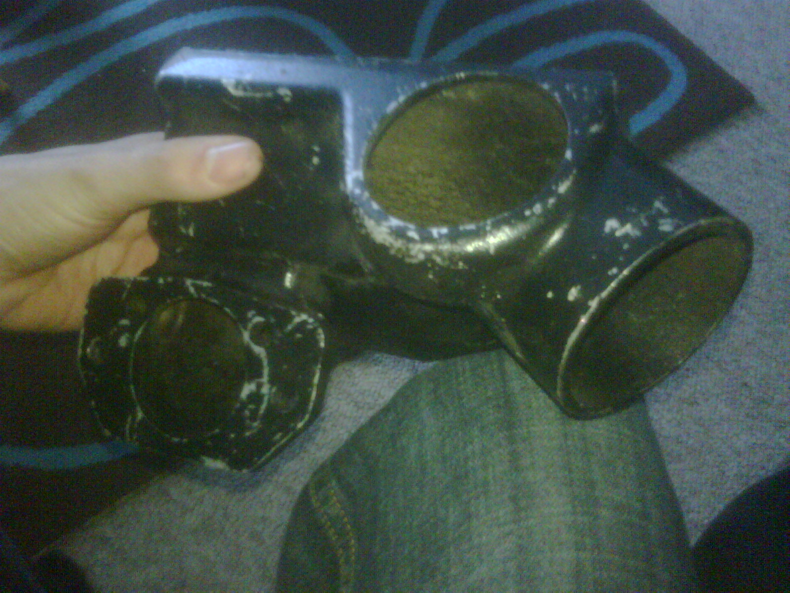

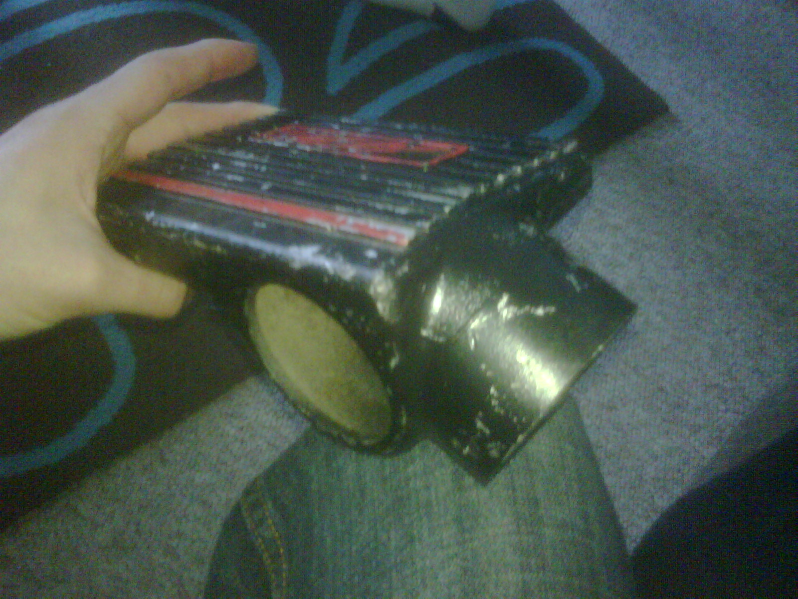

here the plenum, what peoples thoughts, worth modding? or just keep an eye put for a better one ie metro turbo
Get a propper one.
www.twin-turbo.co.uk
grainge231
13 Posts
Member #: 9216
Wil, know of anybody looking to get rid of one, can't seem to find them anywhere
turbominivanman
1105 Posts
Member #: 1504
Westbury, Wiltshire
Must admit. Seeing that black plenum does make me agree with Wil.
Probably worth getting a proper one or a stainless job from Nick Rizzardinis mate Hywell I think. Well worth it.
Good luck.
Richard.
