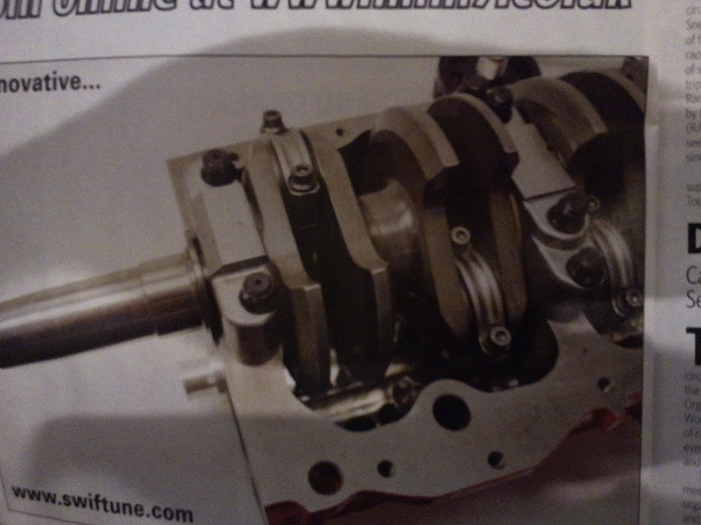

I'm wondering how they mount the 4th and 5th bearing?
Unless they don't, and just counter balance but i would think you'd get some flex then.
Be interesting to see a picture
Shaft seems nice and snug
the extra bearings could easily be 'bolted' into the crank case of the block from the sides. Consider that the original three bearings take for arguments sake 33% of the load. Now fit two extra bearings, they all now carry only 20% load. That is more than half the load the original bearings deal with.
I'm not sure how the cam would work around this though.

I'd suspect the extra journals simply float ?
If everything is designed and balanced up properly, then I guess they dont need support. The crank is likely over engineered anyway

They certainly are real.
The extra main pins are floating just so the counterweight can be increased and to line the big ends with the bores better

So are the 2 extra journals actualy bearing surfaces then or simply floating? says in the article is uses 5 main bearings or this just a terminoligy thing and im being a picky bastard? interesting non the less
David.
Asphalt
509 Posts
Member #: 1027
Germini, black forrest
Look at the picture Brett posted. It's a crank designed like a 5 mains one, but wears only three. For improofed counter baöancing. I think the '5 main bearings' sentence is just a bit missleading :)

So, forgive me if this is a stupid question, but given the revs which they're talking about (8000+), what advantage are we talking about over a well prepped steel crank and rods (given the likely cost) - reliability and life expectancy in a race application presumably?
If the major selling point were the smoothness that it mentions I'd have to question VFM.
thats the same arrow crank that MED are selling IMO
So basically they have developed a new crank
Looks clever.
a well prepped high reving 'normal' configuration crank will suffer from torsional vibration as a result of the lack of propper counter balancing, which could mean failure of the bearings or the crank itself, not to mention the loss of power as a result of the vibration itself.
If you ever get a chance to look at the super high reving motor bike cranks, you can clearly see that they are far from light, since they have excellent counter balancing which is one thing that allows them to rev to 16k+
Heavy counter balanced crank and super light flywheel is the way to go
Yes sounds the same as the one MED supply, apparently not much extra cost involved in relation to the gain.
