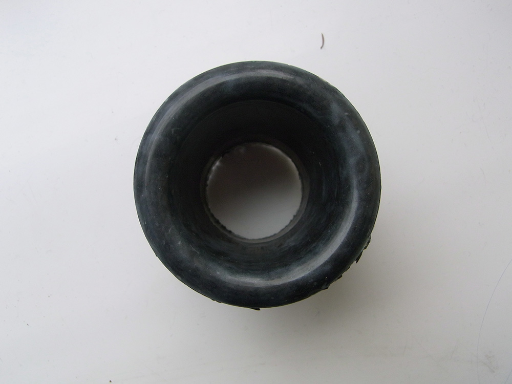

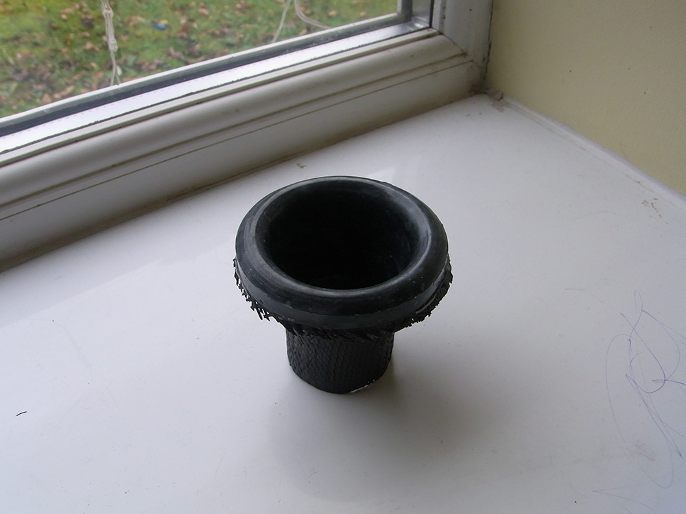

Well trumpets mainly.
1 down, some to go.

Wet lay up carbon.

I've been thinking about trying my hand at making a few odds and ends out of fibreglass. How difficult did you find it to make?

fg? piece of piss.. just very messy :)
Have you laid it on original ally trumpets?
Luckily Eric (Clan man) is an expert and has taught me well.
It is pretty easy, but it was much better to watch it being done rather than reading it in a book.
I have the rest of the plenum to make using various techniques and materials.
just realised i never commented, was that the first go? looks spot on either way!!
This one was the result of a master class. I'm half way through the second (they take 2 days to make) which'll be the true test.

Haha. 2-days per trumpet + the rest they're not something you could make money on. Which is why Eric has given me all the bits rather than offet to make it.

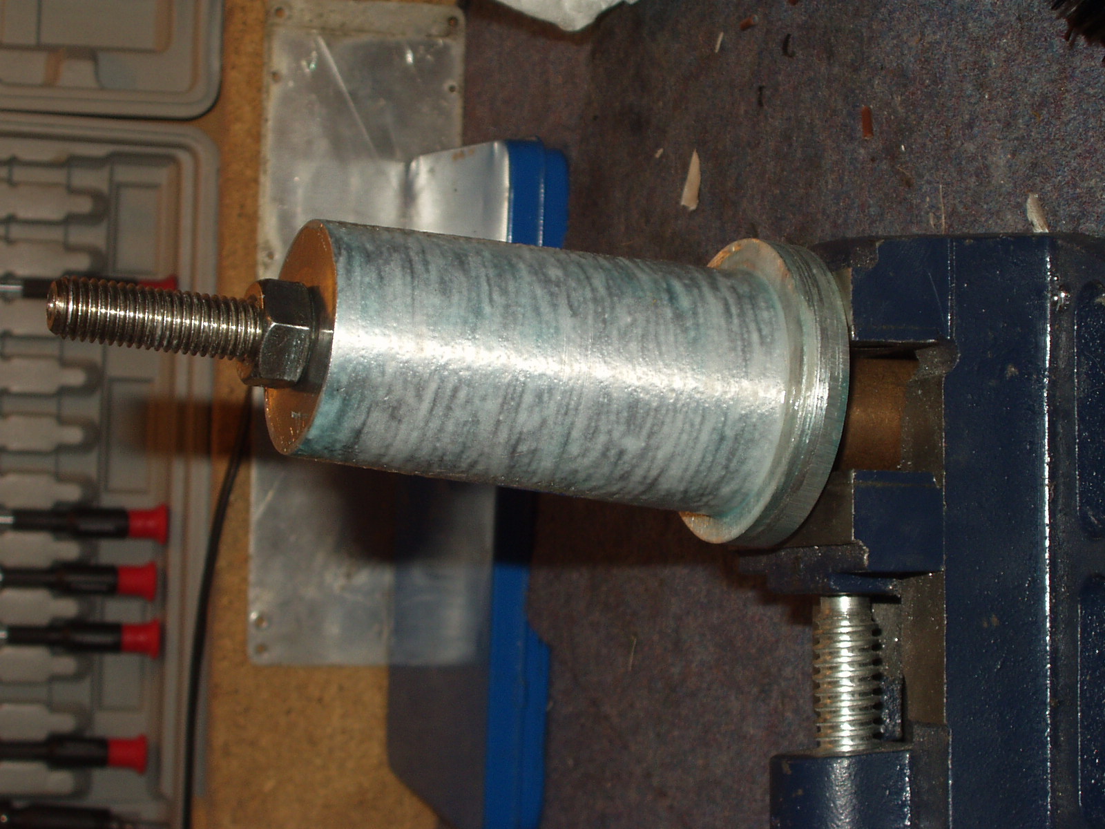

what did you use as a mould for these?
something a bit like this, but a slightly different shape. The photo shows it with a layer of gelcoat on.
