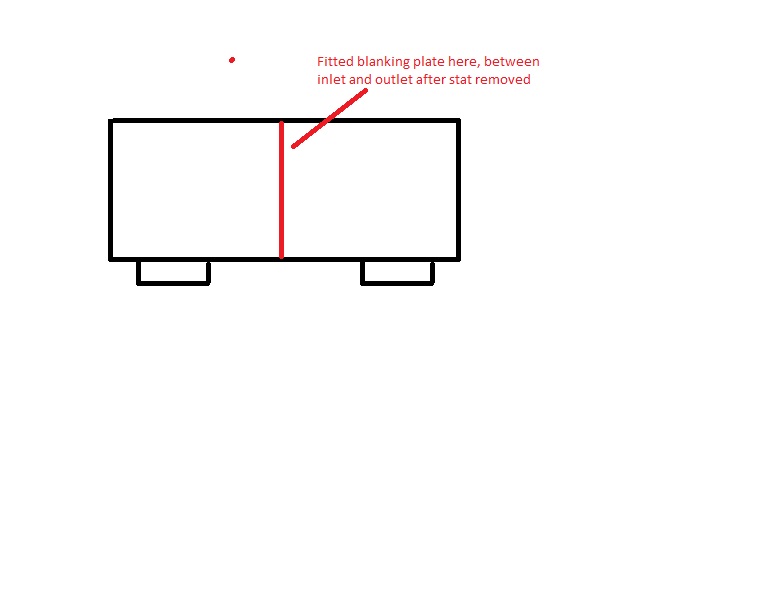

There's a flap between the left and right outlet, you need to blank of the hole left behind when you take this out.
Kind of like this...

I see. Thanks guys. Is it just a matter of bending the metal crips back holding the black cover on to get to the stat thing?
feature=mhum
Pretty much.
I think I just glued a 4mm strip off aluminuim accross the centre of mine and then sealed it around the edge with some RTV sealant.

I have kept that plate that moves with the stat. I drilled a hole and put a bolt through it, holding the plate in the open position. I didnt have any gasket seal but as the drilled hole was quite tight, i used super glue. I also glued the thread and nut and then wrecked the thread to limit it coming off
Then i butchered all the original bits that were in it. The stat, springs etc slide the plate under the locking bolt and glued the hinge area of the plate and glued in the screws
To get the plastic housing off the body of the i/c i used a screw driver to flick the 'claws' up round the edges and on one length. So when i put it back on all i had to do was angle it in under the claws i didnt lift, the lay the i/c flat on the work top and while pushing from the plastic end towards the wall, went around the bottom edge of the claws with a small tack hammer then used some pliers to grip them back into the plastic housing. With all the other bits of crap removes, i guess it should flow better aslong as i have a good seal.
Bit of a bodge but got there in the end. Thanks guys!!
