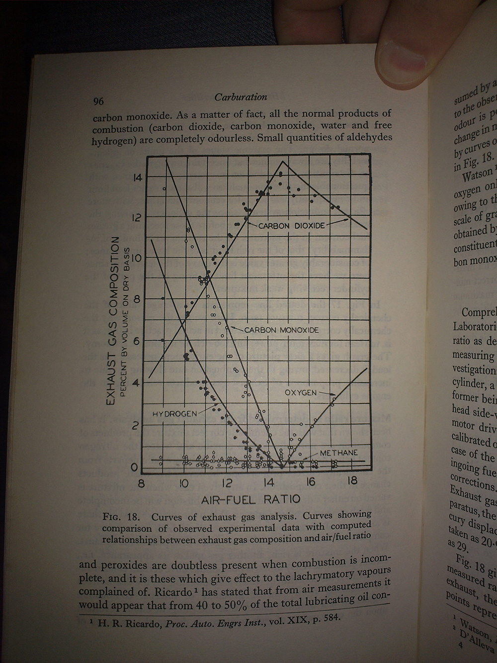

an interesting 5 gas graph.
That's really interesting Joe.
Although setting your fuelling to 15-16:1 AFR at the critical points for MOT purposes has always been my aim.
When you look at that graph and the requirements in the first post. It is apparent that if you have one, you'll meet the rest.
What that graph cannot show however is the inefficiencies of an internal combustion engine, even with an ideal combustion, there will always be a HC volume in the exhaust as a result of the general desing of an piston engine, which is why there are cat converters. The amount of HC should be minimal.
The thing with programable fuel injection is getting the injection angle, ignition advance, lambda and volume of air right to ensure a quality idle with as low emissions values as possible. Any one of those will have an effect on the final result. As has already been suggested, cam profile is a big part of achiving those emissions pass results. If the emissions are so tight, I would suggest either the SW5 cam, Kent 274 or the Kent 274SP, giving you a better chance. Any wilder and you are in danger of flunking the emissions test. A sports cat will also aid things. Removing the cat completely will only make it that bit harder every year to pass.
