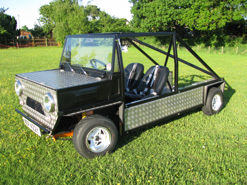

This is my Scamp ! soon to have a turbo engine :)

a scamp will fly with a turbo engine in it, like your wheels too

I like the mirrors

love it...get it turbo'd!

The mirrors look good but are not very useful !! as for the Turbo engine, its in but just some final bits of plumbing and wireing to finish, I also had to convert to disc breaks on the front as didnt think the drums would be a good idea with the added BHP . The good news is as there is so much room in the engine bay I have been able to put a massive intercoorler in !

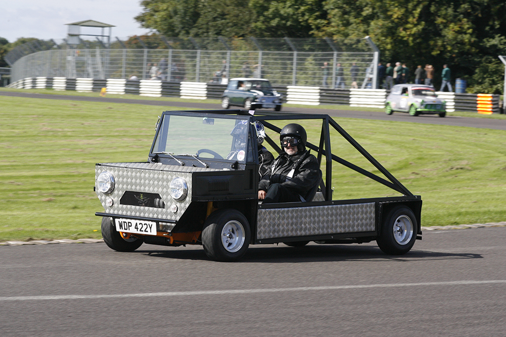

Looks like it get driven hard. ever fallen out?

I have never fallen out thanks to the harness but I am having to replace them as they broke when cornering to hard !

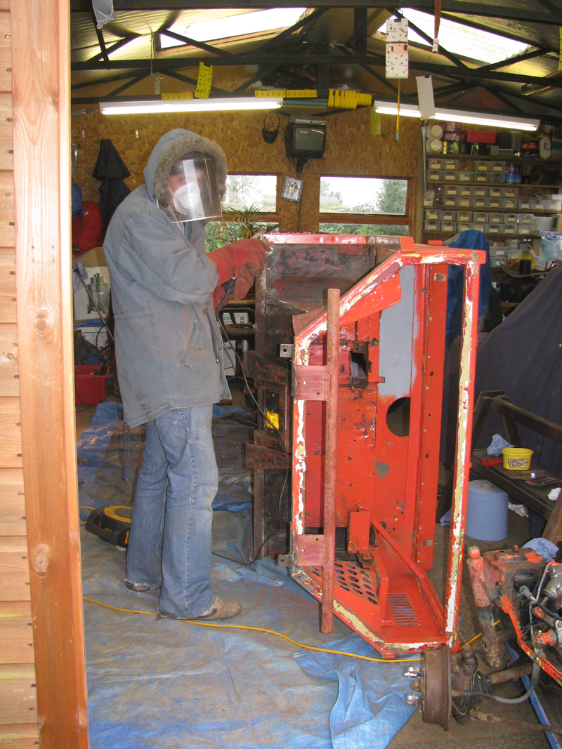

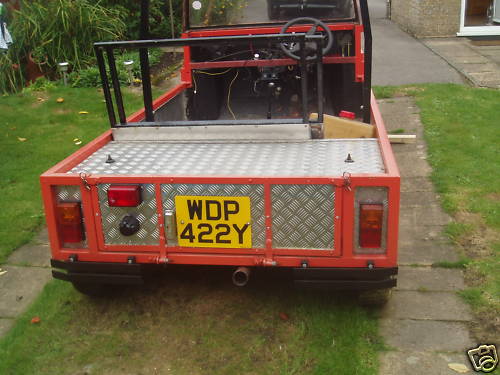

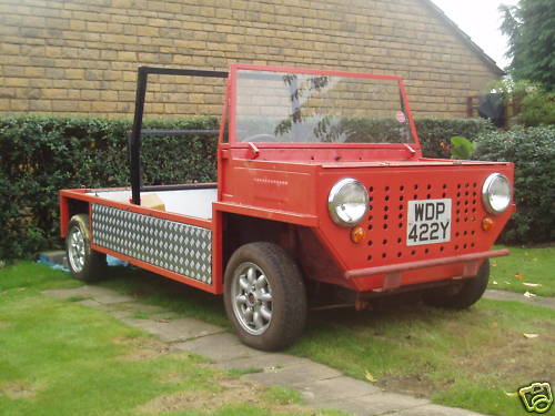

I have some pictures of when I first got it !
redrat
328 Posts
Member #: 9107
Devon
And some more ...

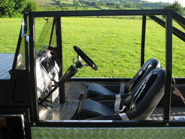

You got balls driving that without having door bars so to say, would love a scamp but with a clubman front end dont k ow how it would look but would be so light *smiley*).

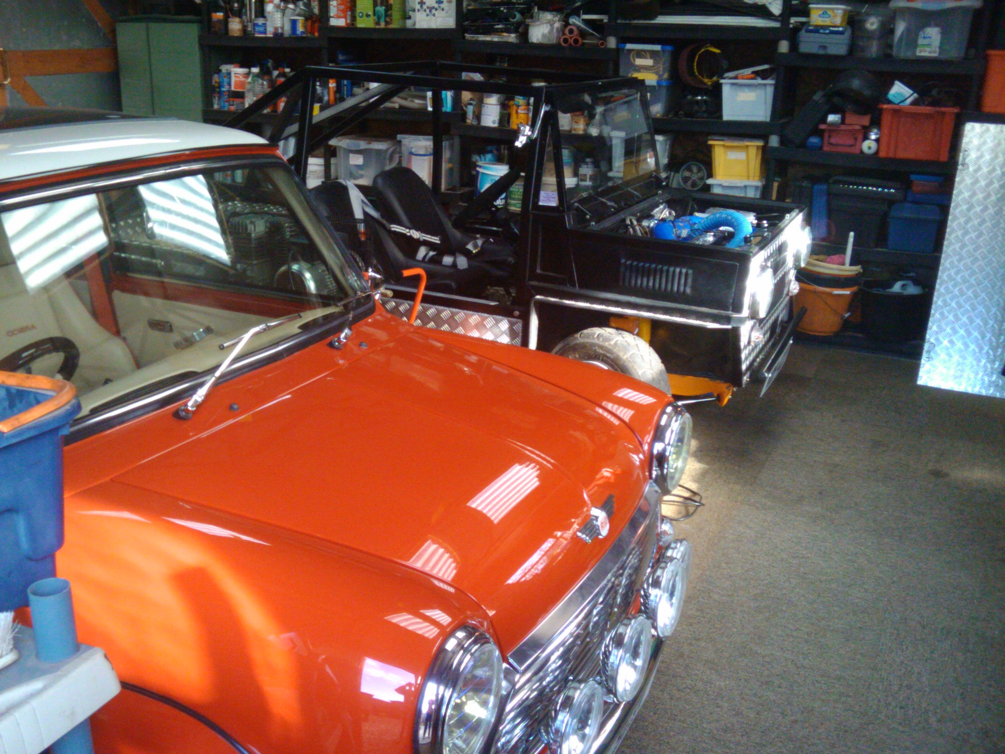

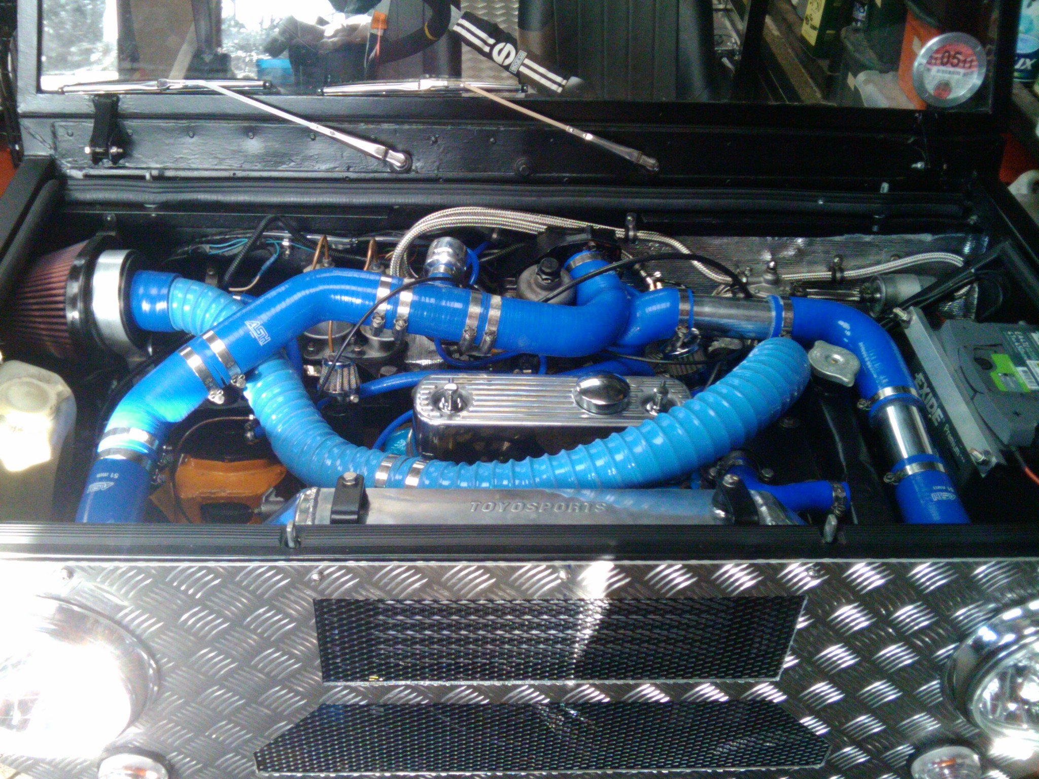

Got the turbo unit installed, just the final plumbing to do and find a spot for the intake.

Just to give everyone an update I now have the turbo engine installed and running, all be it with a few problems and tears *tongue* , still after a few miles to adjust the boost and fuel pressure I have managed to give it some welly and all I can say is Fu*k me its fast ! it should have a top speed of 90 as I put a final drive in of 3.4.1 which means 1st is just silly 2nd just spins and 3rd leaves you with no breath . Its a B road monster , well chuffed and have to say couldnt have acheaved this with out the help of the forum . :)

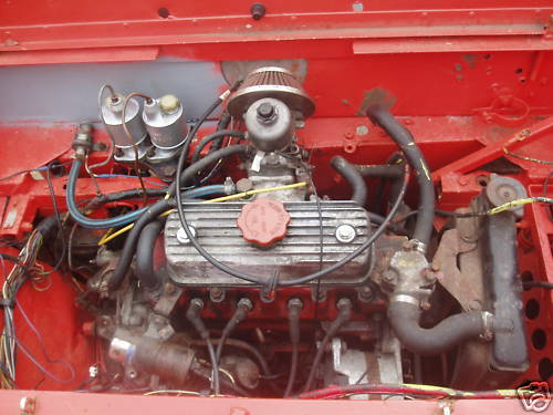

Just an update with some pics *smiley*
redrat
328 Posts
Member #: 9107
Devon

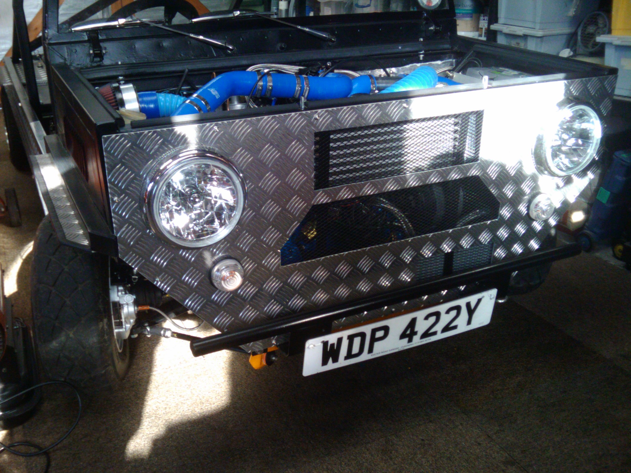

What do you peeps think of the general layout , have I got everything right ?
Edited by redrat on 21st Mar, 2011.
analogue_radio
275 Posts
Member #: 4600
Melton Mowbray, <BR>near Leicester
Tidy!
What's the preference with the checkered plating? not just you, i've spotted it on a few kit-car based projects, isn't it incredibly heavy?
redrat
328 Posts
Member #: 9107
Devon
Its alloy and doesnt bend or dent easy so ideal for kit cars. We used a mix of 3mm and 1.5 , the 1.5 is much lighter than steel. Its very expensive to buy however I managed to get a deal with a local steel workshop *smiley*
