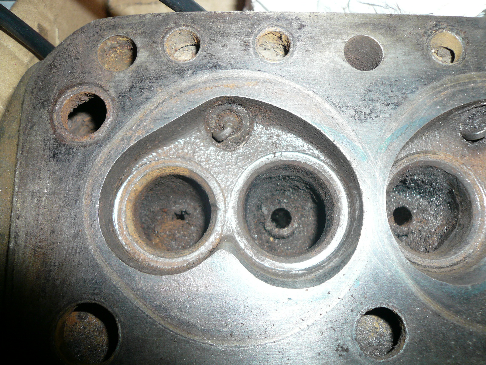

Hi gents,
I started modding a 202 that I bought for the deerest sum of 20£.
Here it is as I bought it :
As the perfect newbie, I worked the chambers before noticing the ports are in pretty bad shape, particularily the centre exhaust port.
At first, I intented to reuse the valves so I cleaned the first set then I noticed one of the exhaust port is shot.
This head is intended for a N/A 998 pepped up on the cheap.
But I can't make up my mind about the exhaust valves, keep the standard size valves or go OS.
OS means I'll have to have the seat recut.
Also, I have no idea if the OS exhaust valve is required on such a low power application ...

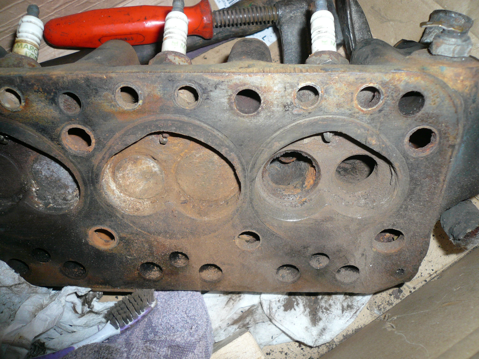

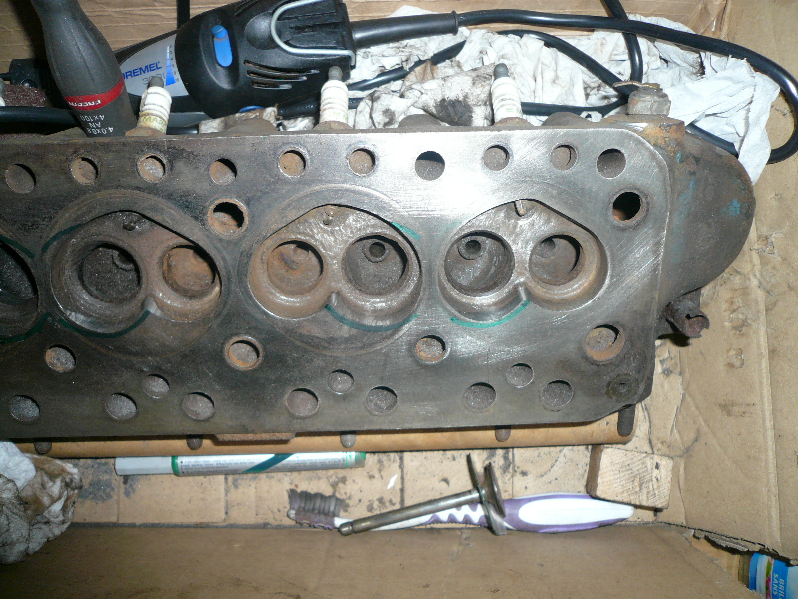

Ho and day 4 pics by the way :
Shall I mention all the work so far has been carried out in the kitchen ?
And the weight of the head is 12,8 Kgs and I was planning to gain some on that.
We'll see how the seats clears before going any further.

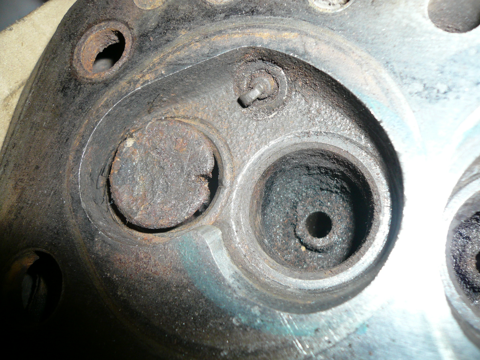

Advantage
1137 Posts
Member #: 1450
Near Paris - France
The seat :
Freaky combo : valve and seat !
