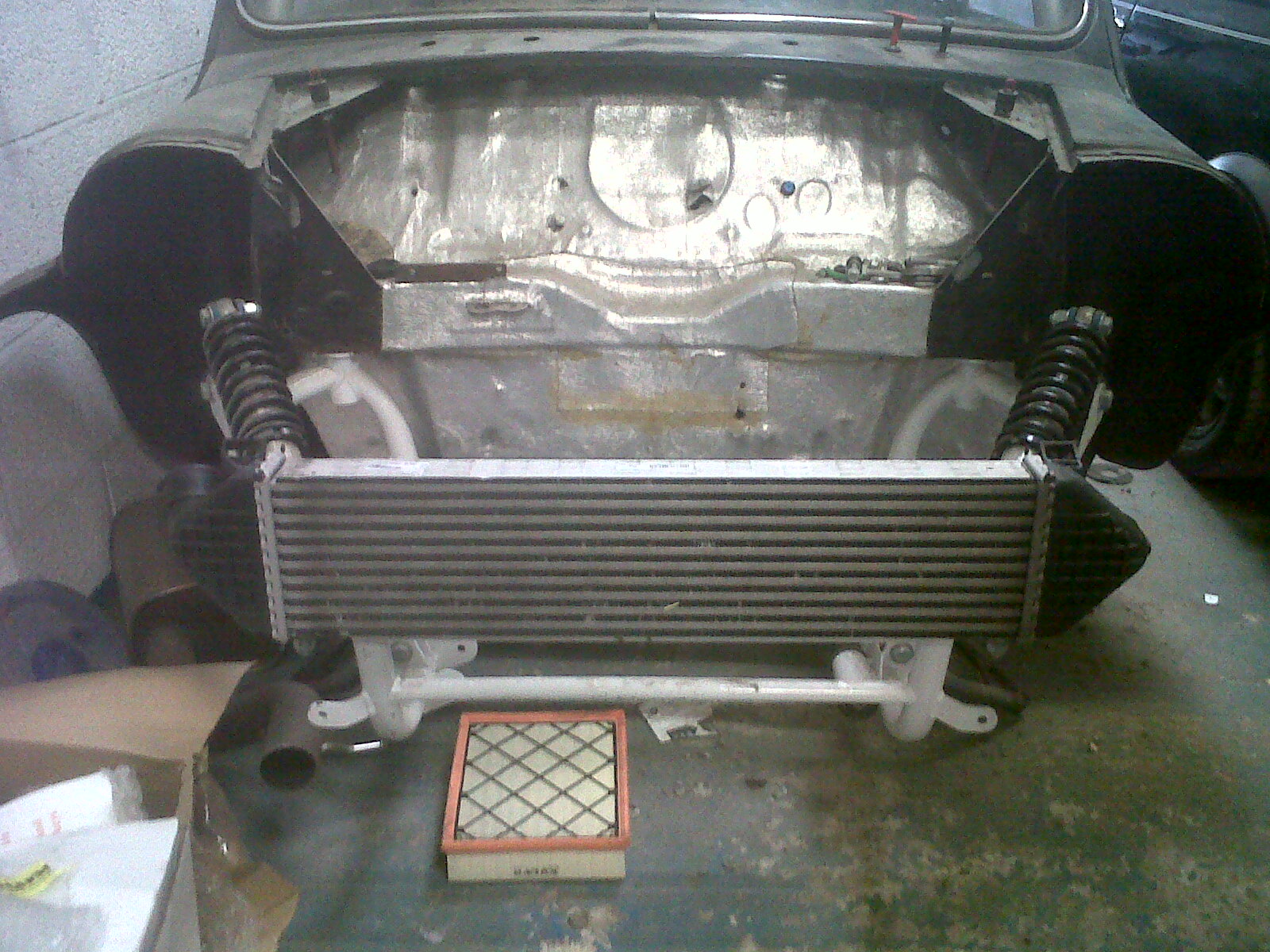

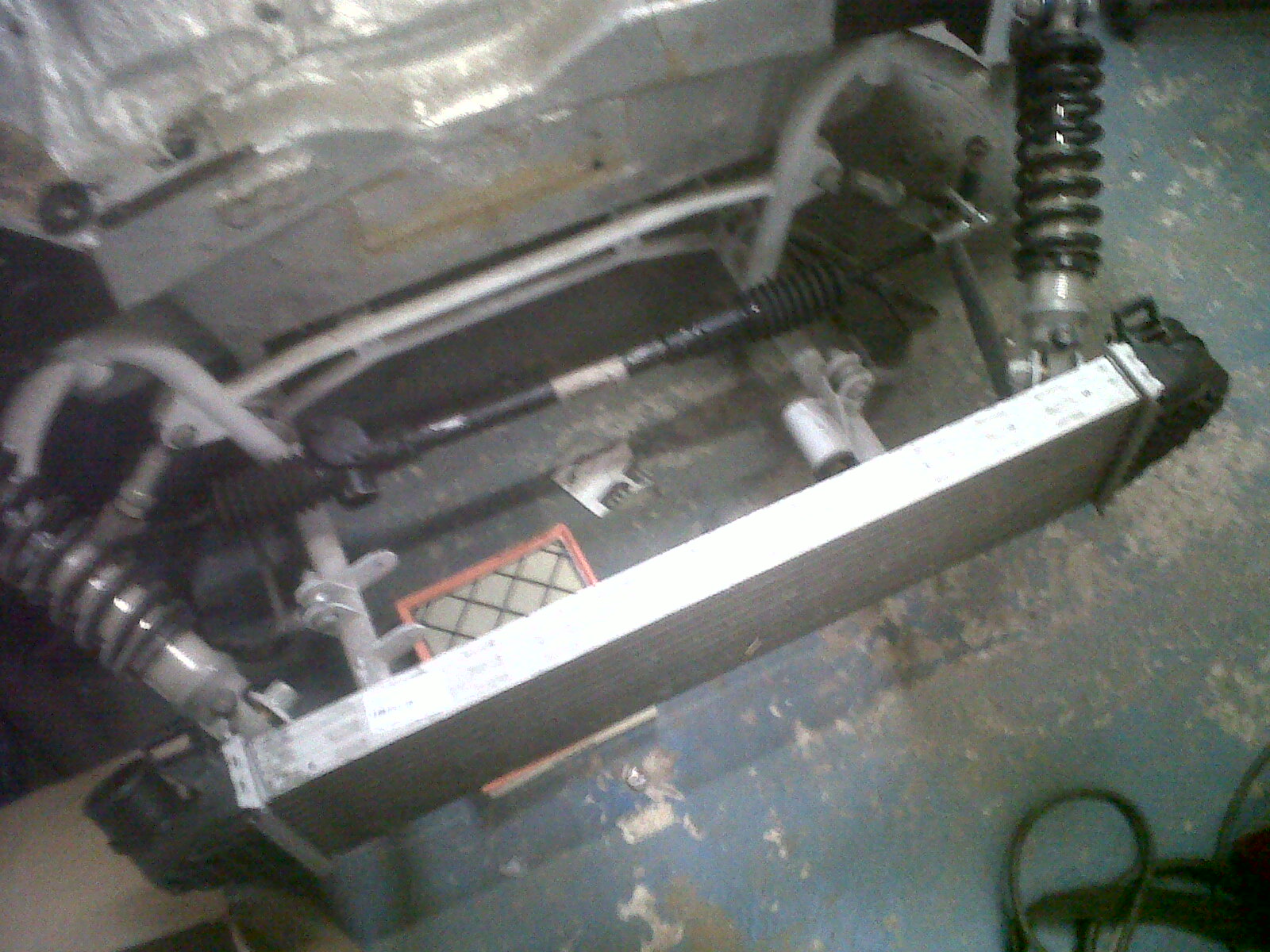

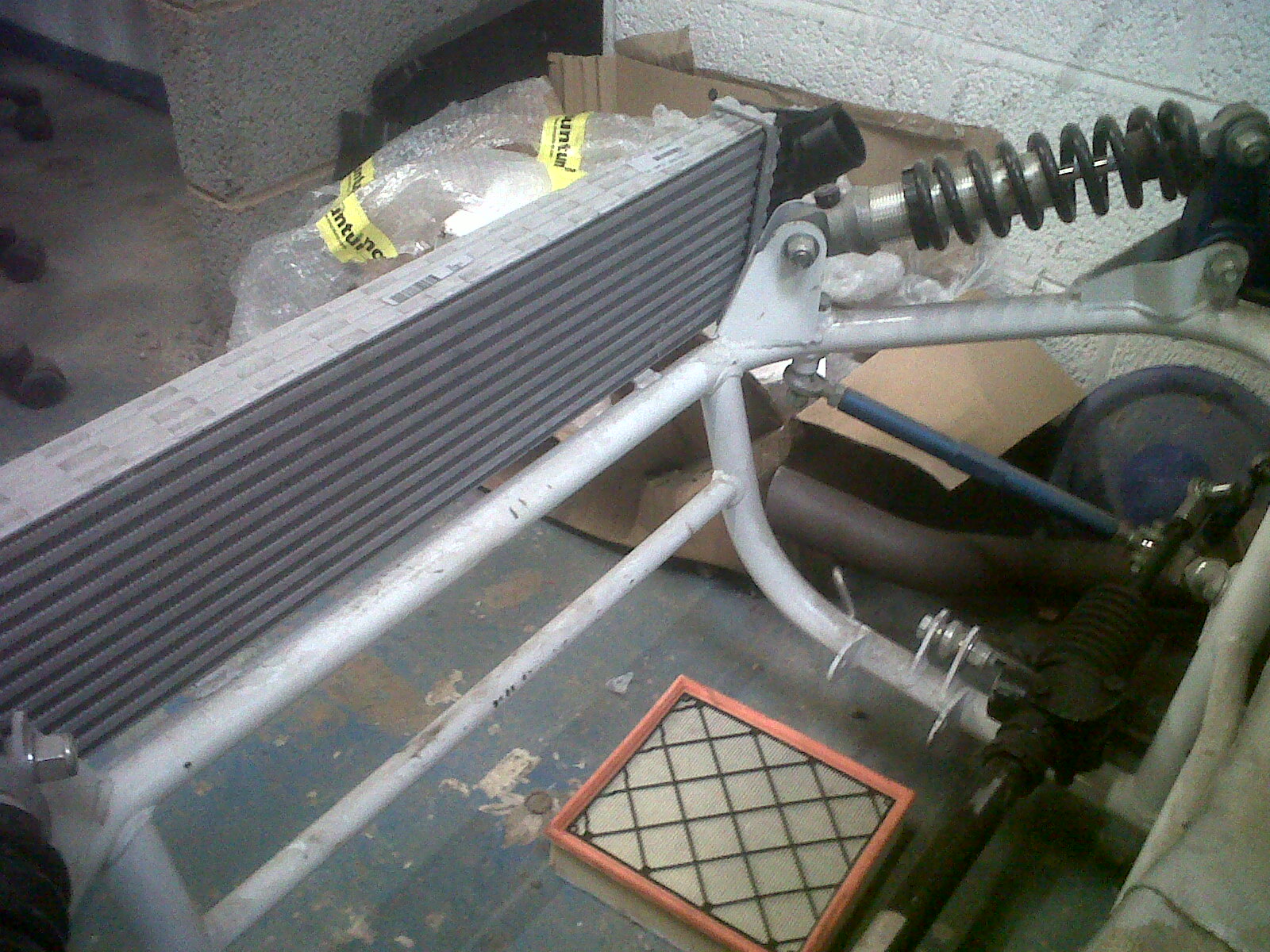

Looking to find a IC to fit onto my racecar.
Does the size / depth of this look ok for a turbo 16v motor? Around 200bhp hopefully.
Seems to fit there like it was made for the job, but unsure if its too small. Im not that clued up on turbo stuff to be honest
Chris
That looks like a focus ST/RS one. I looked tahthese, but thought that it was a bit big to fit where I wanted it.
That's the only reason I didn't use one, otherwise they are a decent size.
You back on your short stroke then?
www.twin-turbo.co.uk
01smartc
400 Posts
Member #: 2563
Tamworth
Yes its std ST cooler... given to me by a customer who went for mountune kit.
It seems to fit really well on the zcars frame and flows enough for 225bhp std.
Yes im back on the short stroke, got rid of all the racers for this season so might have 5 mins to myself again!
