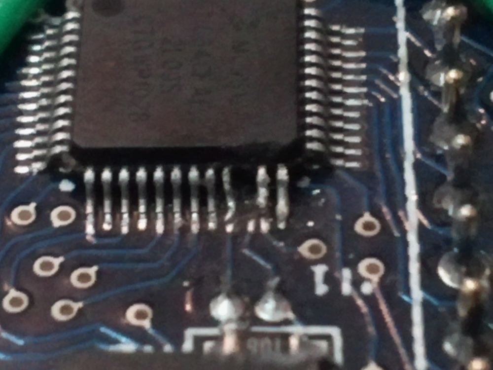

i was soldering the map switch over cable onto the ms ecu ( after everything went so well) i managed to solder the pin next to it too :( then the third trying to clean it off the 2nd. i tryed a crafts knife too but gave up before breaking something
any one have any tips :)
i think they are still joined :( dont want to fire it up in case it damages something

Solder sucker wont take that off, you wont get the seal to suck it up.
You need to clean the tip of your iron so its clean clean, no solder on it at all. Put a little bit of flux on the solder joint and heat 1 pin at a time, starting at the body of the IC and slowly dragging the iron away to the leg tip, dont what ever you do put pressure on the iron just allow it to drag under its own weight (assuming you are using a decent bench top iron not some behemoth monster!). Some of the excess solder will take to the iron hopefully removing enough to make a decent solder joint on one leg.

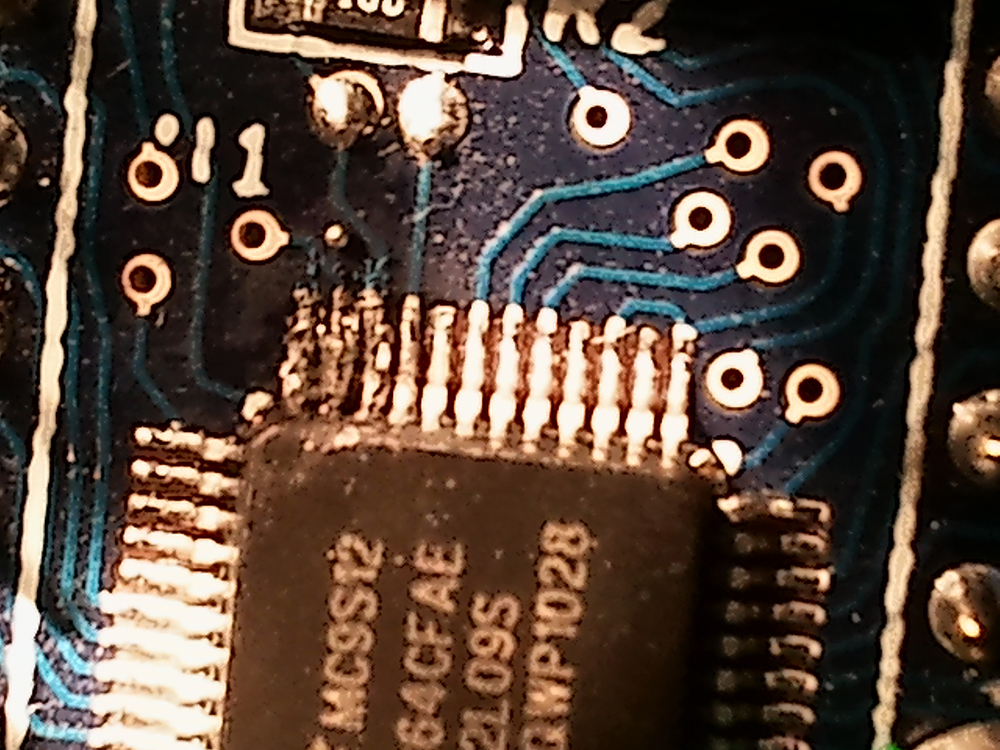

think i have properly fucked this now :( got the solder cleaned off quite nice but the megasquirts 3 led just light up when its powered on it doesnt do anything else

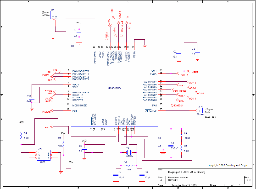

anyone know the pin layout on the c64 processor? i have pulled a pin out :(
XTAL probably the best one to break :(
cant quite see from the picture but i think i can tag a wire to where the pin went, well i have nowt to loose now soo...

Brett,
I can certainly change the Processor for you,
But, I seem to remember that it needs some form of boot code loaded in before it can e programmed which is a bit specialized for me, I might be thinking of the MS1 processor though.
maybe Jean can enlighten?

You need the bootloader code and a BDM to program a new CPU.
I think that James Murray (jsmcortina) can repair and reprogram the CPU on an MS2 card.
