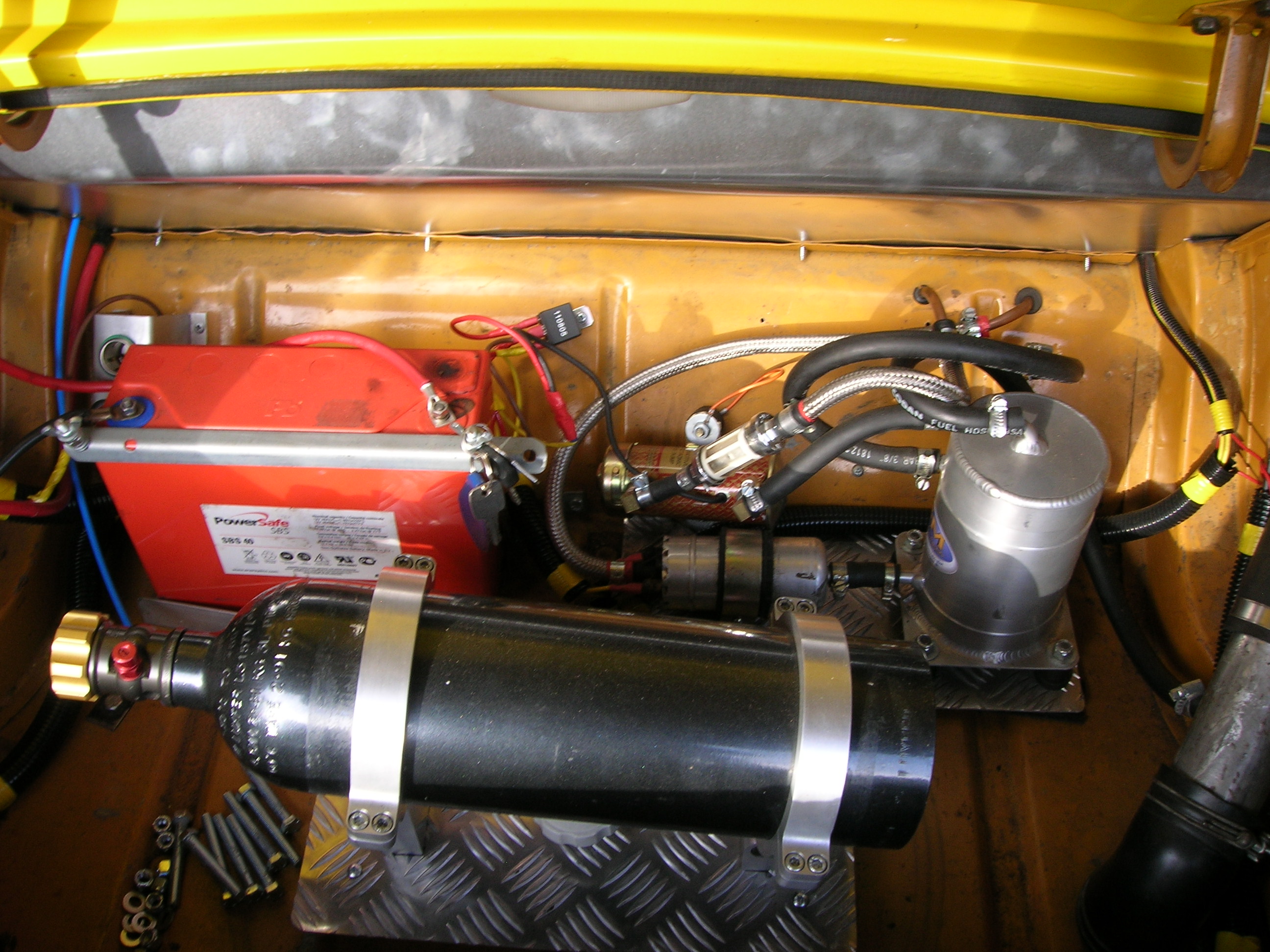

My swirl pot set up looks like this

I prefer the NOS tank to the swirl pot !
Your swirl pot seems to be identical to my oil catch tank
