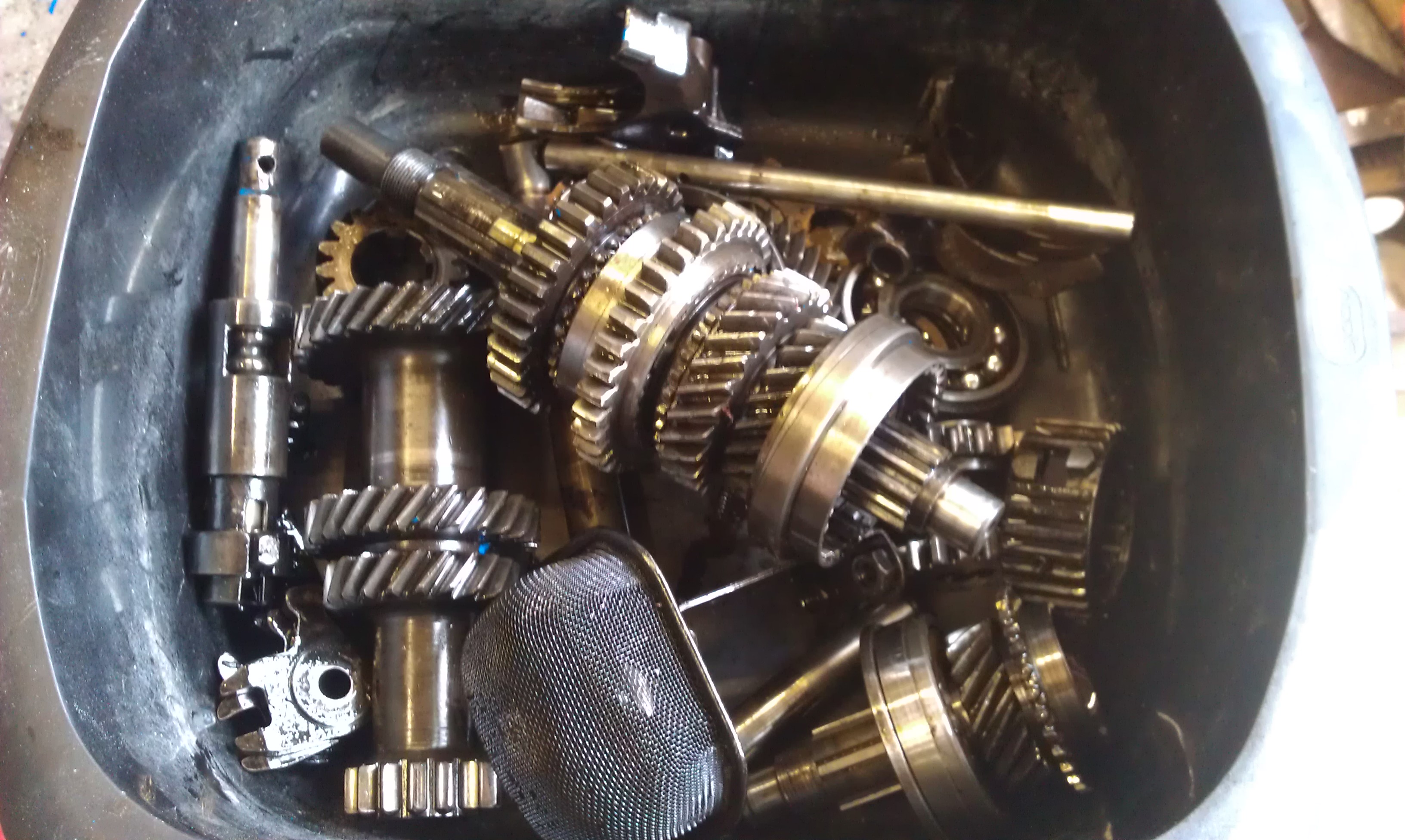

SO!
Good news: First motion shaft out eventually!

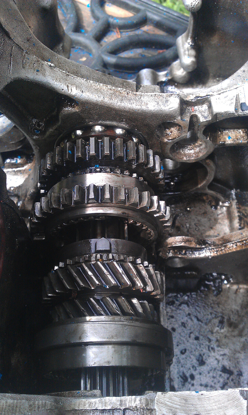

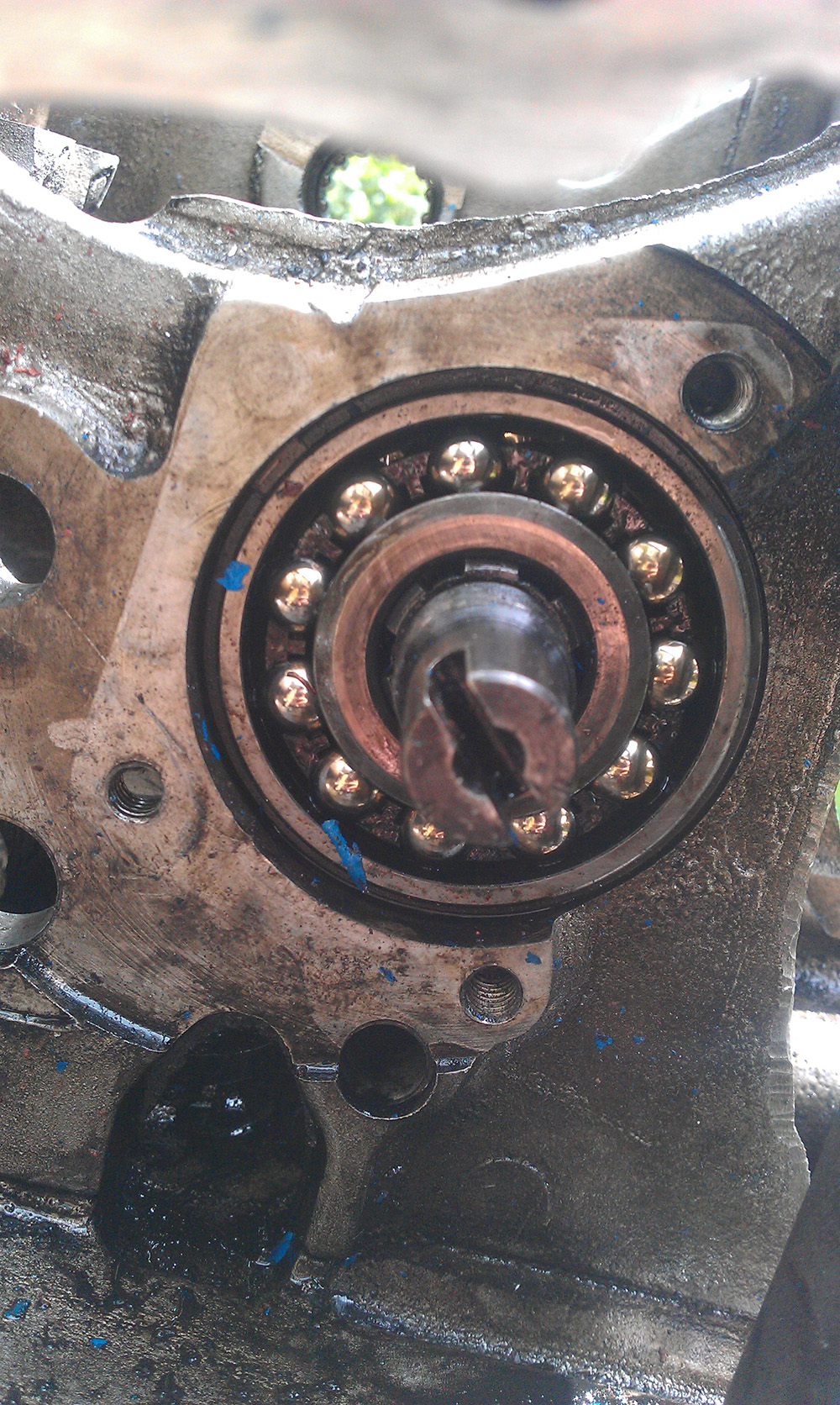

Bad news: I can't get the main shaft out because I think the mainshaft bearing it preventing me from pulling it out.
I can't get any angle on the drift to force it out with all the gears in the way.
Should the shaft just pull out or is it necessary to get this bearing out first?
Some pics of what i mean:
Edited by carts60 on 8th Jul, 2011.
It is neccesary to get the bearing out first.
As you say, it is hard to get at the outer race to tap it, best way I have found is to tap the whole mainshaft slightly the other way to take the gears away from the bearing (not too far or the selector rings may move too far on the hubs sending balls and springs everywhere) then put a hardwood spacer down between the mainshaft and bearing and tap the mainshaft back towards the bearing so the hardwood spacer starts to push the bearing out. You may need to do this twice with increasing thicknesses of spacer.
There are other ways but that is what I have allways found easiest.

Unfortunately Rod, I'v already sent balls and springs EVERYWHERE. All over the garden and i'm never going to find them again. Can that be rectified?
Ok so just use a spacer to push it out against the gears.
I'll give that a go now

Got the bugger out at last. Heated up the casing and just kept on bashing with my drift.
Couldn't find a suitable spacer and all the things i tried kept on falling off.
Sadly, the bearing is no more. It got halfway and decided it wouldn't go any further. Drift wasn't working so broke out the pry bar and smashed the thing out the other side.
Now to remove the selector forks and selector and then I can actually crack on with cleaning the box up.

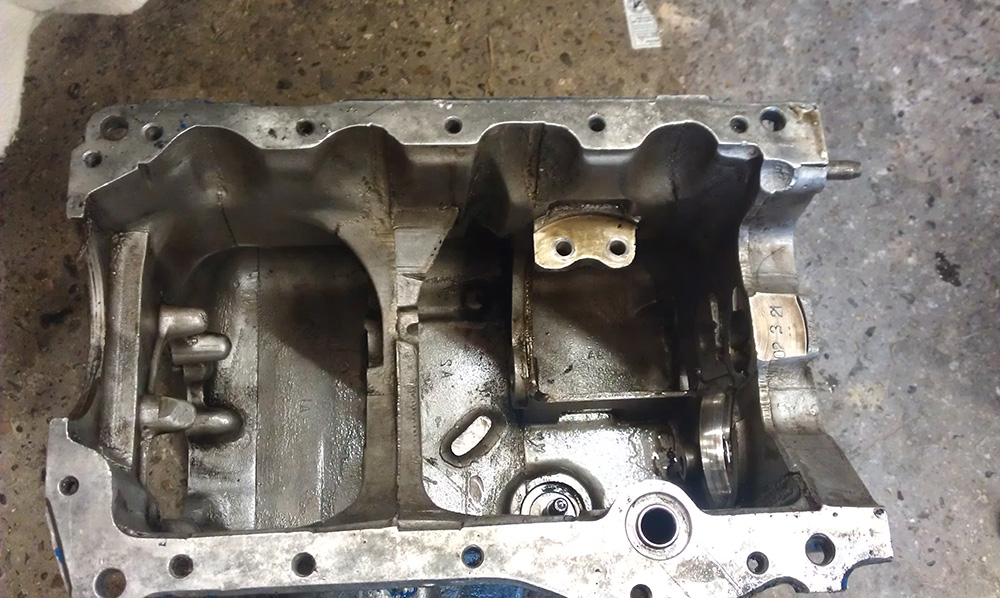

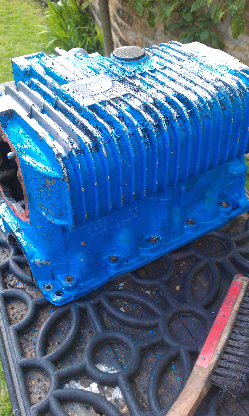

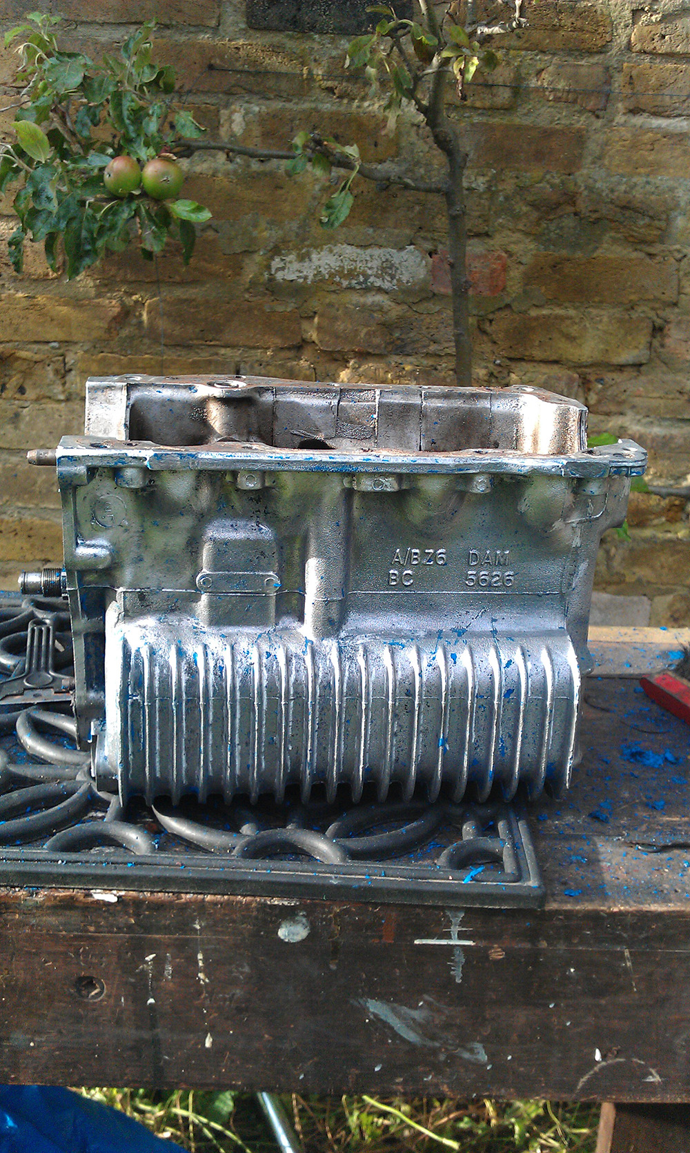

Jobs a goodun. Not like it took me a week to disassemble. Was my first time though. Gearbox virginity out the way. Stripping her down should be easy next time *hehe!*
Started off caked in terrible flaking, god awful blue paint - which bits had even got into the gear teeth, every single thread and most bearings.
Now totally stripped, 99% of the paint gone and just looking much much nicer. I'm also left with a washing up bowl full of bits in need of a tidy.
Wish me luck for the rebuild.

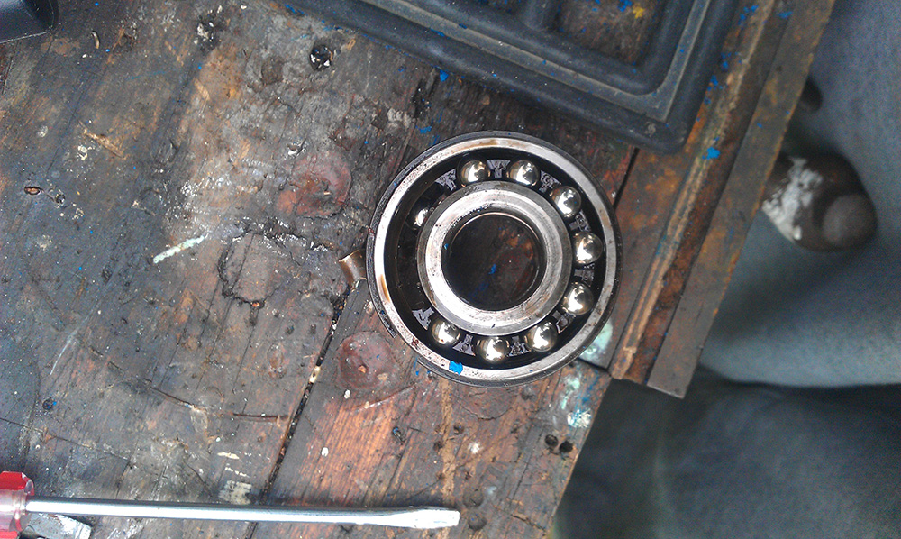

Is this the mainshaft bearing i'v ruined? Costly mistake if it is!
http://www.minisport.com/mini-spare-parts/info_AAU1365.html
Edited by carts60 on 9th Jul, 2011.
Yes, yes and possibly.
For the bearing, personally I would fit the genuine RHP one,
http://www.minispares.com/Product.aspx?ty=...id=35662&title=
They are the weak point in the gearbox and, yes, an expensive item to damage.
