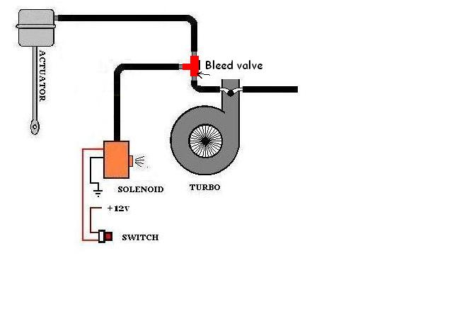

I've had this diagram on my computer for some time
with this setup you need a solenoid with one input, two outputs
how can you do two stage boost with a solenoid off a metro with only one input one output?
isn't it just like an on off valve in the line?

set your actuator to the lowest boost pressure then have a simple on-off solenoid to have your "high boost" setting.
id use a bleed valve before the solenoid to fine tune the high boost setting *smiley*
iain
8506 Posts
Member #: 16
Near Lincoln
in fact thats what's above... that has the exit from the wastegate T'd into two. with the one bleedvalve open its low boost, open the solenoid and it "activates" the 2nd bleed valve to a higher boost setting.

take it the nedle valve is a bleed valve, are they not missing another exit as most have 3?

Does this pic help?

Its no good having to pipes in parallel Mark, you will only see actuator pressure, unless you have a solenoid in each line, so that one shuts as the other opens.
Its easier to do with a bleed valve rather than an MBC. As you can use 1 simple solenoid.
To use the MBC i think you would need a 3 port valve or 2 seperate as I said above.

sorry about this i think im being a spaz..
makes more sense with a bleed valve.
so i need a 2 port solenoid and a 2 port bleed valve? the bleed valve will sit after the solenoid then just vent to atmosphere set at the desired boost level?
think most of the bleed valves i have seen have 3 ports..

Still think my way is the easiest lol :p

Cheers - what i couldnt undersatnd was where the other side of the bleed valve went.. on a 3 port valve i always though the needed to go in line.. but as your pic shows 2 of the prts just vent then?
thanks again.
Kean
2406 Posts
Member #: 341
aka T2clubby
South Staffs
Yes, just think of it as a leak point.
Yes it probably is, but I didnt see that pic until after I posted lol!
