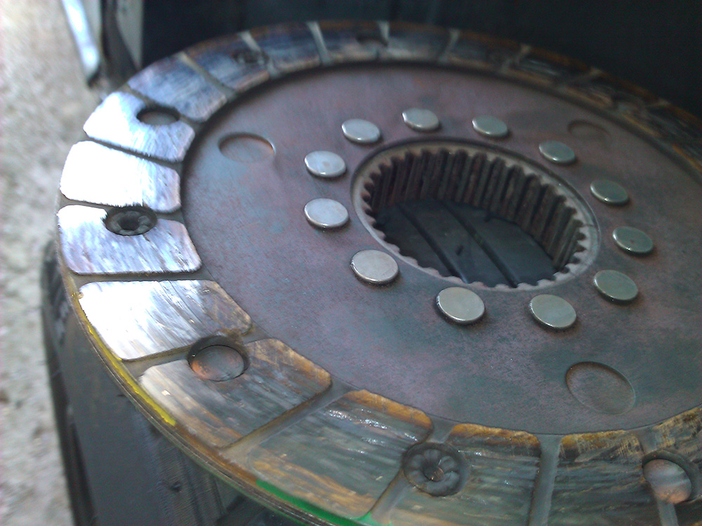

Clutch is glazed to hell, but there's plenty left on it, i think the problem has been oil? See what you lads think as i can change it now while i have chance.
did it judder on take up?
if not I'd whack it back, rough up the back plate and fly wheel with a bit of wet and dry though,
What do you mean joe?

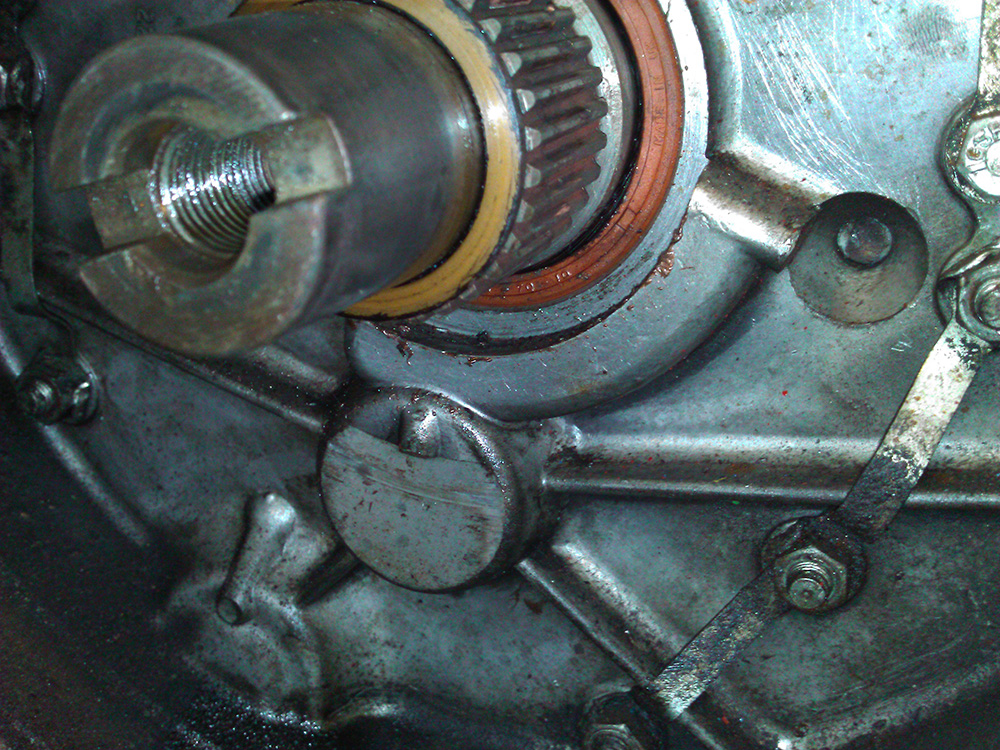

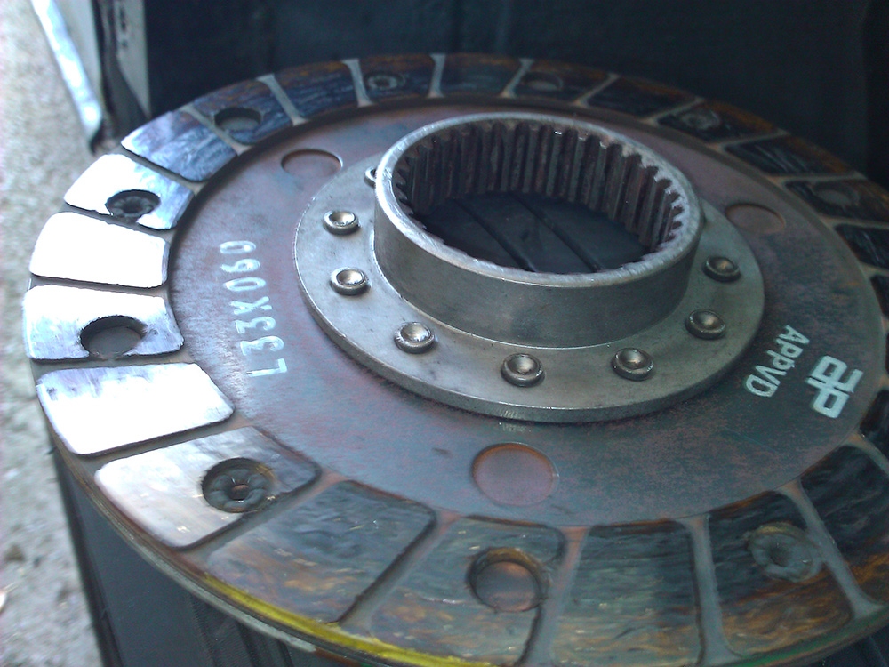

Its never juddered but occasionally it slips like a complete bitch, which is why im doing this now, i have a new clutch plate (ap updated same as what came off) and an orange diaphragm to put on instead of the green, reckon my oil seal is okay?
ah if its been slipping I'd go with the new plate,
it dosent look that oily in there, but is does look like somone has been a bit overzelous with copper slip on the clutch splines, could be that on the plate.
if the seal isnt oily give the housing a going over with gunk and a blast with brake cleaner.

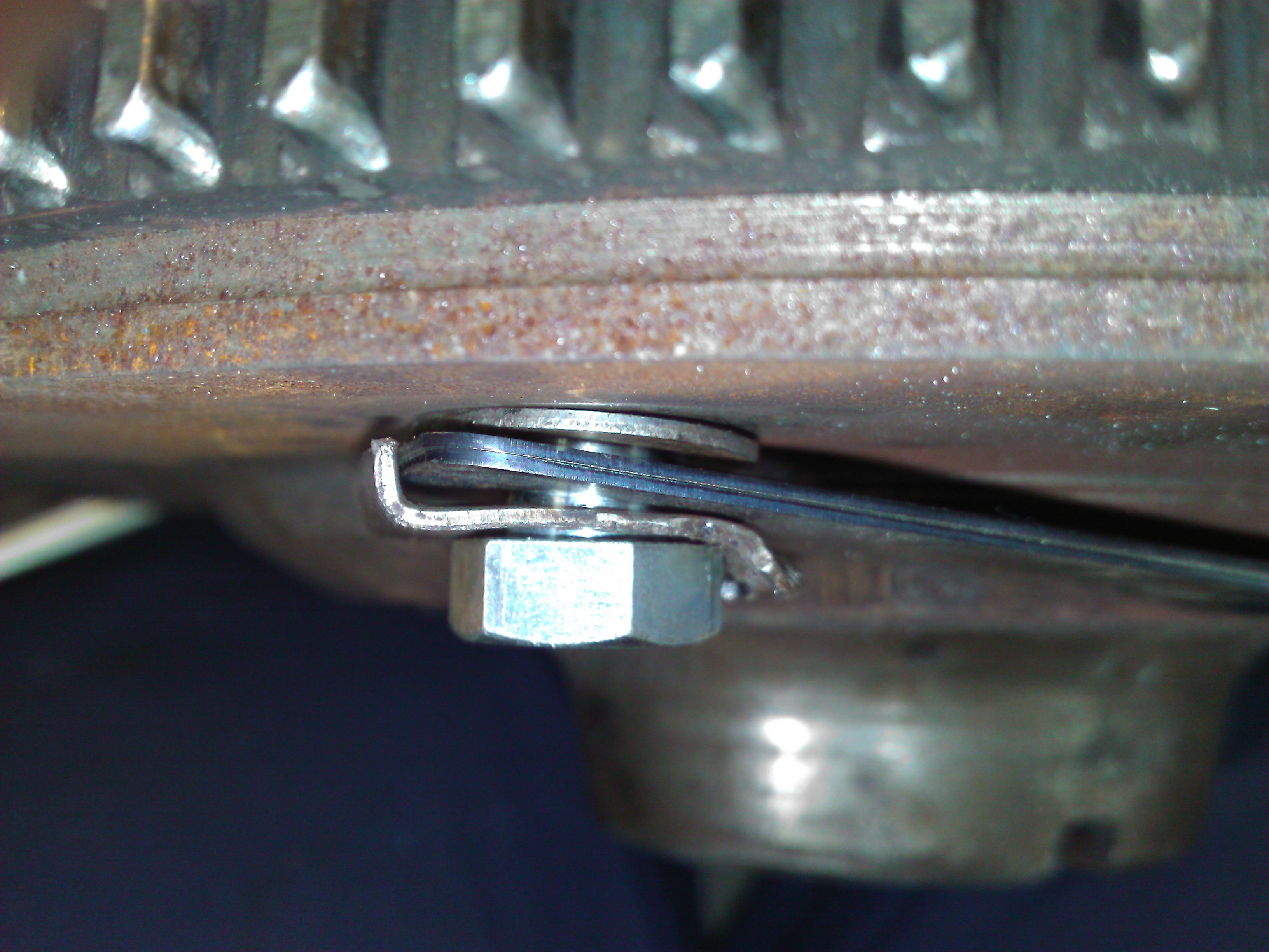

Is this right? I bought all new nuts and bolts and stuff cos i didnt know what i was going to find.
These drive strap bolts have a collar on, and the ones i took off didnt, and were something of the same thread without a collar, and the straps and locktab were tightened up against the fly with almost no play. I wanna know what im doing now is right before it goes in. No reference in haynes to this particular area....
On lightened flywheel's the flywheel is thinner where those bolts go thorough, so to get the straps sitting flat they end up with spacers/ washers under the straps,
So on a standard flywheel, what ive done there is okay?
I think so, IIRC the std setup has on washer under the straps (anyone?) but basically see how flat the straps are when the flywheels bolted together,
If I am reading that picture correctly, that is how you have installed the bolt, straps and lock tab and bent the lock tab over? is this how you intend to install the flywheel and clutch as we see it in the picture?
The only reason I ask is that those straps are not seated on anything, the washer underneath is loose and the shoulder on the bolt looks like it is bottoming out.
Ah,
I missed that,
add anoter washer or two so the bolt dosent bottom out.
