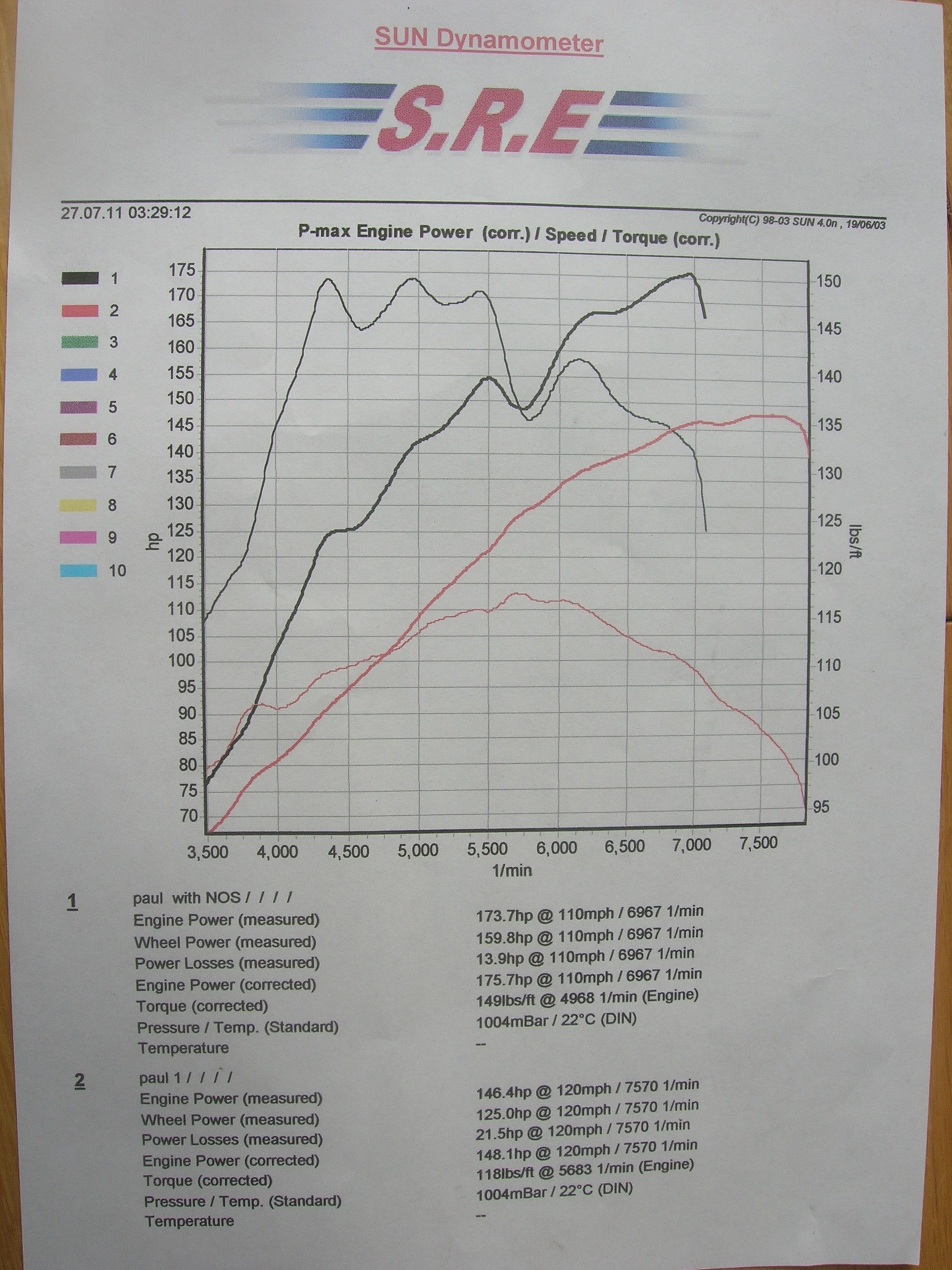

Engine Spec
1330, Forged Omega's, lightened and balanced rods, cross-drilled, balanced and hardened crank, duplex timing gear with vernier adjustment, cylinder head- VMax Scart 29cc chambers, 1.5 tightened roller rockers, 7.5:1 compression, 286 Kent cam, maniflow 3 into 1 exhaust, Eaton M45 Supercharger, weber 45 dcoe carb with 36mm choke, ZEX nitrous oxide, K & N airfilter
Transmission- Straight cut clubman gears, 1:1 straight-cut drops, Sailsbury LSD, 3.4:1 crownwheel and pinions, sintered paddle clutch with Grey diaphragm, ultra-lite flywheel and backplate.

how big a nitrous shot

Interesting spec, I wouldn't think that cam with fi is a good idea??
There is quite a big dip at 5750rpm too, did he speculate why that was?
Good figures though...
Shaft seems nice and snug

Only a 30 shot.
Went bigger to go over 200bhp but the clutch slipped.
http://www.youtube.com/watch?v=okMSaLtATDs
Bought a double grey diaphram on the way home.

He didnt speculate, but maybe to do with the NOS delivery

Good figures without NOS (red graph I presume). What boost does it make?

Yes, Red graph
Only 10psi, thats the downfall with a supercharger. The engine would take more.
The upside is the smooth power curve
If anyones interested, the engine will be sold on after a friendly shoot out with a 1.8vvci mini at pod.
I will probably split it and sell the supercharger kit off separatly.

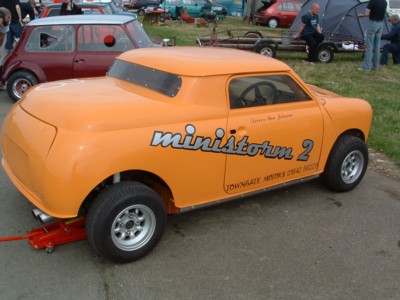

Originally this was one of a pair of engines in 'ministorm2'. Anyone remember it?
I have changed the carb and manifold, which has released a little more power, from my previous runs on SRE's dyno.
Although not as much as vmax scart quote for this engine (184bhp).

well thats good power from that boost, the longer cams do seem to work well in a supercharged lump,
Yep they seems to be the same at NA lumps.. I would have gone up a cam from my 266 if I had known

the dips in the curve may be wheelspin /clutch slip ,id say theres a bucket load more trq to come .
losses at 13 and then 21 seem odd.
nice one for the small boost you run :)
