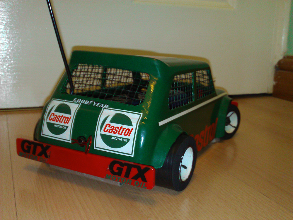

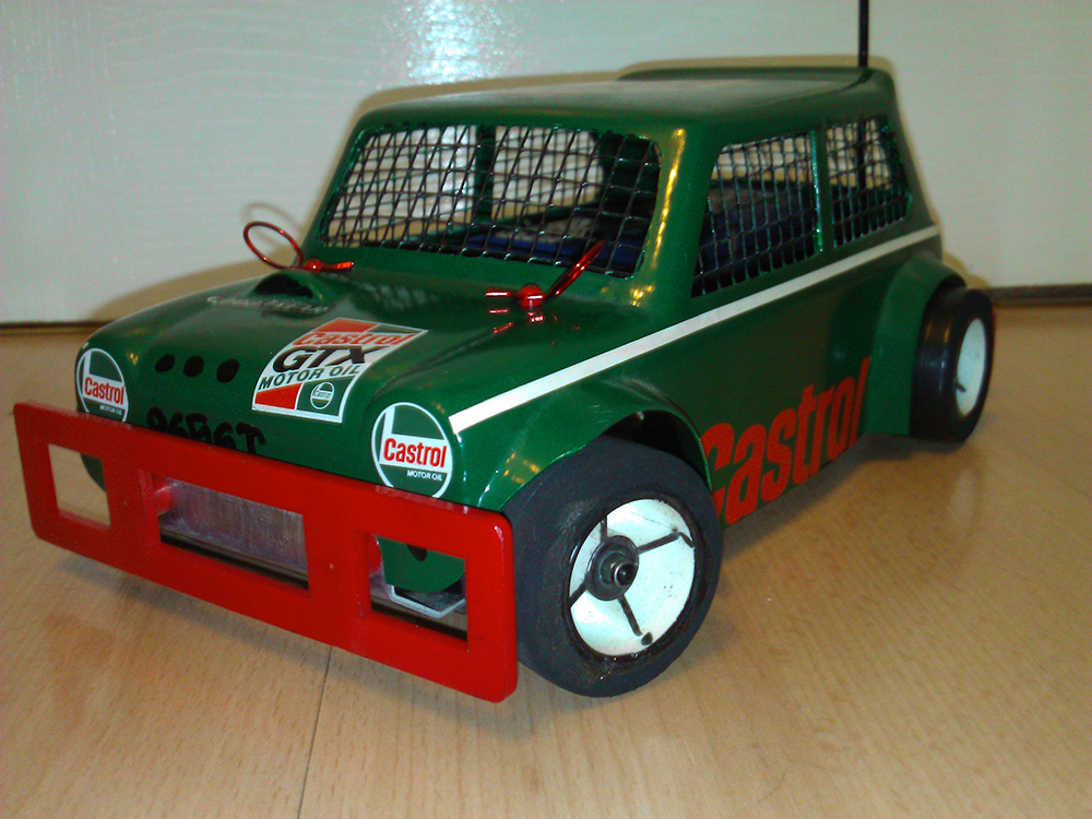

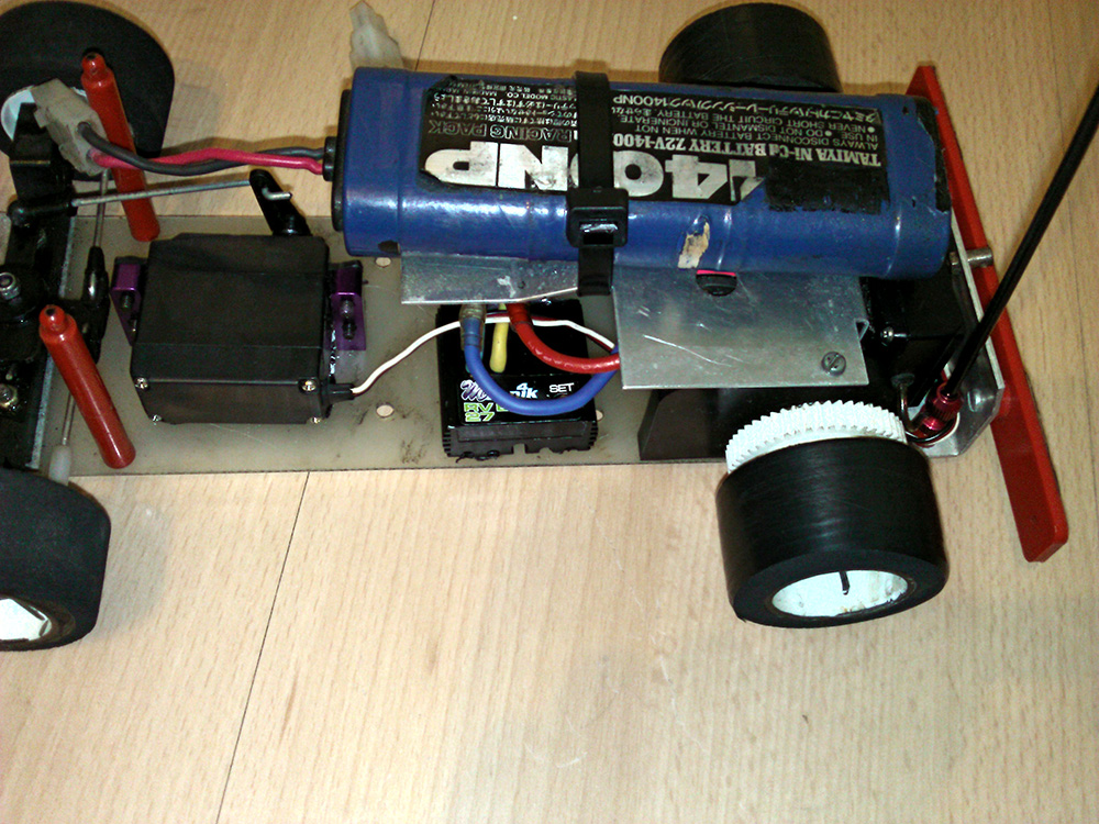

My dad built this, somehow all the radio gear and stuff dissapeared, and handed it to me to never be used again, until today.
Just fitted a new Electronic speed controller, a 'racing' spec motor, battery ive had for ages, and some radio gear.

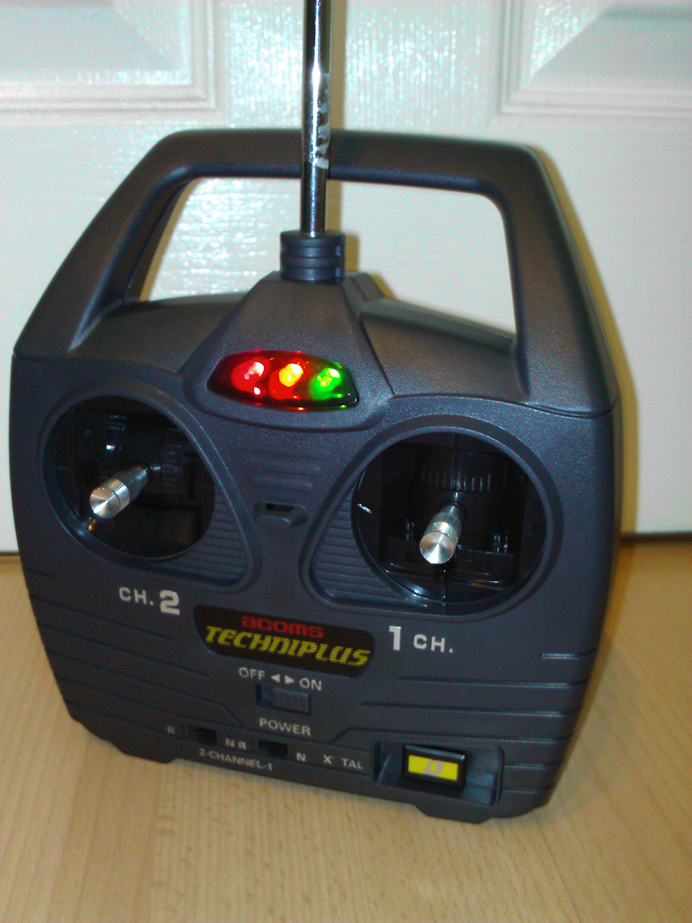

Need a new transmitter cos mine keep cutting out at full forward throttle, bit annoying.
Also need to be careful where i use it, as it has the ground clearance of a gnats cock! *tongue*

I've had one of these for a while gathering dust as it doesn't have any guts! Any idea what Rc gear to get?

You need a transmitter and receiver - 2 channel 27mhz, a pair of crystals, a servo, an electronic speed controller, battery and charger, a motor and some double sided tape or Velcro, must be strong though. And then the part of linkage to connect the steering to the servo, and a servo horn. You may need an additional battery holder for the receiver dependant on what esc you get, i just connected mine to the esc battery wiring, so its simply connect the battery to turn it on.
Oh and you can pick up some Acoms radio gear quite cheap on ebay now, either Acoms or Futaba I've ever used.

Haha, the mini shell is roughly 215mm from wheel centre to wheel centre. Just been out and bought a new transmitter, aerial sleeve and a mount, some R clips and a switch for the radio gear, ill get a finished pic up after :)
Just re uploaded my original pictures.
Never got that switch to fit either, and found out that the speed controller powers the reciever through the signal cable D:
So no need for additional battery power for it :)

The only thing to verify is that the motor in yours is a 7.2V rated RS540 as the older model mardaves used to use 4-cell battery packs (4.8v)

Ahh i replaced the motor dave for a yokomo high torque one *happy*

I now have my one of these sorted! Found a 550 motor going spare in a old car. New esc, 7.2v battery and some cheap radio gear. Goes really well too much throttle and it spins, forgot how much fun Rc cars are!
