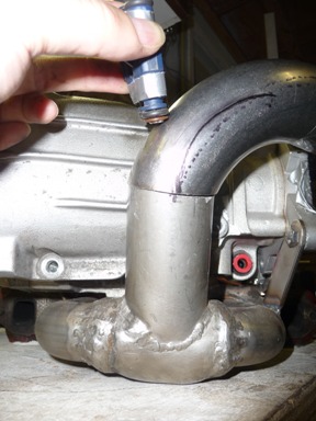

This is how I plan to position them:
The angle and height are a bit of a guess; the info I can find on the web mainly covers positioning of injectors for port injection. For wet manifold I saw some at 45 degrees so followed that.

I had another look and what I could do is position the injectors at the outside corner of the 90 degr curve.
Like so:
This would mean I would have to reduce to vertical bit which I was hoping to avoid because I fear that the 90 degree turn close to the 'T-split' would also result a favouring one port..
Maybe re-shaping to 2x 45 degree and creating a divider will be helpful.

With a wet manifold of sufficient volume, with enough squirts per cycle, and the injectors more than 6 inches from the ports it doesn't make a significant difference where you stick the injectors in relation to the ports. Mine has 4 smaller injectors in two banks at one end of a wet manifold and I see no AFR difference between inner and outer cylinders or either port.
You suggested positioning on the bend looks great, you can even get 2 injectors side by side like mine of you have 2" pipe.

(Actually there are 2 injectors side by side in that picture.. )
