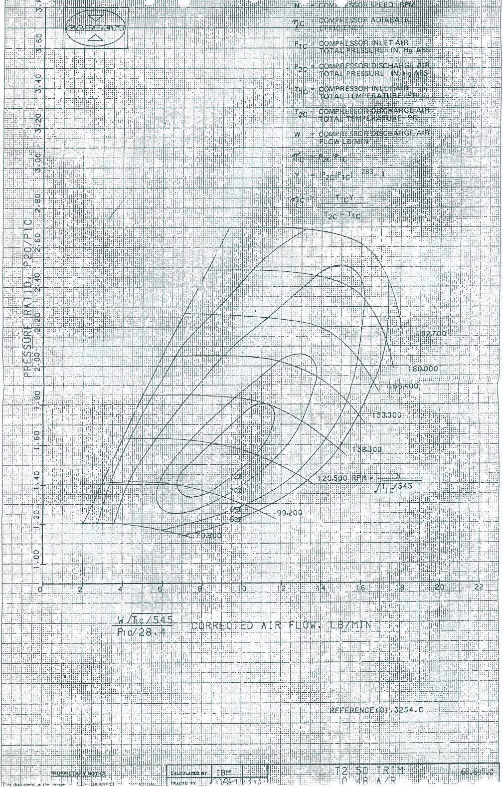

Does anybody know the spec of the standard T2 for a R5 Turbo. I just trying to compare different turbo spec's but cant find out all the information. I need info on Housing sizes, wheel and trim sizes etc.
I had one rebuilt serveral months ago, but Ive never collected it, im thinking about asking them to fit a bigger T25 - 55 comp wheel and a bored out 0.48 Housing.
There is a comp map kicking around somewhere. iirc, it very similar to the GT1548, but slightly less efficient.
www.twin-turbo.co.uk
Map attached
Compr Trim 49
A/R 0.48
Inducer Dia 35
Turbine Trim 58
A/R 0.35
Exducer Dia 36
As Wil said, dimensionally as the GT1548.

paul s could you please pm the biggest copy of the comp map you have :)
That's it mate.
