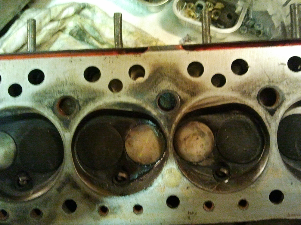

I've pulled the head off this evening and there's signs of leakage between 2/3 and the waterways. The gasket doesn't appear to have failed (and it was torqued down correctly) so I'm going to clean things up and rebuild with a new gasket.
I'm wondering if the 'smoke' was water based (it was more on the white side of grey) caused by this failure - anyone had anything similar?

Pic of head (the ones of the block were too indistinct). You can see the area where I think the leakage is between 2/3 and the waterway - its got almost a 'wave' pattern.
What gasket were you using?
I guess it culd have been suckig water in on over run. But if it was doing that then it would have been compressing the water system on boost.
White smoke from a turbo can be worn turbo seals. Is there any oil in the pipes from the turbo to carb?
I'm using a BK450
Thats what I thought too - but i guess if it was doing that It would also increase the water sucked in on over run too. Would have thought there would have been more of a tell-tale of it pressurising the water system when on boost though.
Pipes are clean - was the first thing I checked.
Should have it back together tomorrow/Thursday (work permitting) so I guess I'll find out then - fingers crossed everything will be OK. I'm well and truly bitten with the turbo A-series bug after the few laps I did at Llandow last Friday and I'm looking forward to getting back into competition after 2 years off!
