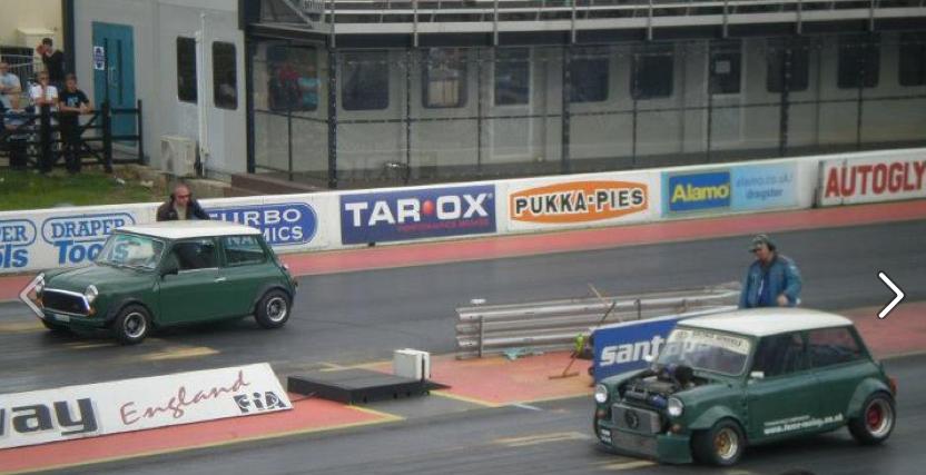

well since being placed up against the "DON" at MITP and getting shown how its done, i've decided to bite the bullet and join the forced induction revolution and build a turbo mini *happy*
mini has also been featured in MiniWorld this month which is great but the N/A has to go and be placed in a little corner of the garage just incase and a turbo fitted. not looking for all out power as dont want to cut the bulk head so looking at mirage manifold and T2. will be happy with 150 bhp.
currently have a complete SPI engine and box all stripped and ready to be rebuilt. so on the look out for various bits and bobs over the winter period and going to set a goal of MITP 2013 to be built and in the mini.
